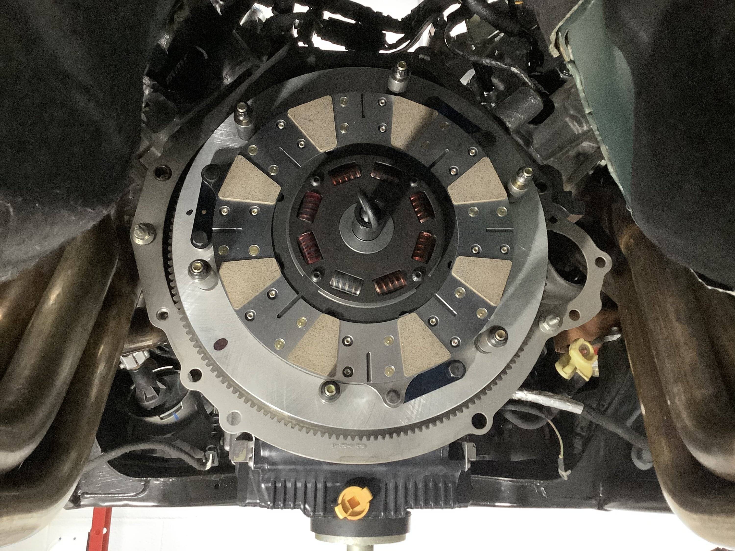

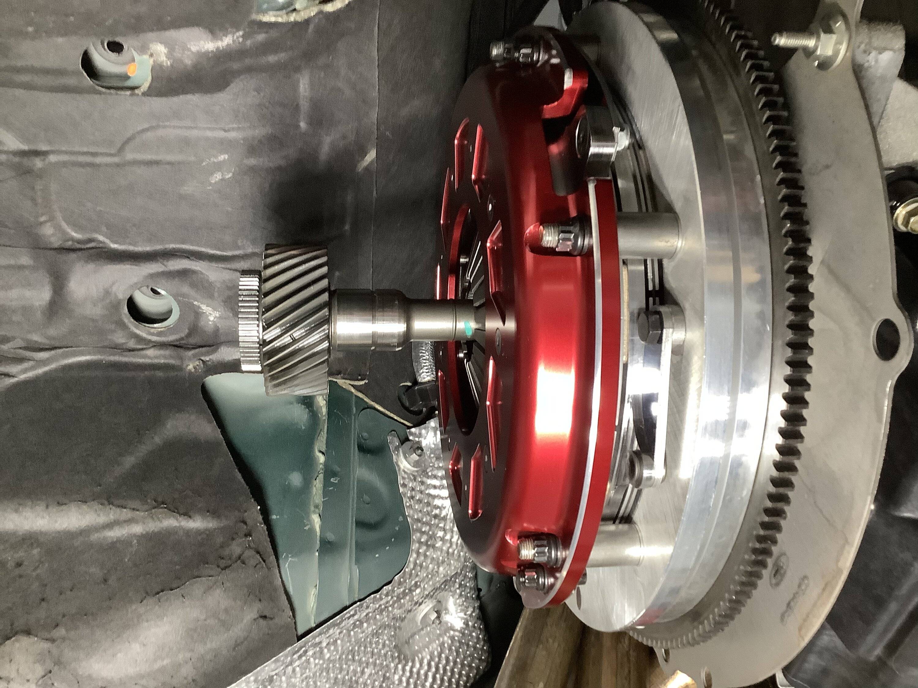

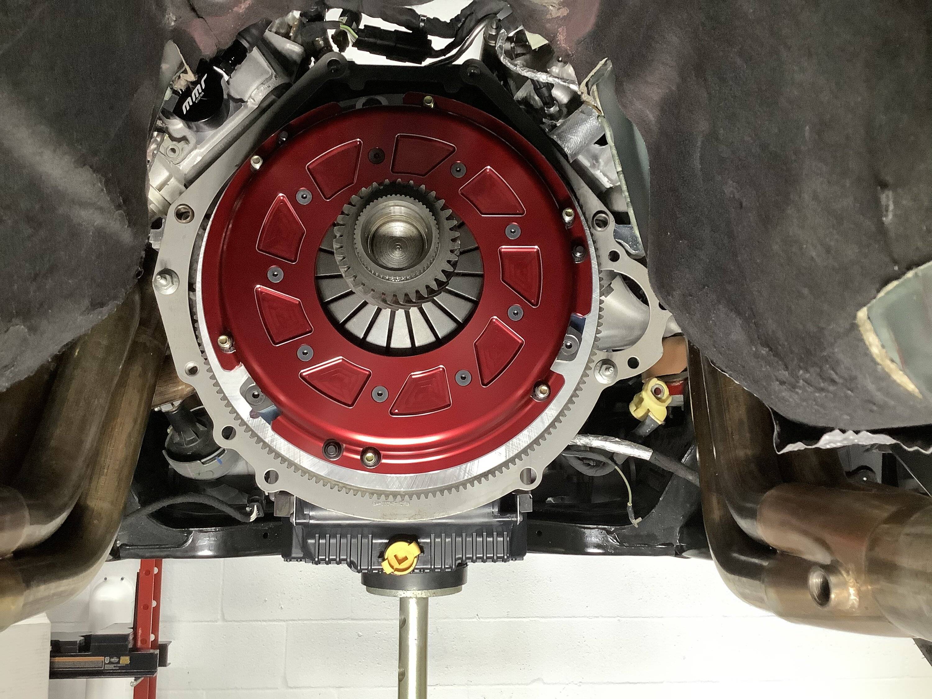

That doesn't sound right at all. When I was referring to my aftermarket clutch shuddering, it’s nothing like what you’re experiencing. The best way to describe mine is, the clutch slightly pulses like it’s grabbing and releasing quickly, but if I am very careful releasing the clutch, it doesn‘t do it at all. I can’t hear it outside the car like you can on yours.
The factory Bullitt clutch looks weak compared to my aftermarket clutch.
