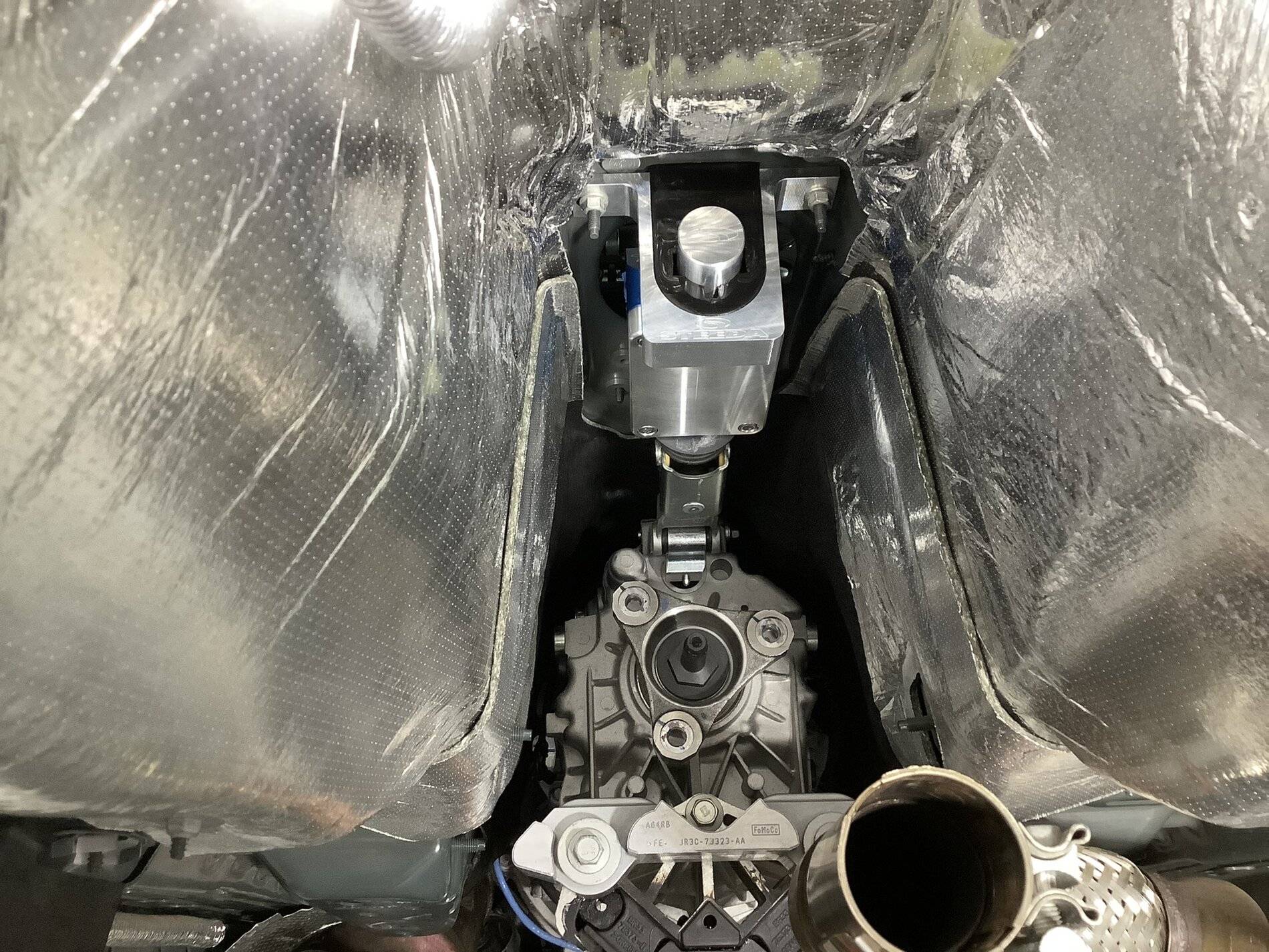

This may be way off base, but could this noise possibly be caused by the shifter support bracket being loose and moving around (grinding against the transmission tunnel) during shifts?

Interesting - would it make a difference that I can _feel_ this more in the clutch vs in the stick? It's a distinct grinding feeling in the clutch as it is let out.
I’m not sure, but was just wondering if this could be a possibility, as the engine/transmission will move around to some degree with the mushy stock motor mounts and transmission crossmember bushing, unless perhaps stiffer motor mounts, a shifter bracket and the polyurethane trans insert are installed to help lessen most of the movement.

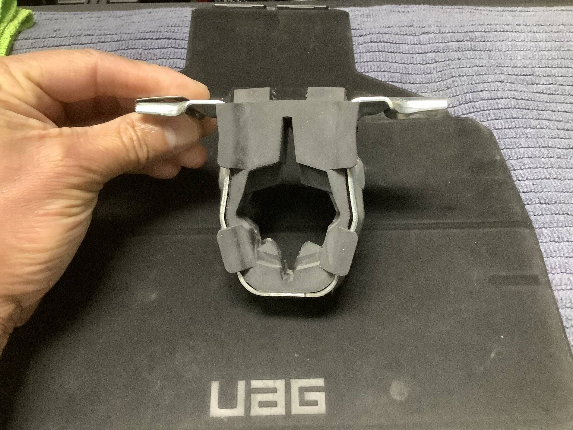

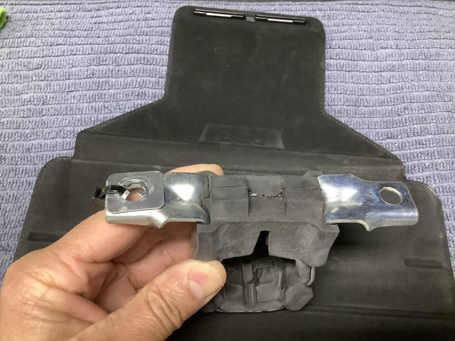

I can say that the factory shifter support bracket and rubber bushing are super flimsy compared to the billet one in my previous pic. Have a look here at the stock bracket snd bushing. Maybe upon release of the clutch the movement could be causing the brief grinding sound.
I’m not saying this is the case with you, but as for me, I’m always listening to and feeling for abnormal sounds and vibrations when I’m in my car, especially after a modification. Sometimes I’ve gotten tunnel vision and only picked up on half of a problem because I may have been focused on a specific noise more so than a vibration too. The more I listen, feel and evaluate things, the clearer the picture becomes to me.
