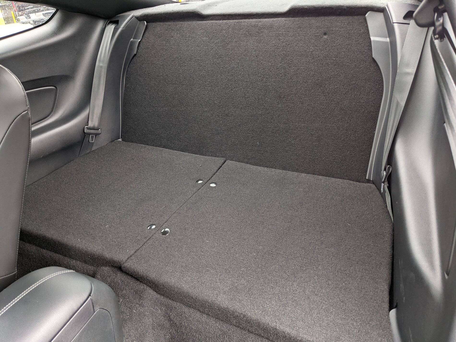

From LMR in Waco, TX Their p/n RSD 1516. It can be mounted so that the vertical section can be lowered. I needed this so I can take my service dog.

Mike, can you still fold the back down easily?
Also does it let more cabin noise in from exhaust?

It can be lowered. However, the vertical panel is not hinged. It is held in place by two large plastic push pins similar to the ones used on the hood liner. One can see the indents in the picture. I chose the mounting shown in the picture because I would never lower it. Conversely, one could purchase two button head SAE coarse threaded bolts, flat washers, jam nuts and, wing nuts to replace the plastic push pins. Run the bolts from the inside of the trunk into the passenger compartment. Flat washer, jam nut the bolts to the metal bulkhead. Place the panel over the bolts. Flat washers and wing nuts to hold the vertical panel to the protruding bolts. Necessity is the mother of invention ....... :rockon: šŸ˜†

Thanks Mike,
may not be best for me then as I put down the seat a lot when I mountain bike.
Also I throw my dog in the trunk and only put one side down for him to crawl through.
So how big is your dog, I'm seriously looking for a rear seat delete kit for my 95lb. Black Lab. This looks like it would be almost perfect.
