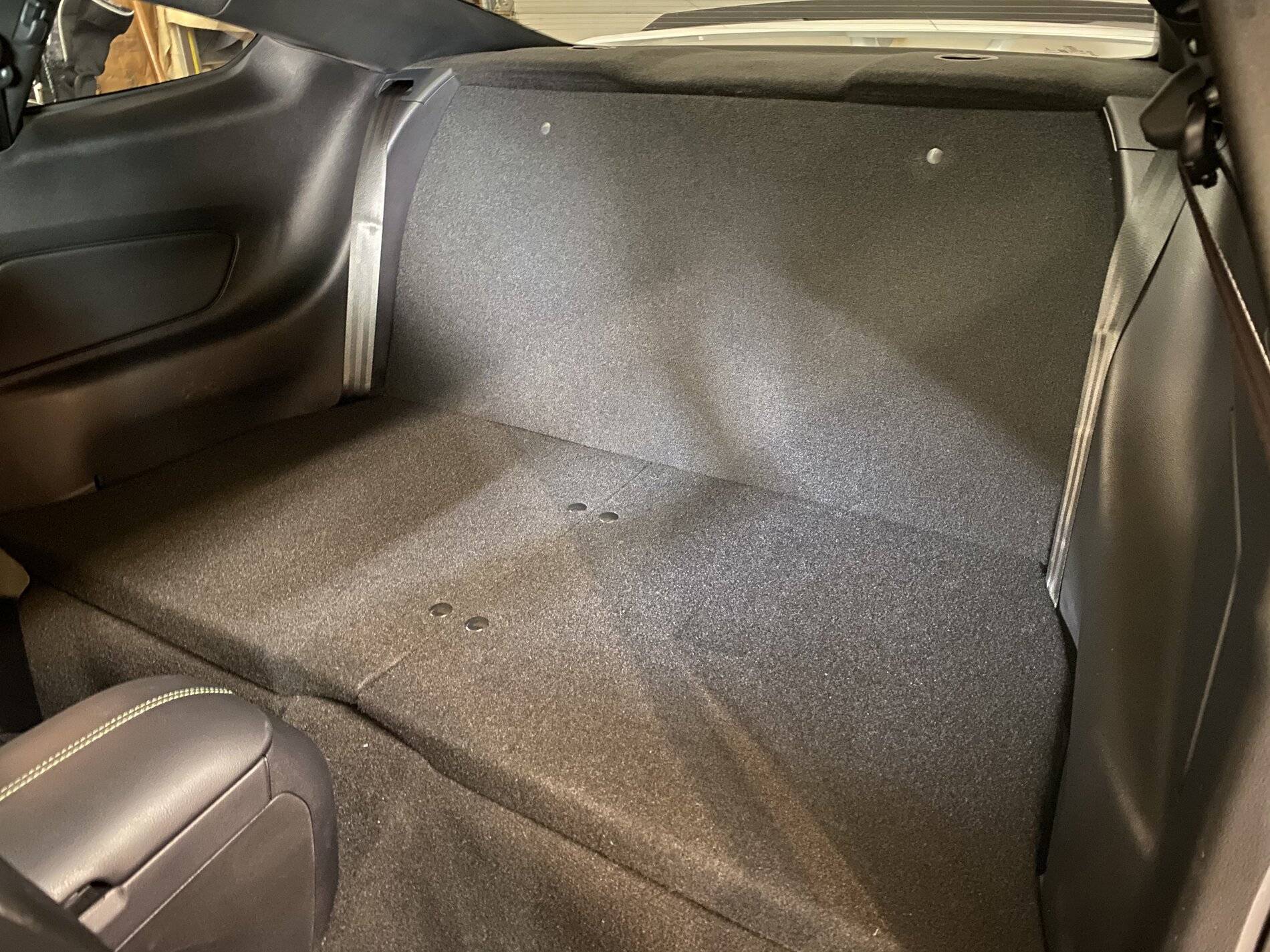

Here is my '21 Mach 1 Handling Pack with the rear seat delete option. According to the order files, to get the Rear Seat delete you had to check the box for the Handling Pack first. It's not available on the standard Mach 1 in either 600A, 700A or FJG Appearance Pack.
Can you share your VIN (pm would be fine too)? I'd like to compare your AB data to a similar HP Mach1 that does not have the RSD.

I like mine. Left the belts as I didn’t wanna cut any plastic
What plastic would you have to cut? I think the FR kit comes with replacement pieces for where the belt comes out at the top. I’ve seen a part number for it at least when trying to piece this kit together before I realized it was sold as a kit. Wouldn’t you be able to uninstall belts and everything without cutting?

So where the belts go into the top. That plastic part pops out but the only way to slip the belt out of that piece is to just put a slice in the plastic.

What kit is this, it looks way better without the butt indents, makes for a proper back shelf.
If there was a fix for the warning light, couldn’t you remove the belts entirely with that plastic piece still attached to the belt? Pull it all out at once and avoid any cuts?
Don’t believe there is any type of warning light for rears at all. So you could remove it all completely if ya wanted
For MY21 Ford added rear sensors for airbags and seatbelts. Confirmed on another post were a guy with a Mach 1 was removing his rear seats and found new harnesses connecting to the seat belts mounted to the floor.
