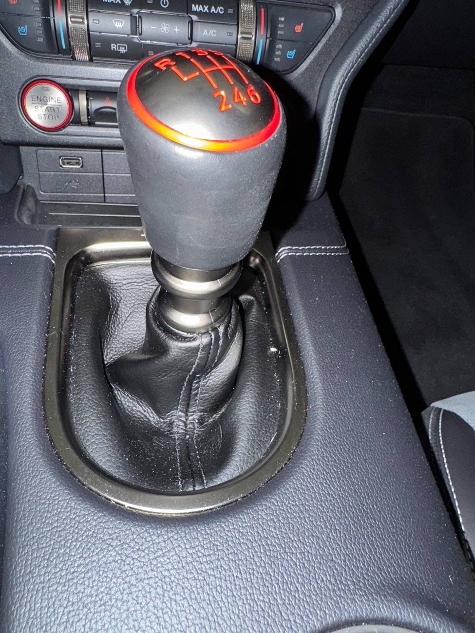

I’m replacing the shift knob and I have one of the hard ones. I’m using a strap wrench and got it to move 6-8*. Can’t get any further than that.
What concerns me (and maybe it shouldn’t) is that the boot is twisting with it. Because of that, the reverse shift lock collar will not move either.
I have “some” idea of what a shifter assy looks like internally, having done them on my GT’s in the past. But the ball should be independent of the collar and boot. Which seems like it must be rotating the whole shifter.??? Still goes in the gates fine for all forward gears. Any ideas as to why it’s doing that and am I hurting something?

I’ve kept pushing forward and finally destroyed the knob while only getting another 5-6*. But the more I turn the knob the more the boot twists with it.

You might have an issue now because the boot should be unaffected. Are you also replacing the shifter? If so, pull up the whole boot and carry on.
If not, you should stop the reverse detent from turning. You don't want to break the plastic inside.
I agree 100%. As you can see in the picture, all I had done was rotate the shift knob with the strap wrench. The boot just went with it from the start. I don’t understand why.

When I was installing my MGW shifter, removing the knob was awful. I worked it bit by bit. I had to keep escalating. Finally the fabric on the knob gave way. Ended up using a pipe wrench. After getting the knob off, I found that the reverse detent was broken. So, that is where my warning about additional damage comes from.
Whatever had been done at the factory was excessive and over the top.

So how did the reverse detent damaged? Is it because it’s rotating the whole shifter handle?
