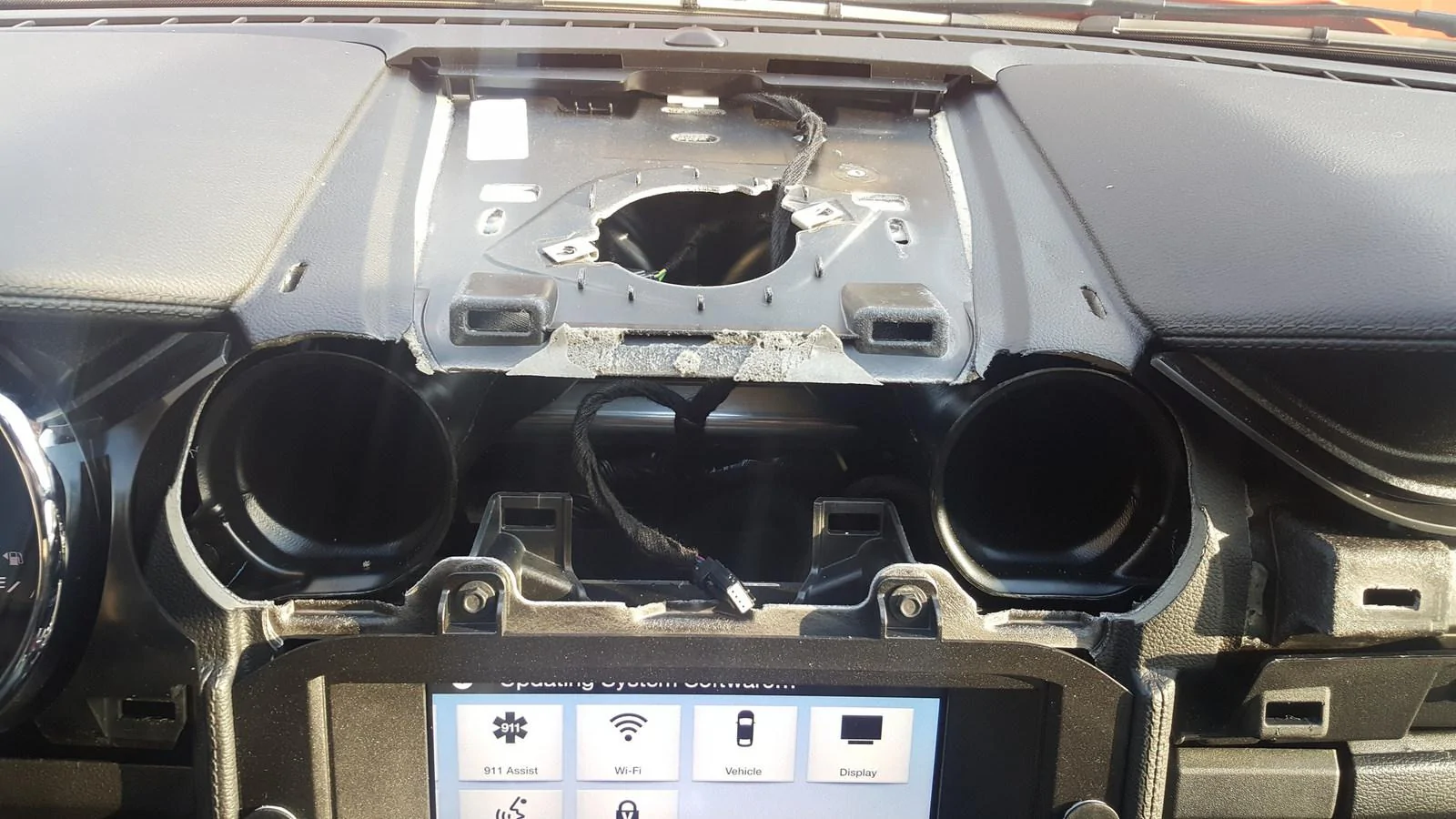

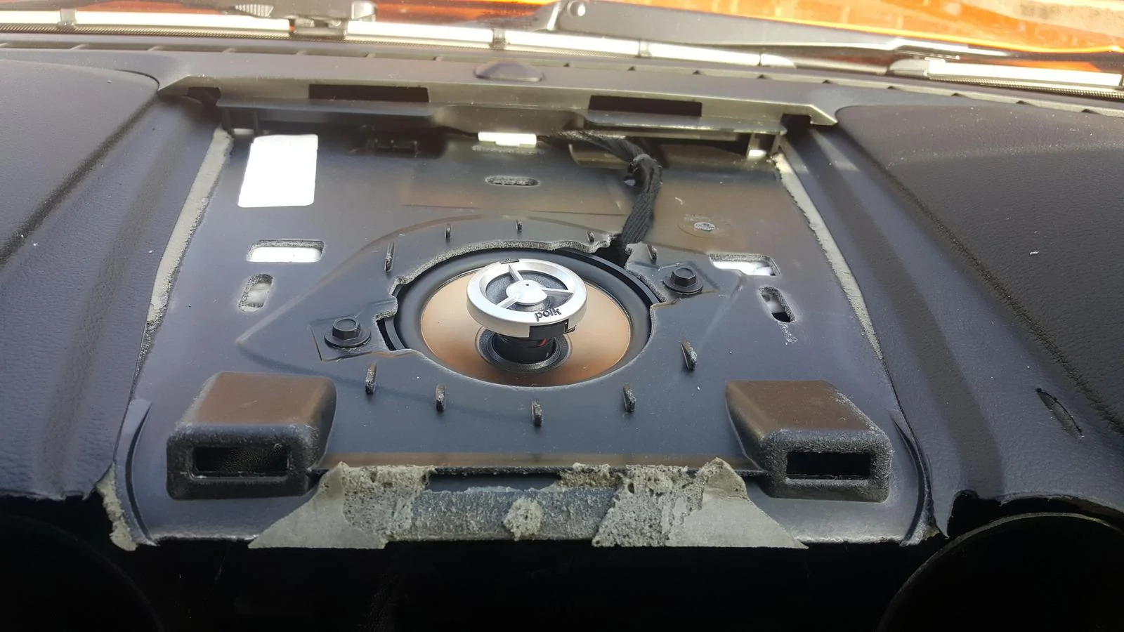

Polk db351 worked very well for me.
It cleaned up that muddy sound from the factory speaker.
It is also a higher ohm rating, which makes it lower in volume as well. (Better sound stage)
20161216_114942 by chefjpd, on Flickr
I have the PP gauges, so no center air vent, I was able to mount it under the panel. If you have the vent, you just have to clearance the cover a bit. Very easy.
Also, you have to remove the facia to get the cover off.
