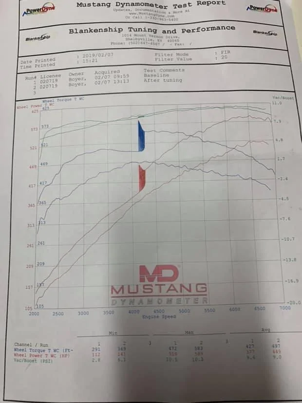

Any dyno or 1/4 mile numbers on your setup?
Jobodizo
May 16, 2016
68
621
210
Kentucky
2015 DIB GT
583/557 wheel on a very conservative dyno tune with 80mm stock throttle body, 47lb injectors and no BAP at 10.5 psi. The other run is the Edelbrock tune, which was 514/472 wheel with everything else equal. Don't run my car, so no run numbers for ya, sorry. As you can see, the torque is more than enough to make the stock clutch cry.
