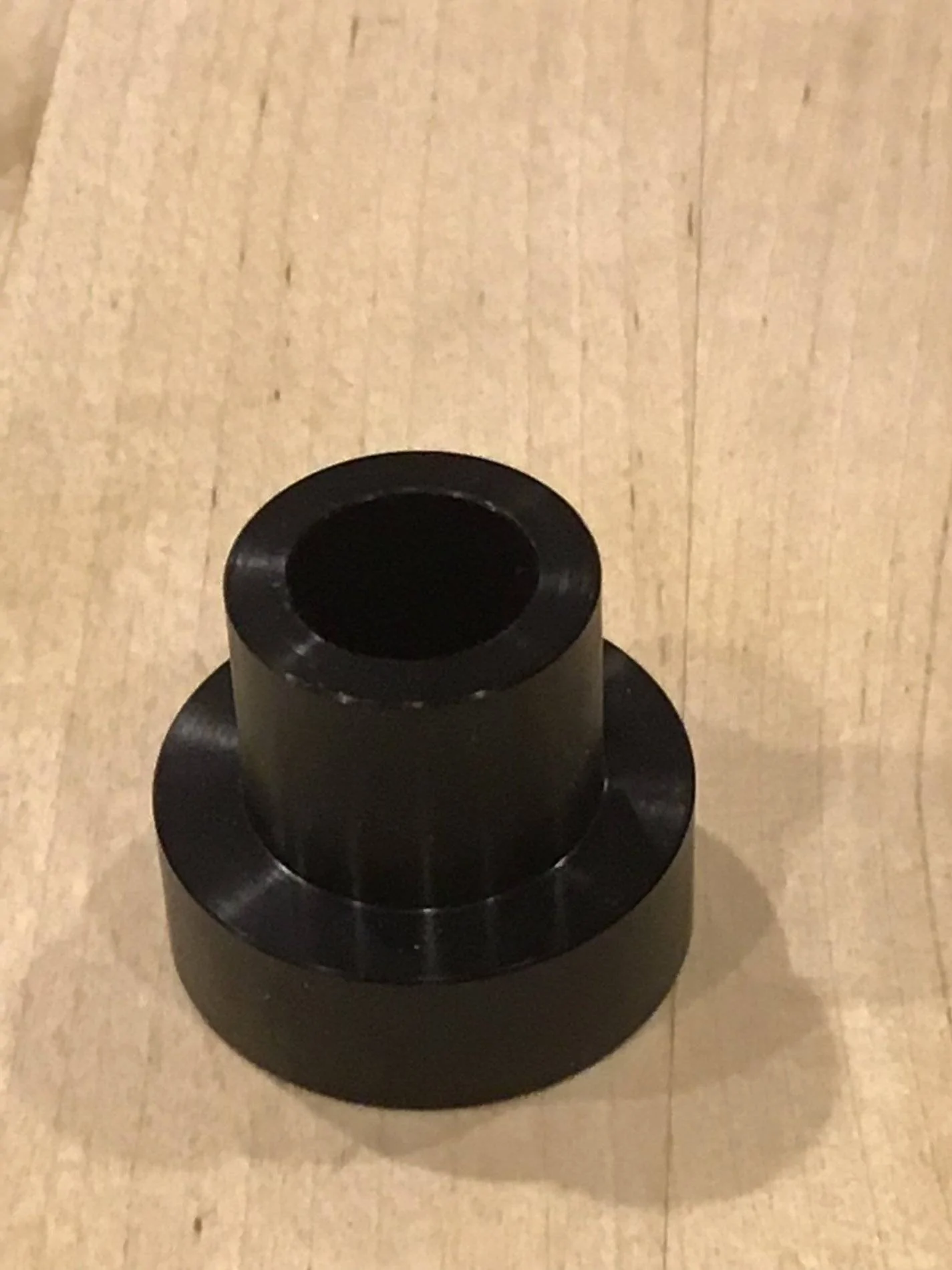

I had this exact same issue . The problem with mine was the kit was missing one idler spacer . The shop that installed mine made a spacer to get me my car back . The problem ,the shop made spacer held the idler out to far and caused the belt to come off the back of the idler then walk one cog off on the tensioner pulley . The exact same problem you describe . The cure , called Edelbrock received the missing spacer replaced the shop created one and all has been good .

Can you show or explain which one I'd like to double check the 2 different techs and 5k in labor I've paid to see if they are all right haha.....

In your picture the silver colored idler right before the tensioner . Remove the belt then take out the Allen head bolt that holds that idler on and see what spacer/ boss is behind it should look like this one.

Thanks so much for supplying this I will be changing from the griptec to Edelbrock pulley and new belt soon I WILL check this and report if that was my variable as well...
