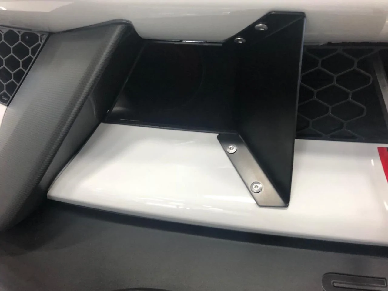

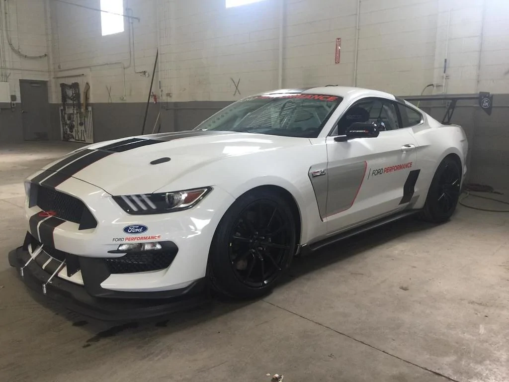

First FP350S I've seen delivered. Note the diverter plates they rivet to the fascia to direct airflow into the brake cooling ducts. I didn't see these at Capaldi's site...
