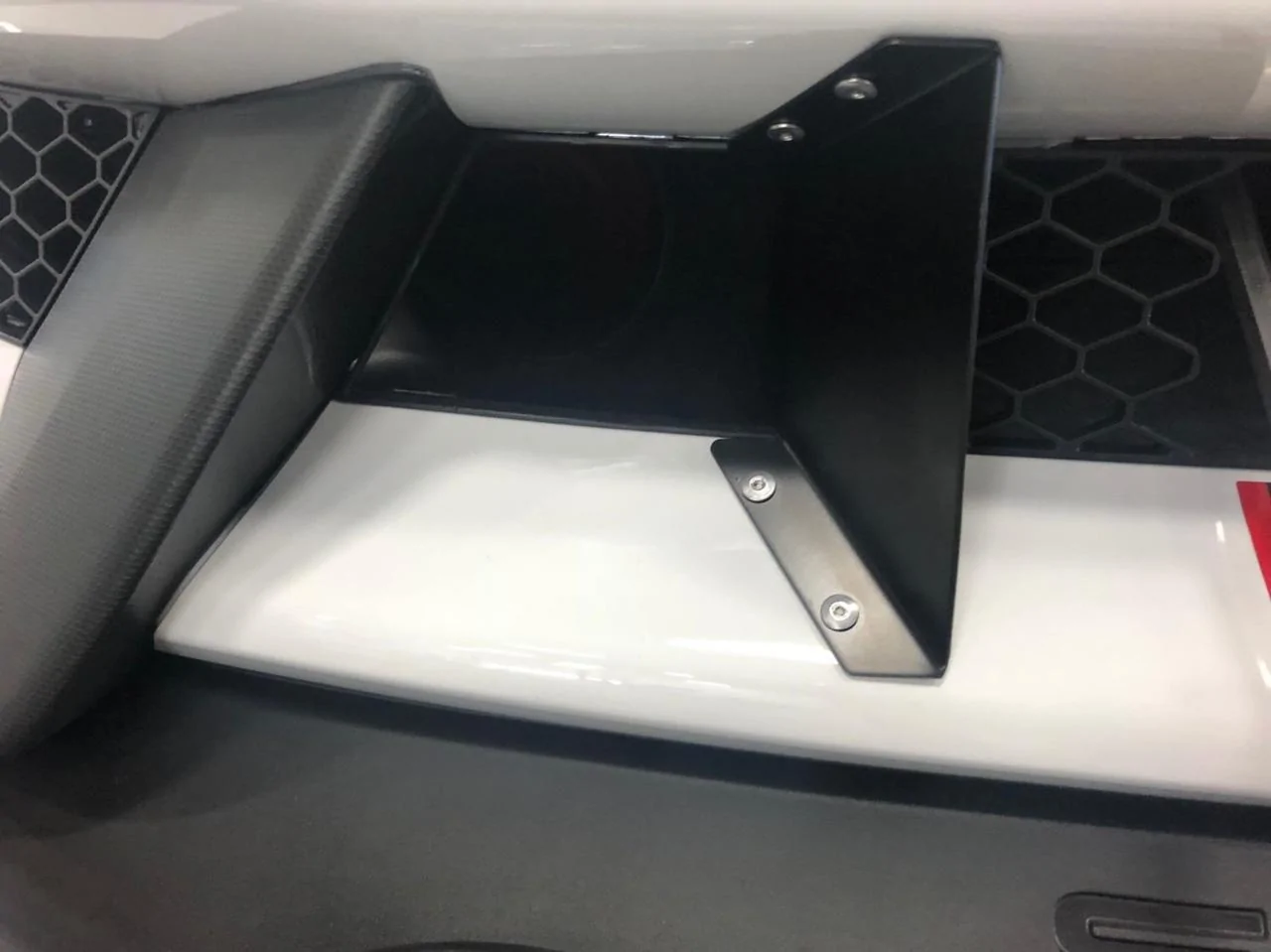

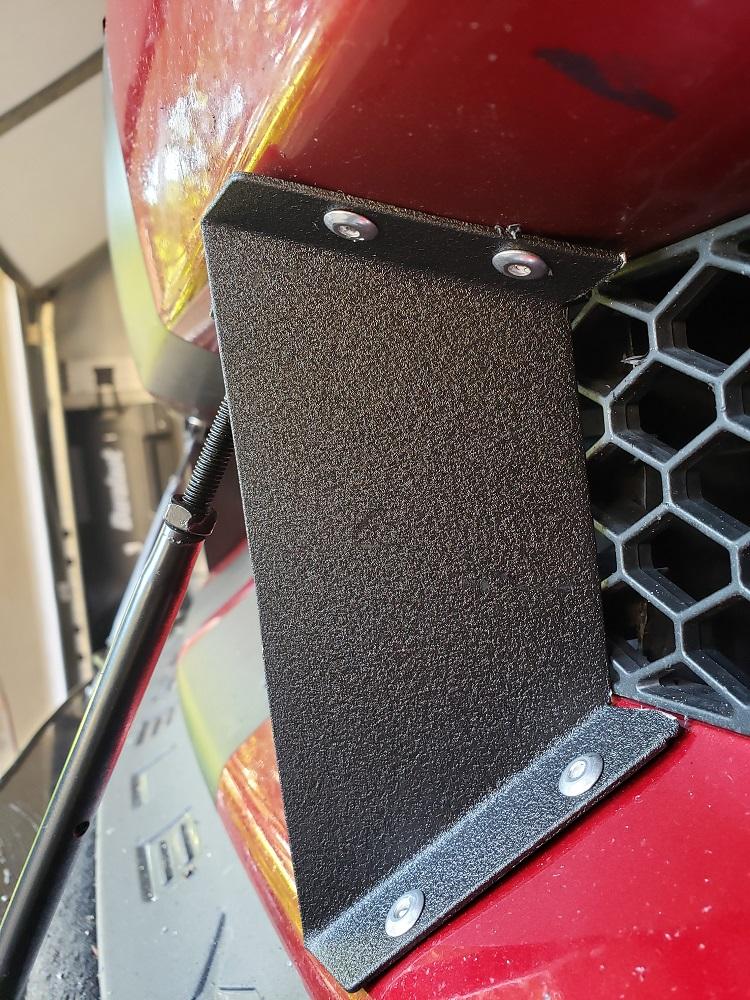

First FP350S I've seen delivered. Note the diverter plates they rivet to the fascia to direct airflow into the brake cooling ducts. I didn't see these at Capaldi's site...
Good eyes!

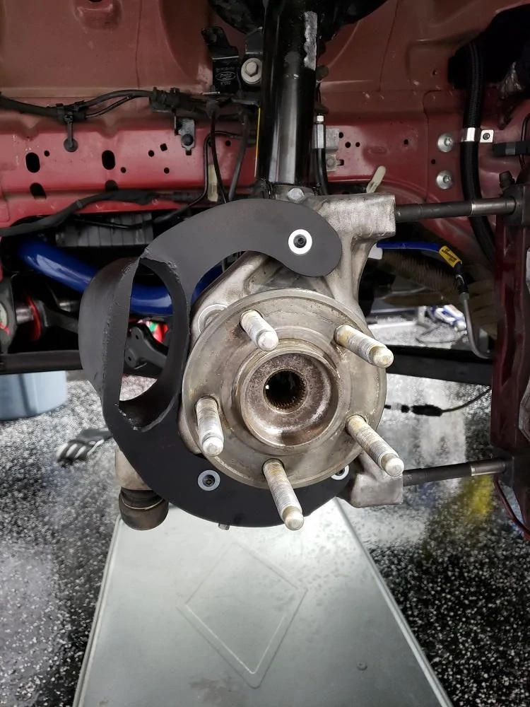

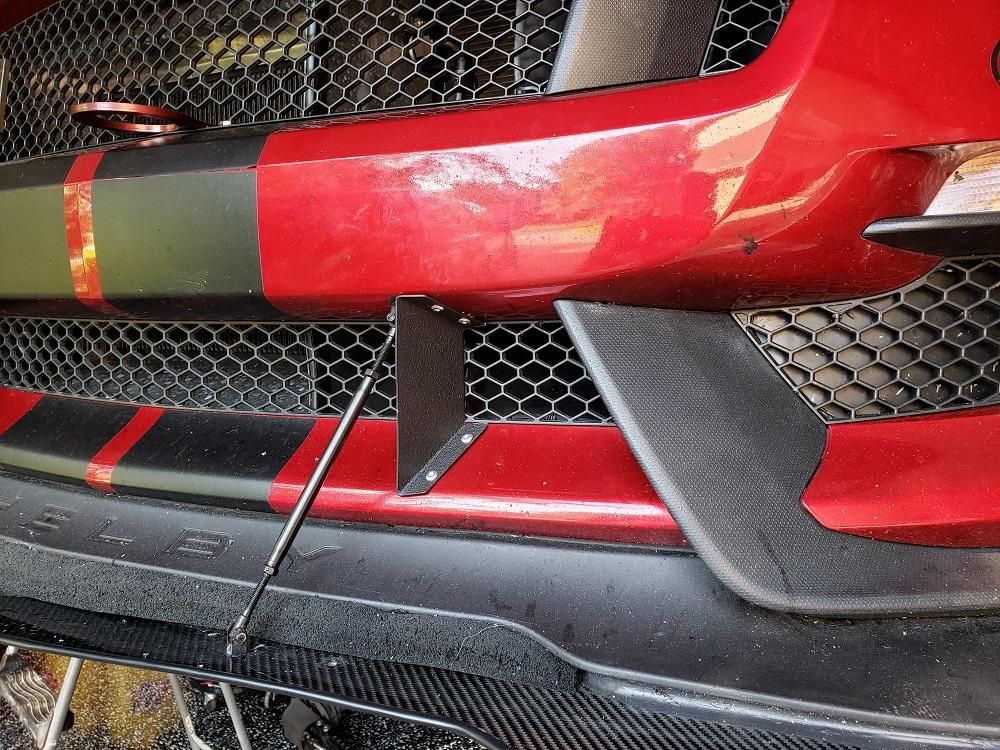

Got my hands on some brake duct deflectors. I'd recommend fabricating your own vs buying these (fitment is terrible), but I was lazy and so over fabricating. Between these and the ducts, we should be ready for COTA on the braking front. Hopefully no more surprises going into turn 1.

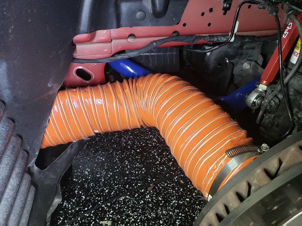

4in hose connected to the OEM duct leading to back of the hub
Not my best work by far, but not bad for some using all the wrong tools and having no welding experience. At leas that's what I keep telling myself.

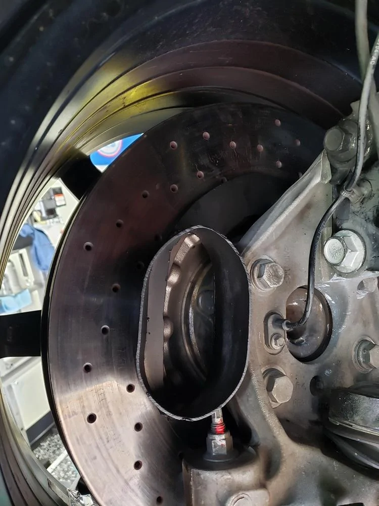

Back of hub. I didn't remove all the metal so that I am not blowing air onto the back surface of the rotor. We want all of it to go into the inside of the rotor and then through the veins.
If all works out, I'll make some modifications and then talk to a proper welder about getting kits made if there is interest.

I like what I see. Ingenuity with the duct you fabricated and some absolutely superb caliper studs and sleeves. All of it, pure genius.

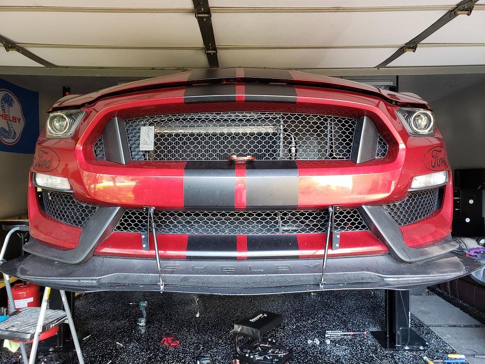

You don't have much of an angle on those ducts on the front to the intake. They look almost straight, so how will that help direct much more airflow? On the race car, you see its much more angled than what you did and will force a high pressure area right to the intake located behind the grill. (I'm just being a geek engineer.....). But I'm a EE, not a aero guy.....so I might be a bit wrong...
That Caliperfexion guy sure knows what he is doing :D
It's got more angle that the images show, but is a bit less than the race car due to my support rods. They've been installed for about a year, so had to work around them. When I ever upgrade the front splitter, I plan to get a new bumper cover. I'll do a proper install then. In the meantime, wanted to improve brake ducting for this summer. It's all a process :)

Getting caught up with your build now honeybadger . .. looks fantastic. I don't like the metal fin idea. I would rather make the fins out of Kydex or ABS in case they got damaged from track debris (exactly what a bunch of us did on the Focus ST forums, which worked great).
Dedicated ducting to the inside of the bell and vanes is the best way to go. Your upright mount looks awesome, definitely count me in for a set!
