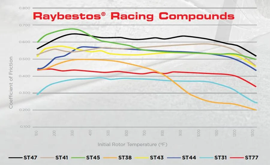

Any reason for choosing the ST43 over the ST47 or ST45? According to the Raybestos compound sheet below, this is what they say about the ST47:
"If you are looking for the most advanced performing road race brake pad, that will simply out perform all the rest, this is it."
Sounds like the winner to me. ;) Note that all Raybestos compounds look to cost the same for our cars so price should is not a deciding factor.
https://www.porterfield-brakes.com/images/raycomp2008_11_06_03_19_04.pdf
Have run both ST47 and ST43 on my GT500. They both wear exceptionally well and both treat rotors amazingly well (much better than PFCs in fact). Like CSL said, ST43 has smoother engagement, which leads to easier modulation. ST47 has absolutely incredible bite, but also great modulation for me, easier to modulate than any of the PFCs I've tried or the DSUNO. ST47 has a rock solid pedal feel, better than any pad I've tried. At least that's how it felt in a 2 ton pig.

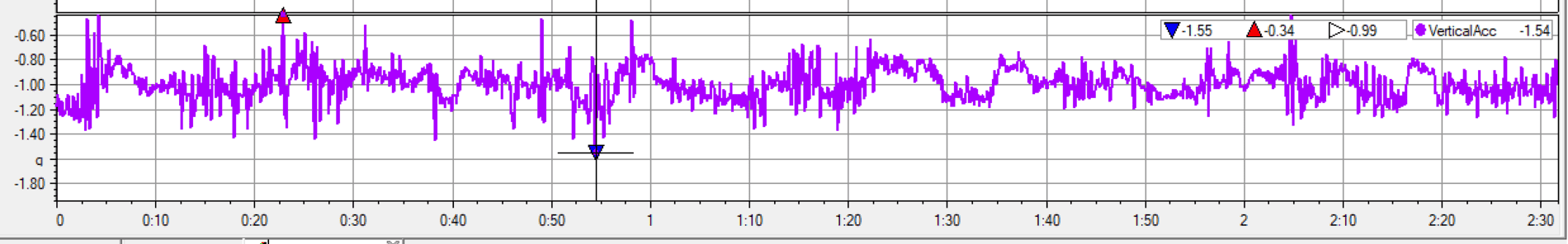

Had the chance to really put the new ducts to work at COTA this weekend. All I can say is holy s***. I'll let the data do the talking:
Yep. That's right. 1.54g braking. I never got above 1.3 before - even using my aggressive G-Loc pads. These were on my Raybestos ST43s which are a fairly mellow endurance pad. They have good bite - I'd say similar to OEM. The ~1.5g was repeated for multiple laps at multiple turns, so not a fluke in the data.

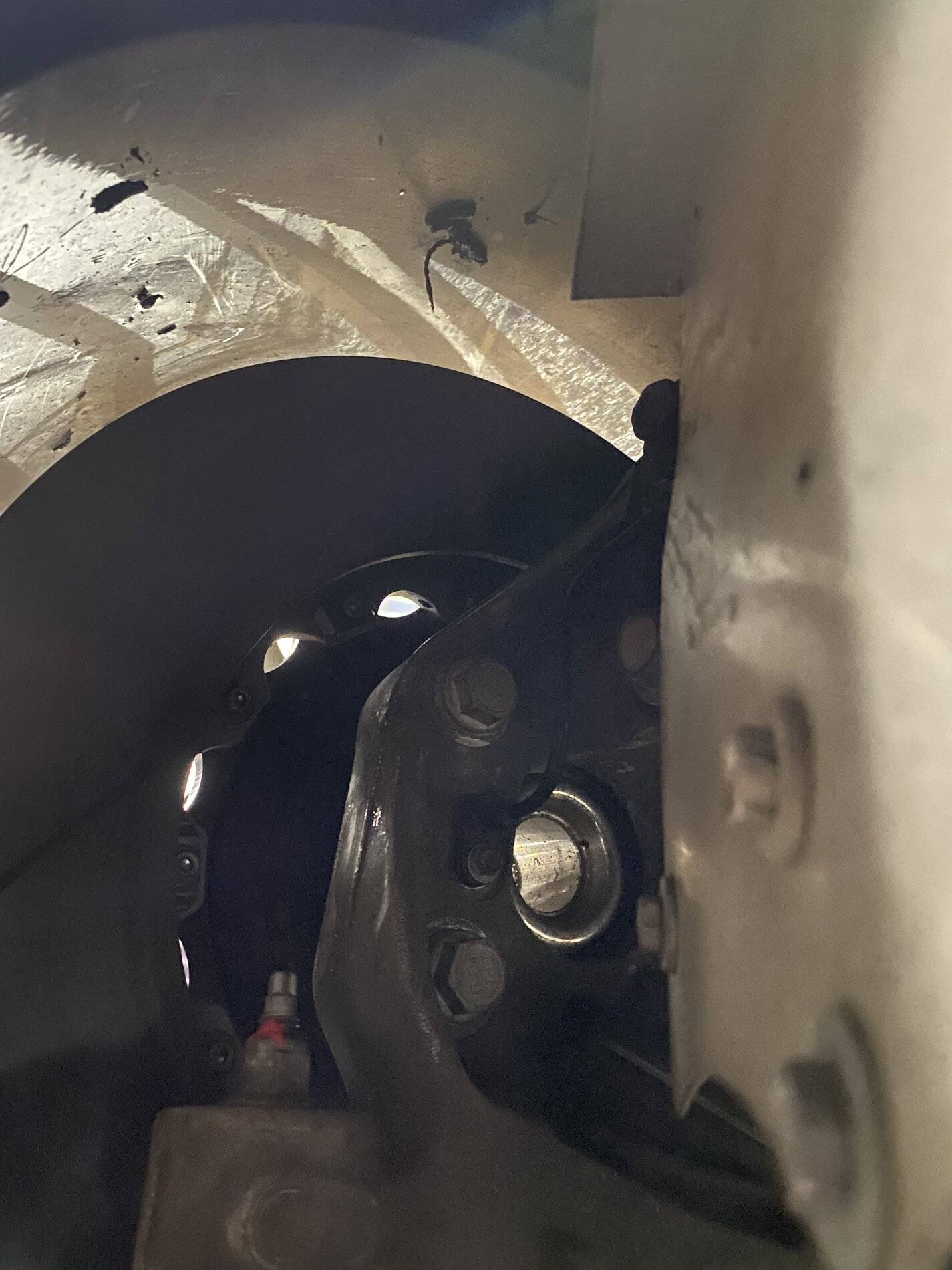

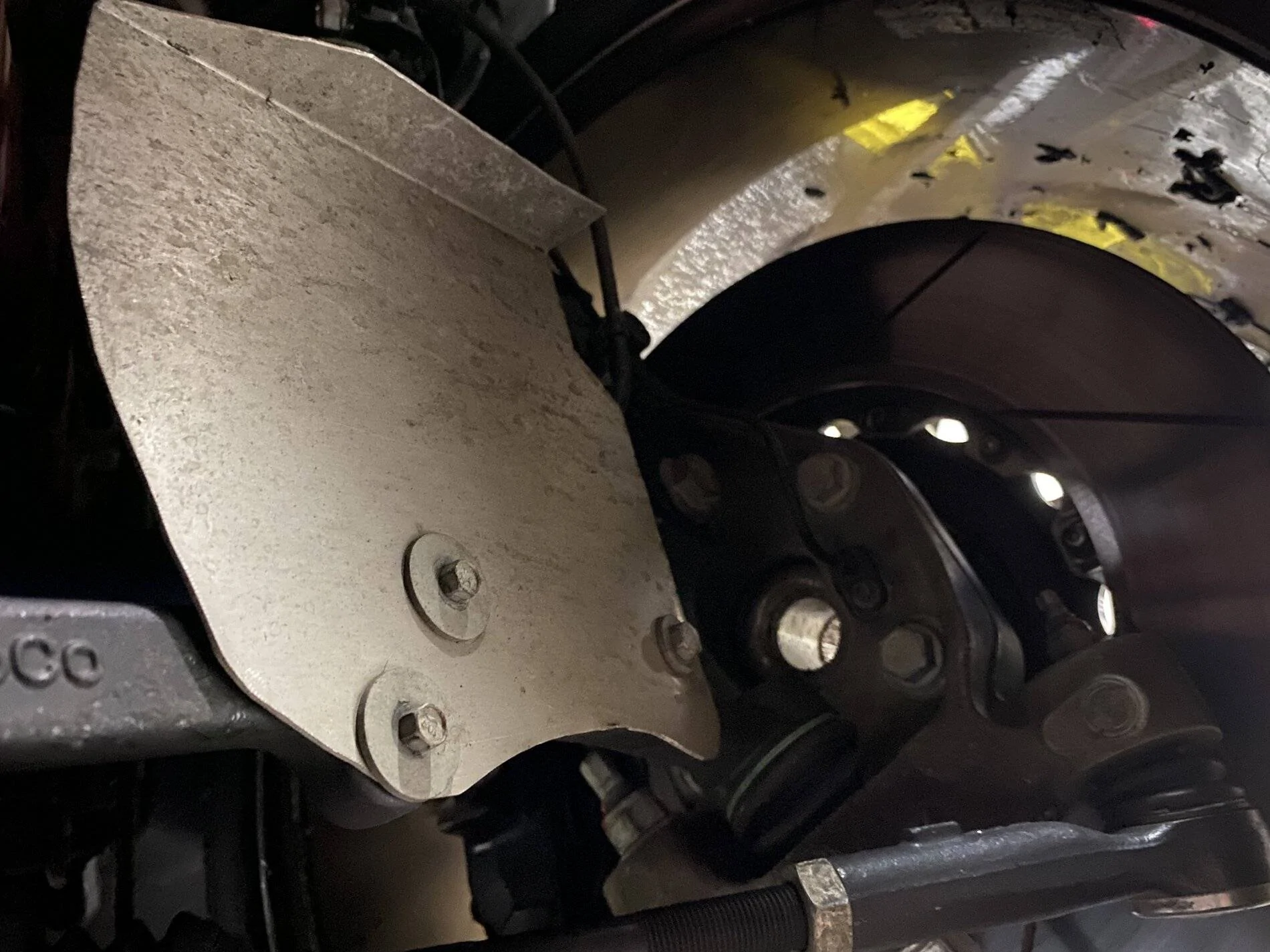

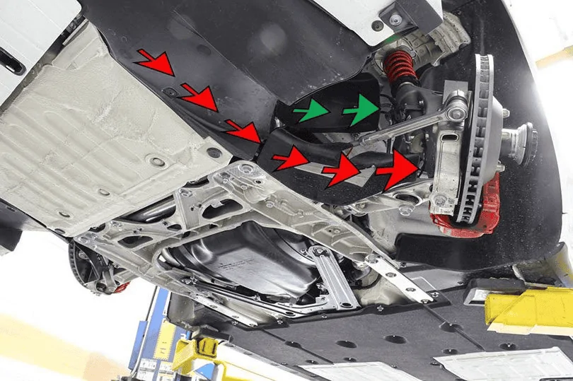

So bringing this one back from the dead. Was watching my man Jackie Ding and they showed some of the brake deflector/ducting on a 991.2 GT3. This got me thinking about my own deflectors. Here's the part that intrigued me:
So went to dig up some pics on the internet and found this:
So the upper one (green arrows) is the one predominantly shooting into the "eye" of the rotor. The red arrows more aims at the bottom of the rotor.

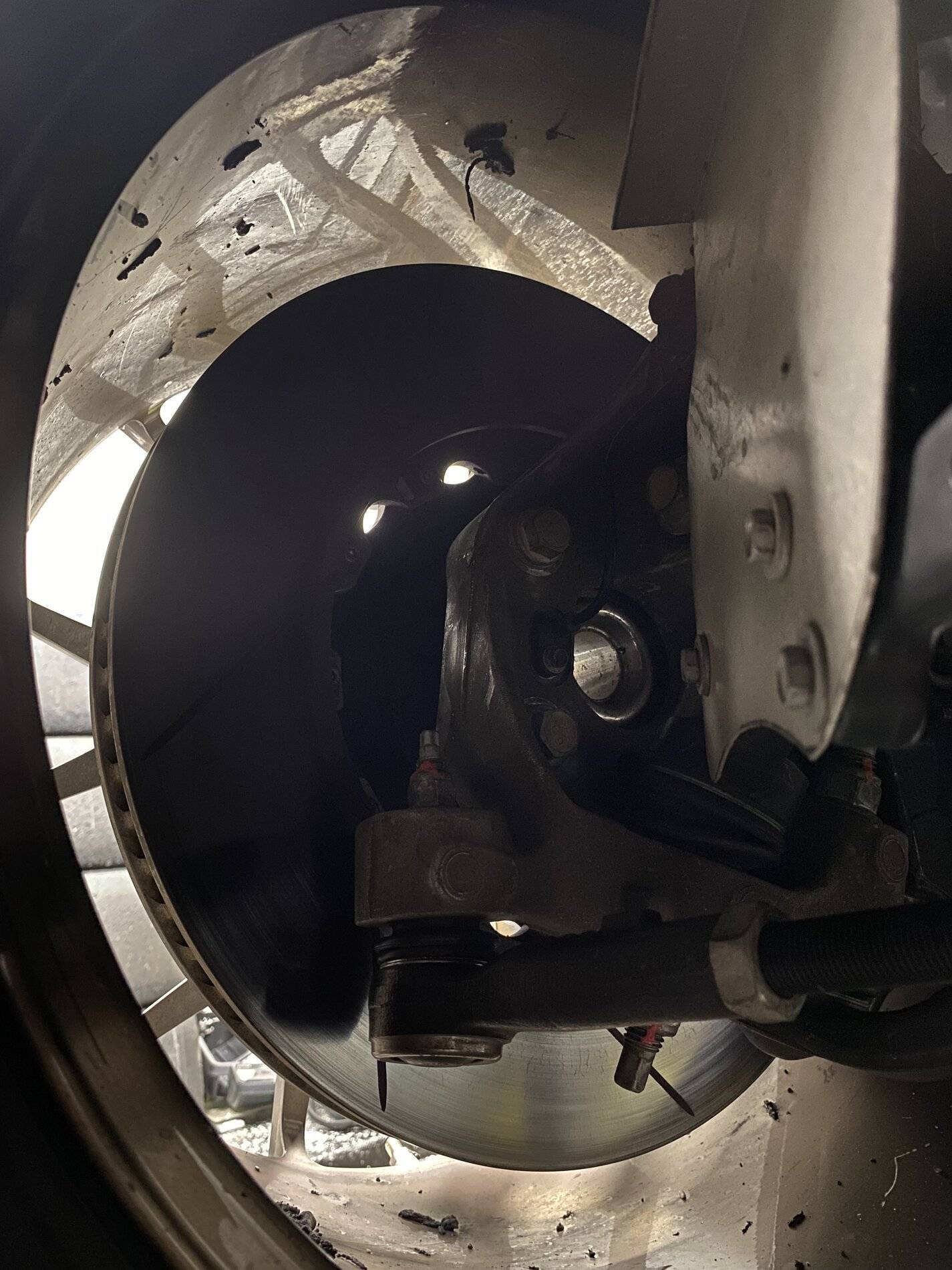

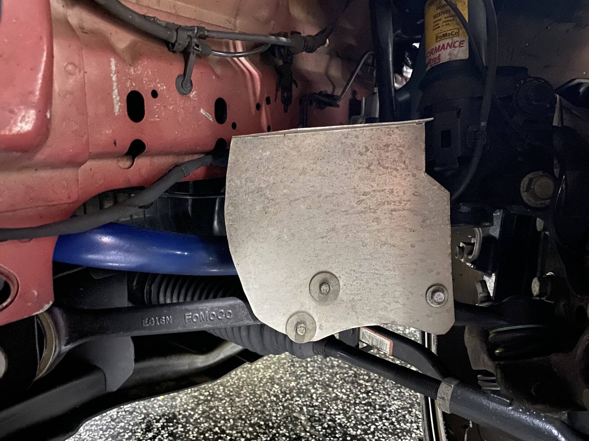

I went to look at my Vorshlag-inspired DIY ones to compare. Pics below (car is sitting on its tires, so car is at proper ride height).
Wheels straight:
Definitely not pointing into the rotor itself - but the knuckle (this isn't surprising since Vorshlag designed these on a GT with the other type of knuckle). Overall height appears to be right. If you can point more into the rotor opening, you'd be dead one.
There appears to be a fair amount of area to the right of the deflector that could be utilized to ensure air doesn't miss the deflector and interact with the sway bar.

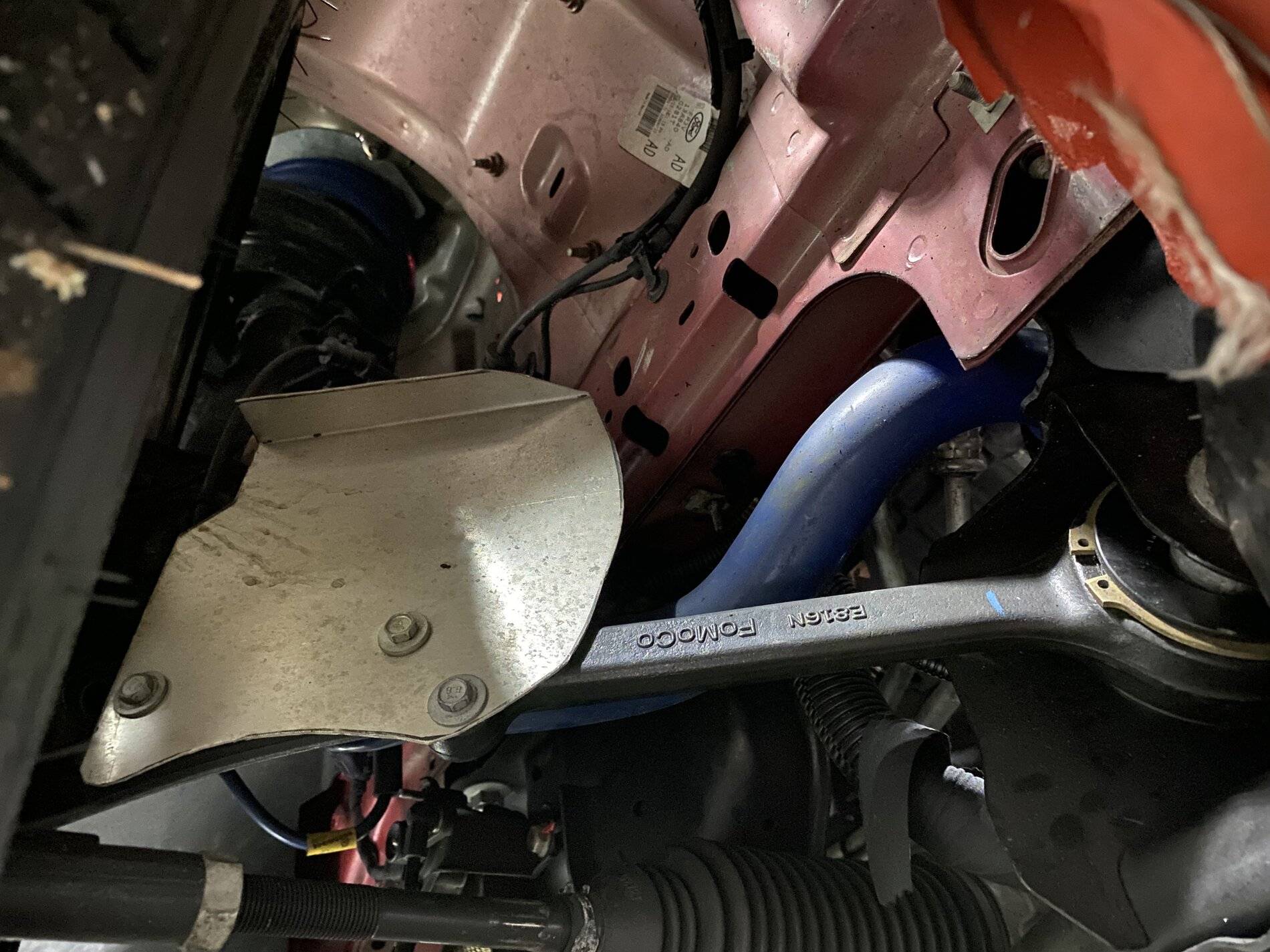

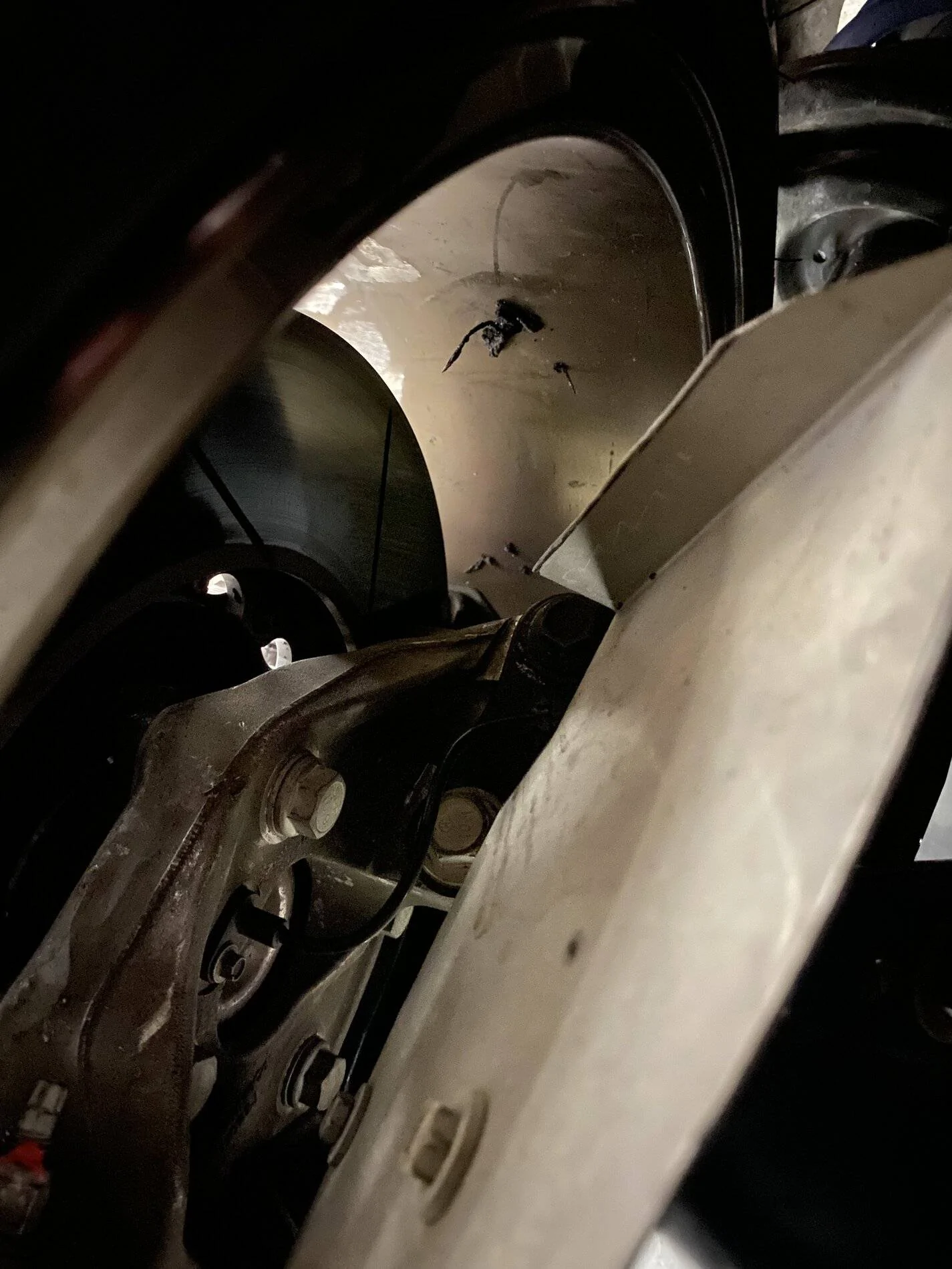

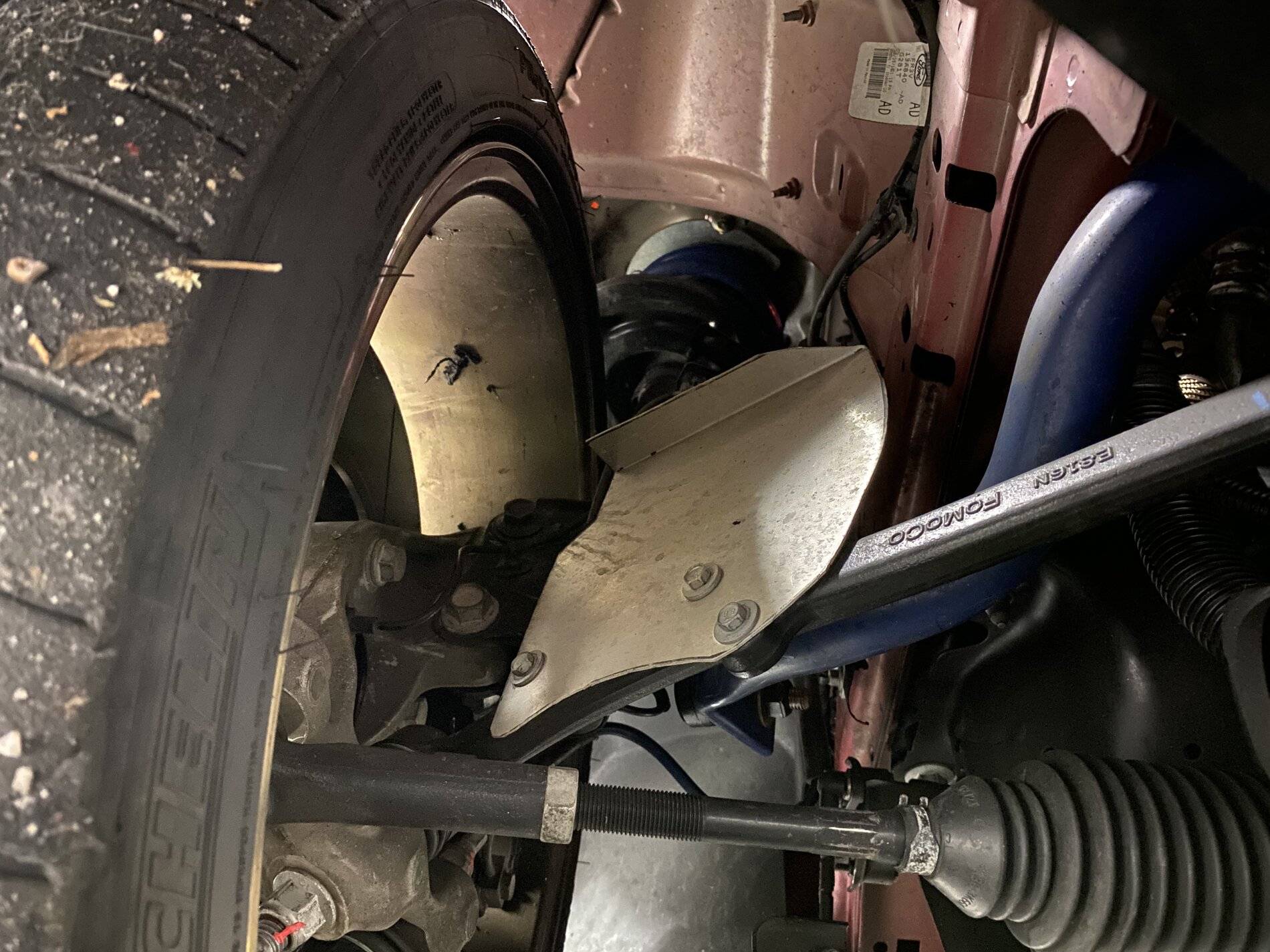

Okay, wheels turned to almost full lock - open side.
Even more pointing towards the middle of the knuckle

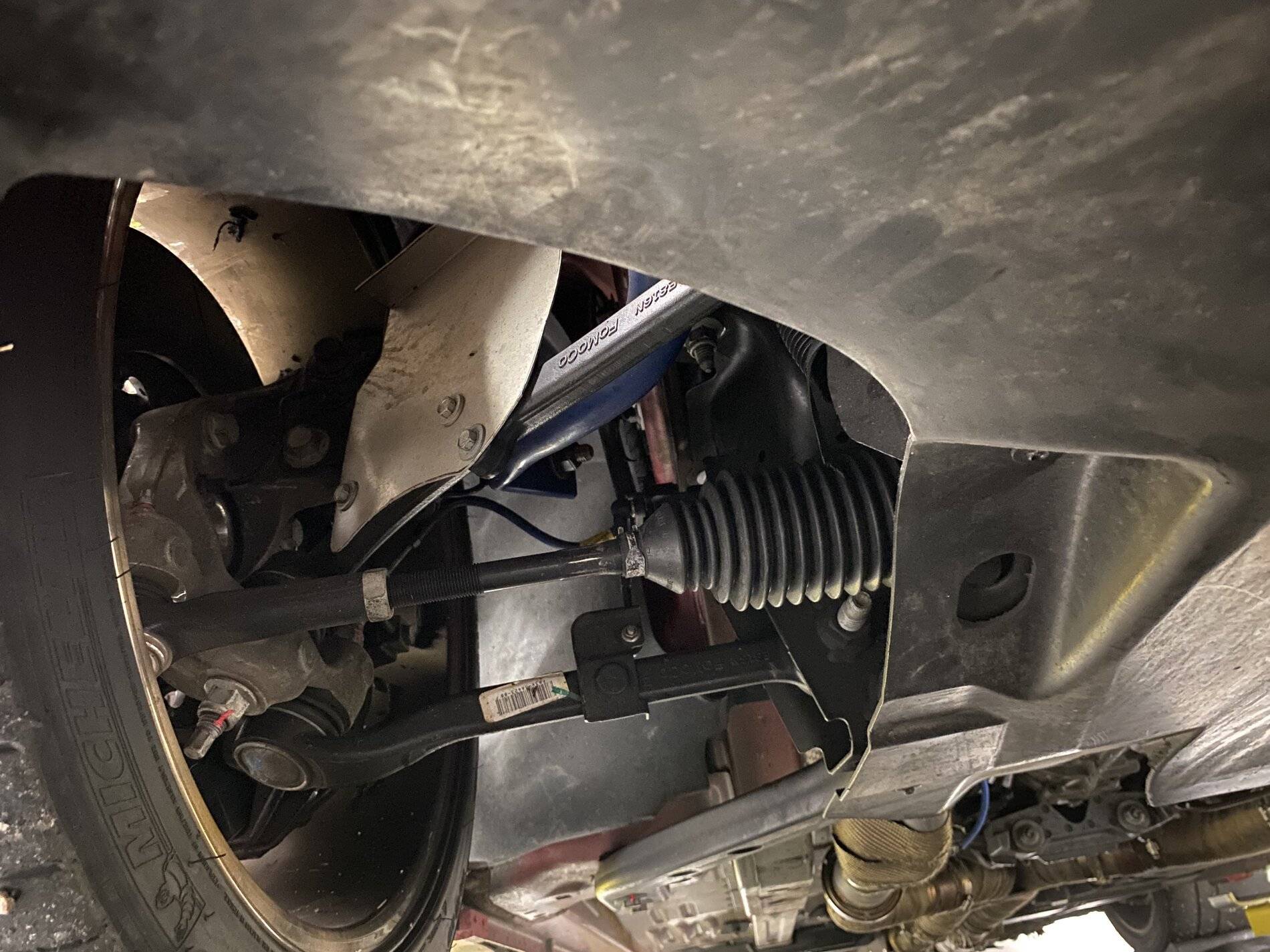

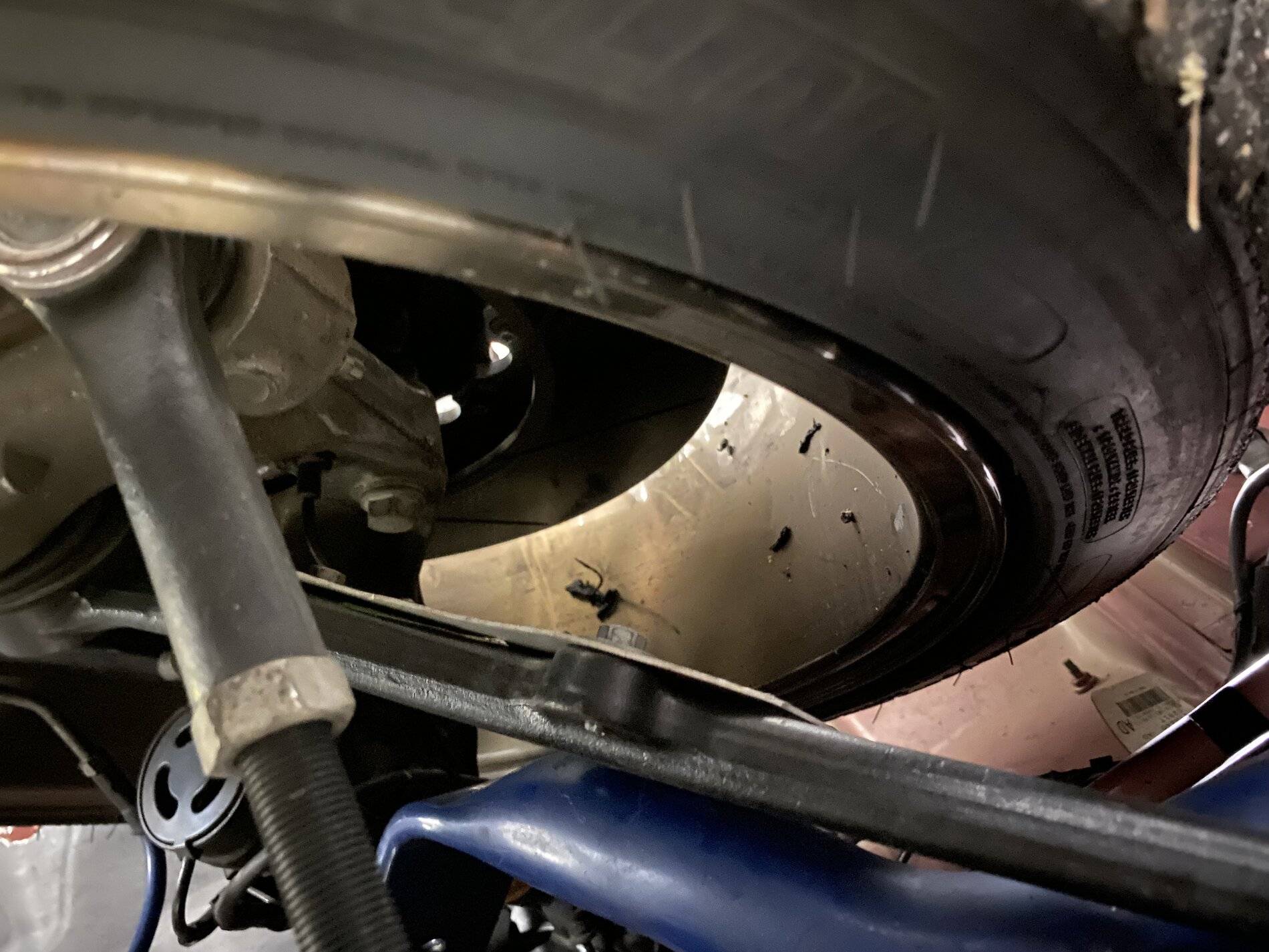

On the other side...not much room between the tire and the frame rails
Again, air being directed to the knuckle vs. rotor
So my initial thinking is that figuring out how to capture more air near the frame rails and then get that air into the rotor vs. knuckle is probably a good first step. Thoughts?

I’ve personally run OEM pads, a couple of the G-Loc lines, and Raybestos ST43s. All have difference coefficient of friction at different temps. I now run the ST43s…the graph of coefficient of friction is below.
In my experience with these pads, they work best when you can manage the temps a bit. After 4-5 brake applications that don’t allow the brakes to cool down thoroughly, you lose a bit of that bite. This is common with the OEM ducting and my Vorhslag-inspired ducting. When I had hoses, I didn’t have this issue, though my pedal had less bite going into the huge brake zones after straightaways - my conclusion is that the deflectors cool better when pointing straight, but efficiency tanks when the wheels are turned. Meanwhile, the ducts and hosing weren’t as overall efficient, but were better when the wheels were turned.
