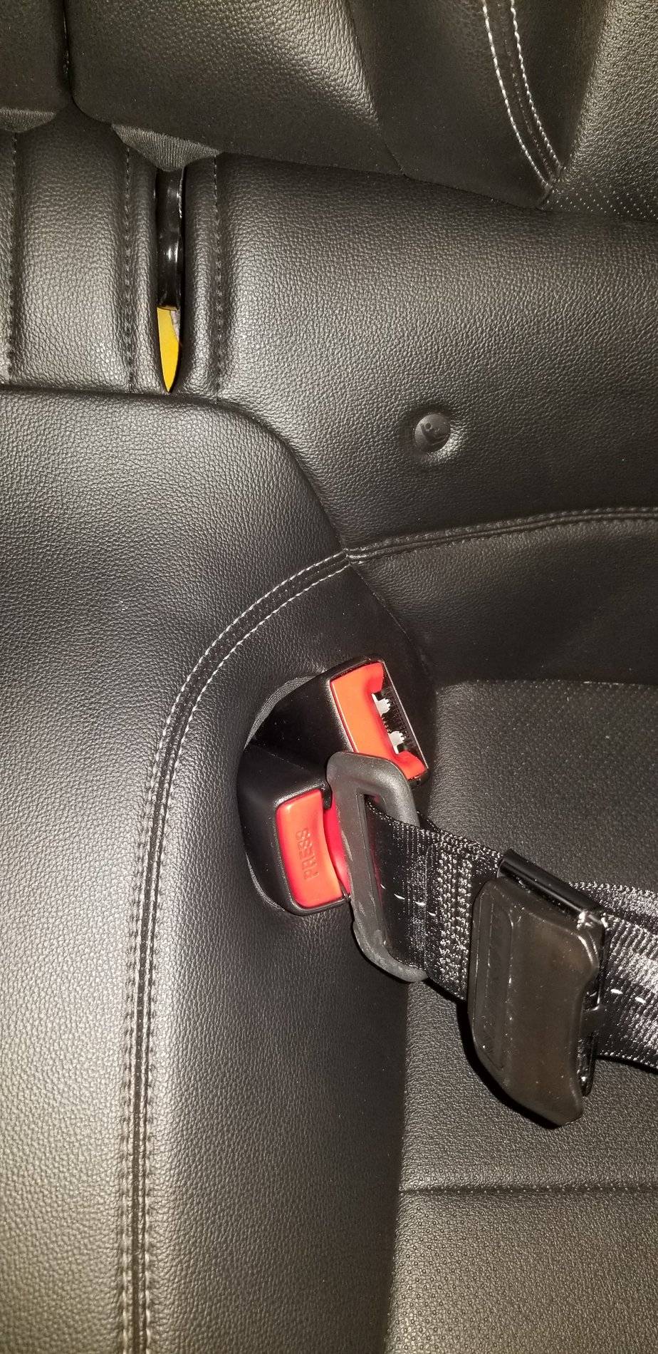

Has anyone tried to put a Quickfit in a 2018 GT or EB? I tried contacting them as well with no luck. What is different about an 18 than a 17 that causes it not to work? I just want to be able to stay in the seat for AX. My try a velcro suit if I can't find anything else.
The Quickfit will fit all newer Mustangs, but you have to change the backseat female seat belt buckle. For some reason, Ford changed that one receiver starting in 2018.
I installed the Quickfit in my 2020 GT500 (along with that one buckle), and it works fine.
From Tasca Ford: FR3Z-6360044-AB Buckle $31.25

Thanks! I assume my factory rear seat belt would no longer work if I made that change. Do you see any reason I couldn't swap the QuikFit male connector to a 2018+ version, rather than changing the female on the car? I assume you would have to cut and resew the quickfit harness. Does it look like that would be possible?
I can't believe Schroth hasn't addressed this if the only difference is the connector.

I left the original factory seat belt buckle installed. Just left it under the rear seat with only the new one protruding. If I ever had a need for it, can just pop off the seat seat pan and pull it up. I tried to have both buckles be available, but the stock hole is too small for both (and I didn’t want to cut the seat).
I asked Schroth about this as well and never received a response. I guess as long as they keep selling the current one, no need to make a newer version....
BTW: Once you see how that harness connector is sewed together, it would take a master seamstress to duplicate that.
I was able to get them both through
