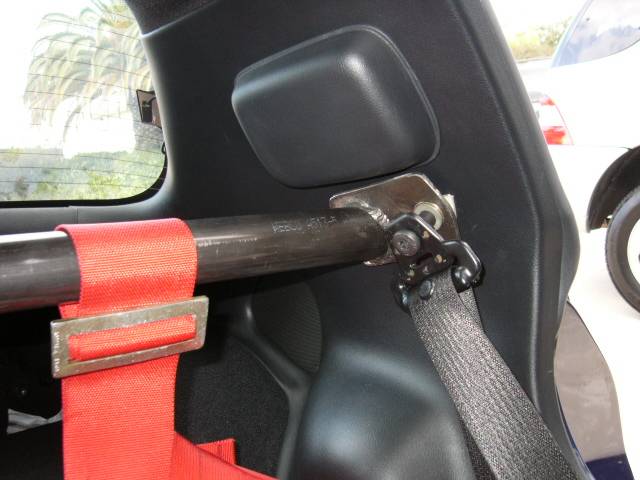

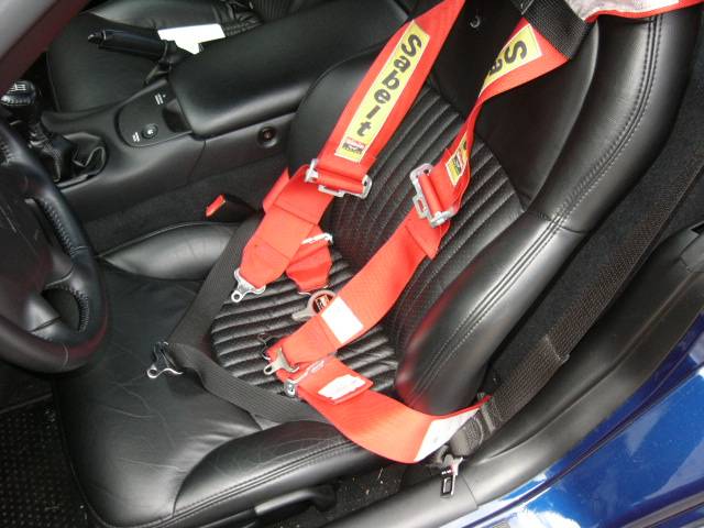

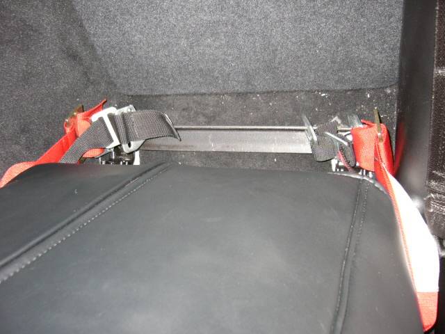

For some ideas:
I did this a long time ago to a vette but the same kind of thing can be done with the s550. This is a parachute 6pt with angle iron drilled for anchors and then itself anchored by the rear seat anchors. I needed something quick for a 1st track weekend in that car. No holes drilled in car. harness bar attached to the shoulder belt anchors and I repositioned the shoulder belt so I could still use it. I welded that out of 120 wall DOM tubing in about an hour. If that was a permanent install I would have welded a 1" DOM down tube to the angle iron and a similar 1" bar to the passenger outside rear seat anchor and build a defacto harness bar truss. The setup would then be much more robust. Joe Marko is the guro of safety at HMS motorsports supporting many NASCAR teams. He has written on a number of occasions that the harness bar and rollover crush your spine myth is just that a myth. But like many other things "dual use" there are anecdotes, little data, and lots of opinions. YMMV
