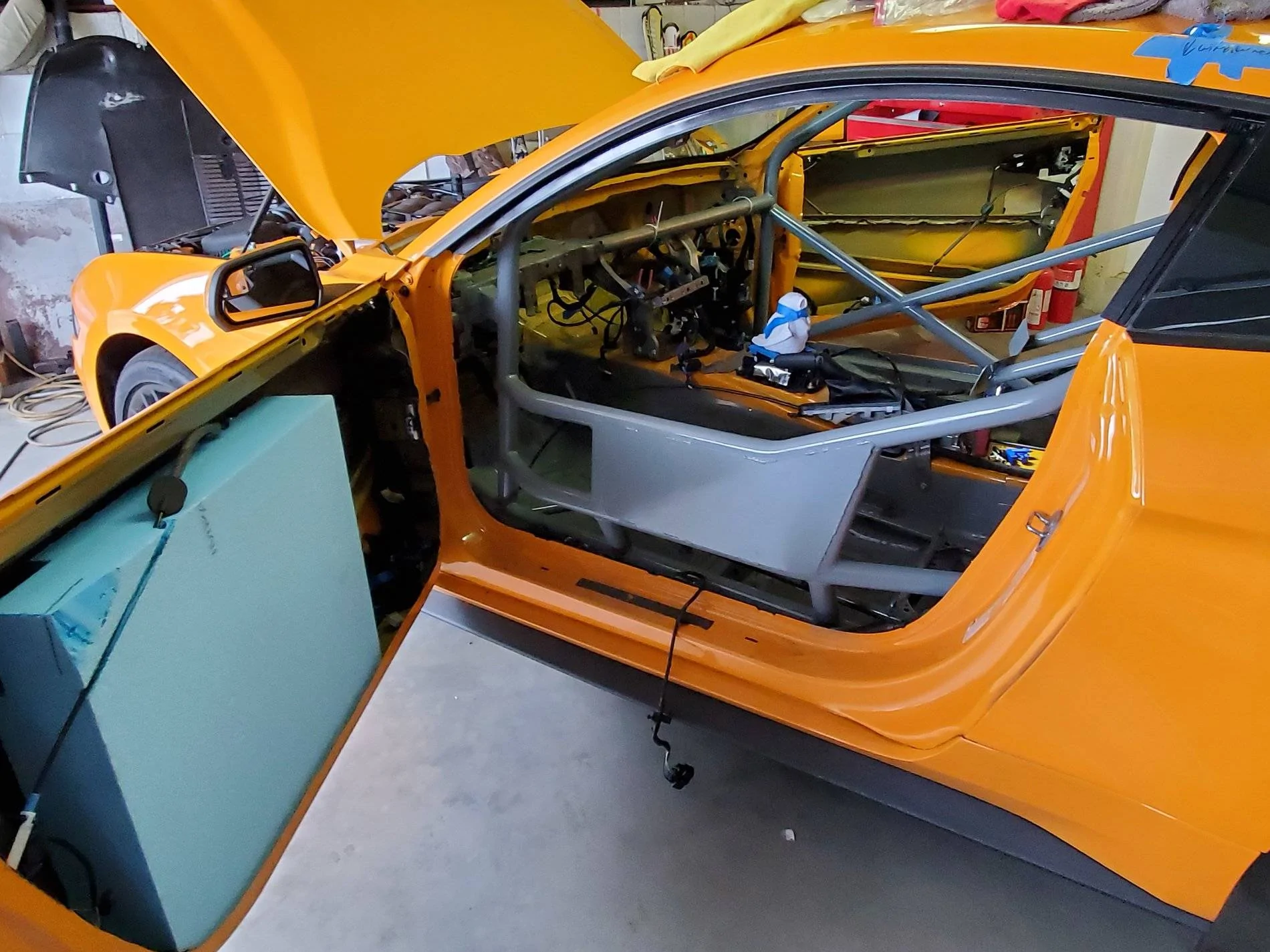

When I started racing my first cage was a bolt in. My second I welded had X bars. My 3rd I welded has NASCAR bars to the door skin. My 4th mustang has minimnal NASCAR bars with impaxx foam sandwiched between the stock door intrusion bar and my intrusion plate welded on the NASCAR bars. We change as times change. Here is a pic of my 2019 GT mid-build . Note the NASCAR bars supported by a sill tube.
