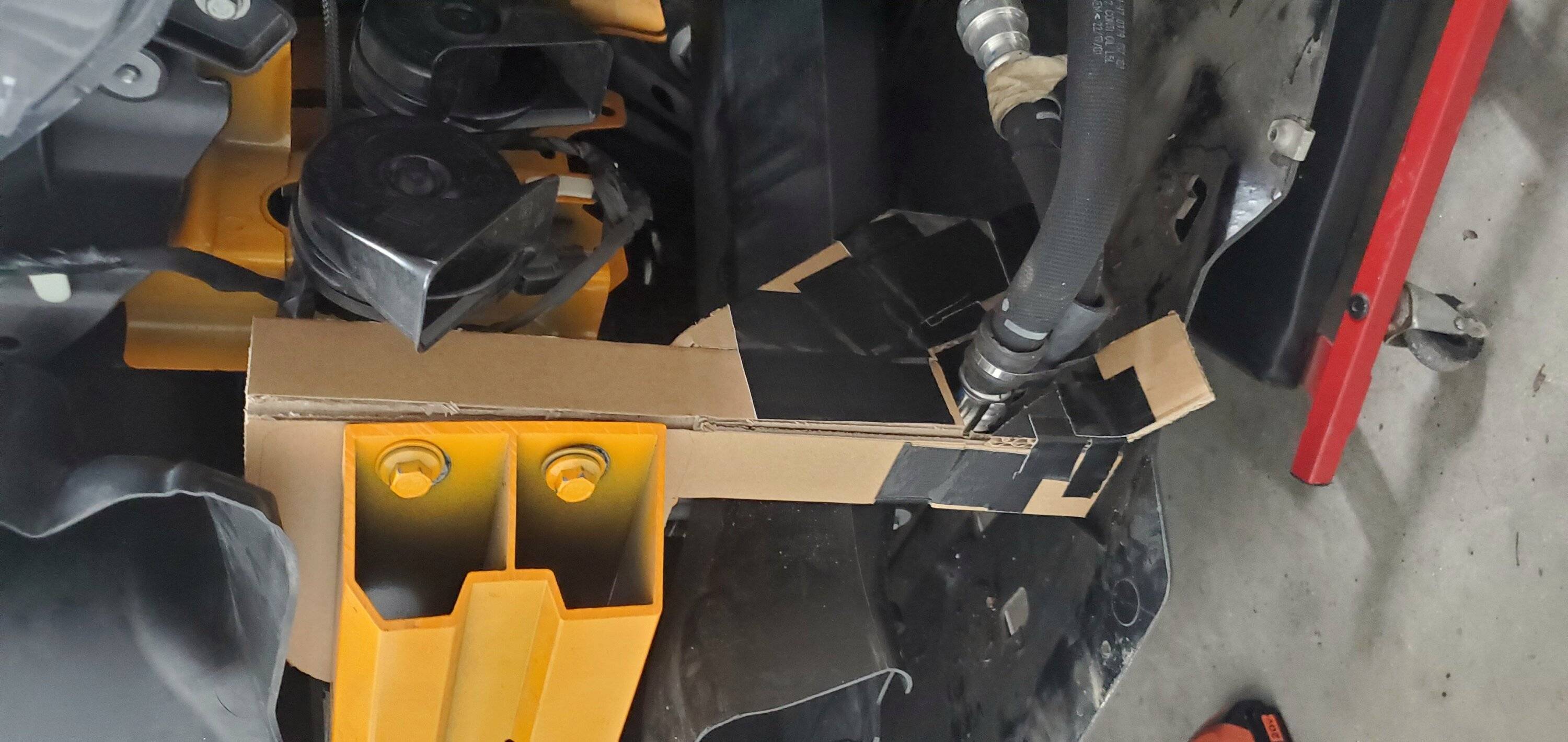

Splitter rods measured, cut, and mounted. Hoping to pick up some 1/8" plate to make the actual chassis mounts from this week. Made some test templates out of cardboard this weekend to check clearances and general layout and pretty happy with the upright design given how little free space there is with the GT350 and the oil and trans coolers on both sides.

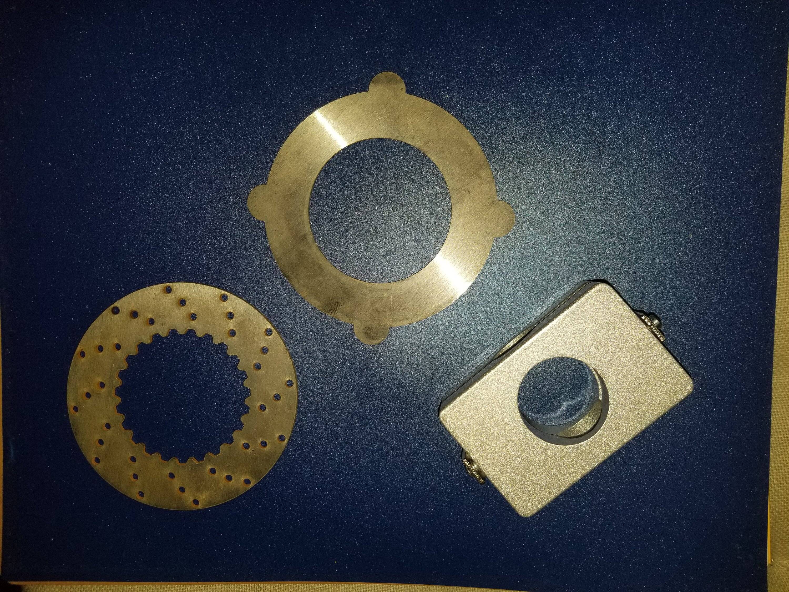

Cross-post:
Most know I have an EcoBoost which I Auto-X. Because of the lower RPM nature of the Eco, most Auto-X courses end up between 2nd and 3rd gear. It's a very clumbsy gearing combination that makes several shifts a lap inevitable.
In an effort to be able to run almost any course by launching in first and then running the rest in second gear, I am installing a 3.15 rear end (removing a 3.55). The down-side to the 3.15 is that none of the performance differentials are available. The Torsen and everything else is made for the 3.31 and numerically higher gears. The only LSD available for the 3.15 ring size is the Trac-Lok, which has relatively low locking capacity, next to no preload and only lasts a couple slip events before burning up the friction material. It's not a great combo. So, I've made my own differential plates (water jet cut) to help address these problems.
The stock plate thickness allows for 3 drive and 3 driven plates. I have made mine thinner, so I can get 4 of each on either side for more total lock. Further, I've made them from hardened 4142 tool steel, so wear shouldn't be much of an issue. I've found a preload block off of Alibaba for $15 that I think I can use for that function. In the end, I know that I'm probably giving some away to a Torsen or OS Giken, but I think I'll be a hell of a lot better than a stock Trac-Lok. At the very least, especially since I'm changing to an Al housing, I'll be a lot lighter.
I'm a bit busy presently, but this is my latest windmill to knock over. Maybe I can get to it during the last 1/2 of February.

That's impressive. Out of curiosity is an OS Giken available for 3.15 gears?

No, it's not. It's a bummer, because I think the Giken is probably the best available overall.
