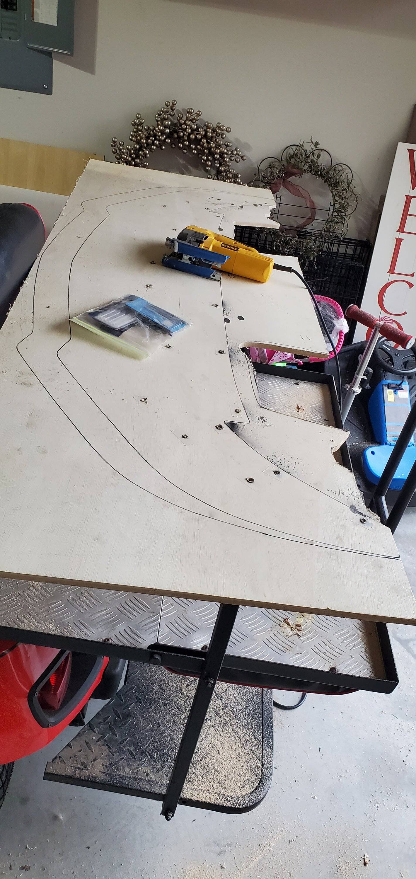

Chassis mount splitter design under way for the new year. Using cheap birch plywood for design and mock up purposes. Now to figure out some good chassis mounting solutions. I've seen everything the market has to offer from Verus to AJ Hartman down to LiquiVinyl and even non Mustang specific solution like Professional Awesome. Really wishing 9 lives offered a splitter for our cars like they do so many others. Looking at doing my own thing now because why do it the easy way right?
I've made two now. Its a lot of work, but its a fun challenge. Used the professional awesome mounts as part of the solution. Used normal plywood the first time, and marine grade plywood the second time. The marine grade stuff is really nice. Very flat, is holding up well so far.
I was looking at them too, but based on the orientation of their attachment and the oil cooler on the GT350, I think it directly interferes with the oil cooler lines so likely won't be able to use that mounting solution on the driver's side without a lot of customization.

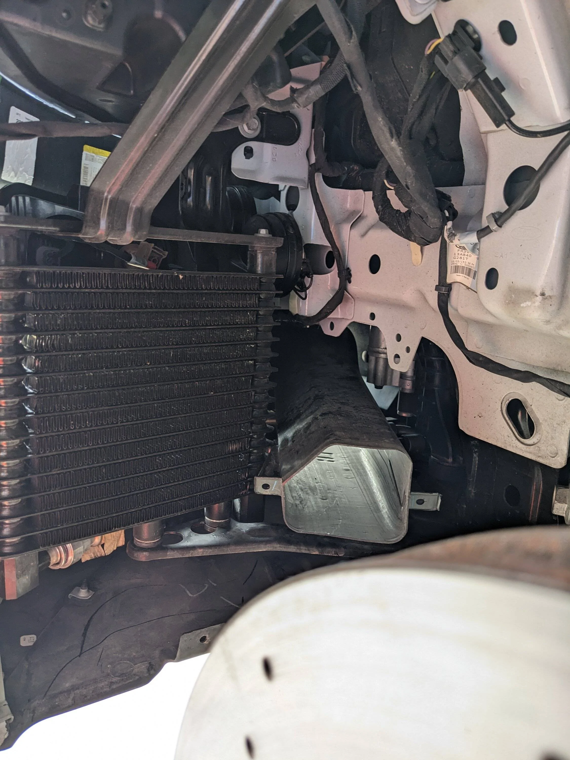

Question not necessarily 100% CAMC related, but if any group has experience with this, it's this group. I'm debating pulling wheel well liners. I know this has been done before, and it looks like it could save about 12-16 lbs. My question is this radiator in the front driver's side wheel well. Is there any concern of rocks damaging it? Anyone has that issue?
TeeLew
Apr 27, 2020
3,396
2,613
So Cal
Tim
Honda Odyssey, Toyota Tacoma, 89 GT project, 2020 Magnetic EB HPP w/ 6M
100% you need to protect it. Ideally, ducting would put the actual cooling air flow into a low pressure area. Directly in front of tires we often find relative high pressure, so from a cooling standpoint, the present arrangement is probably not optimum.
