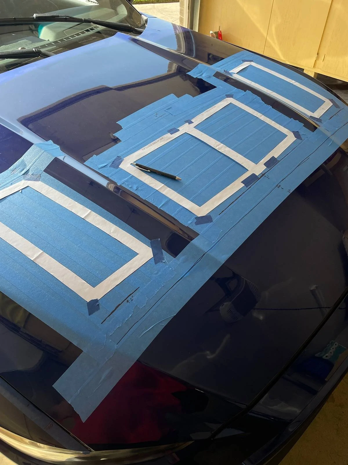

I used a 4.5in grinder with no guard and a cutting wheel combined with a metal blade on a jigsaw.
It worked…but not super duper clean…then again what ever will be.
Proper name: "Death wheel"
Hey, it works.

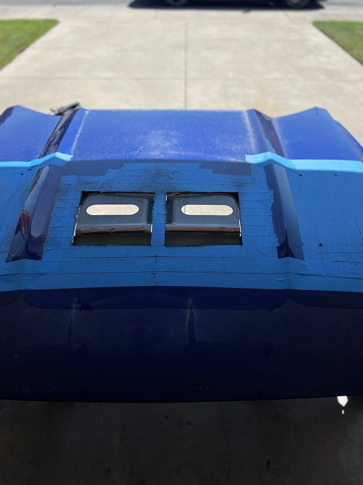

Also put some thick plastic under the hood while you cut. Will catch metal shavings. Works better with a saw than a cutoff wheel as the saw doesn't get the metal as hot ao you don't have to worry about it melting through.

Or remove hood from the car entirely. Place on two sawhorses and feel safe that you won’t accidentally cut too deep with a death wheel.

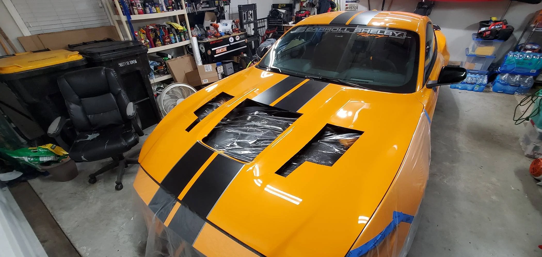

Aluminum hoods are a breeze to cut. Soft, no sparks, no drama. I've cut mine using oscillating multitool and it went through it like butter.
Steel hoods are completely different story. We are lucky to have aluminum hoods for cutting on mustangs. 😁
Which blade did you use ? (i have that one too - bought for OPR removal).
They are soft, but the second layer is pain in the ass with its funky shape.
Same, with propped hood on rubber blocks to not cut anything underneath. I had the hood removed earlier in the year for center vent (I have $100 marketplace hood) but putting it on and taking it off it pain in the ass.
Yea I removed because I did center and sides in one day

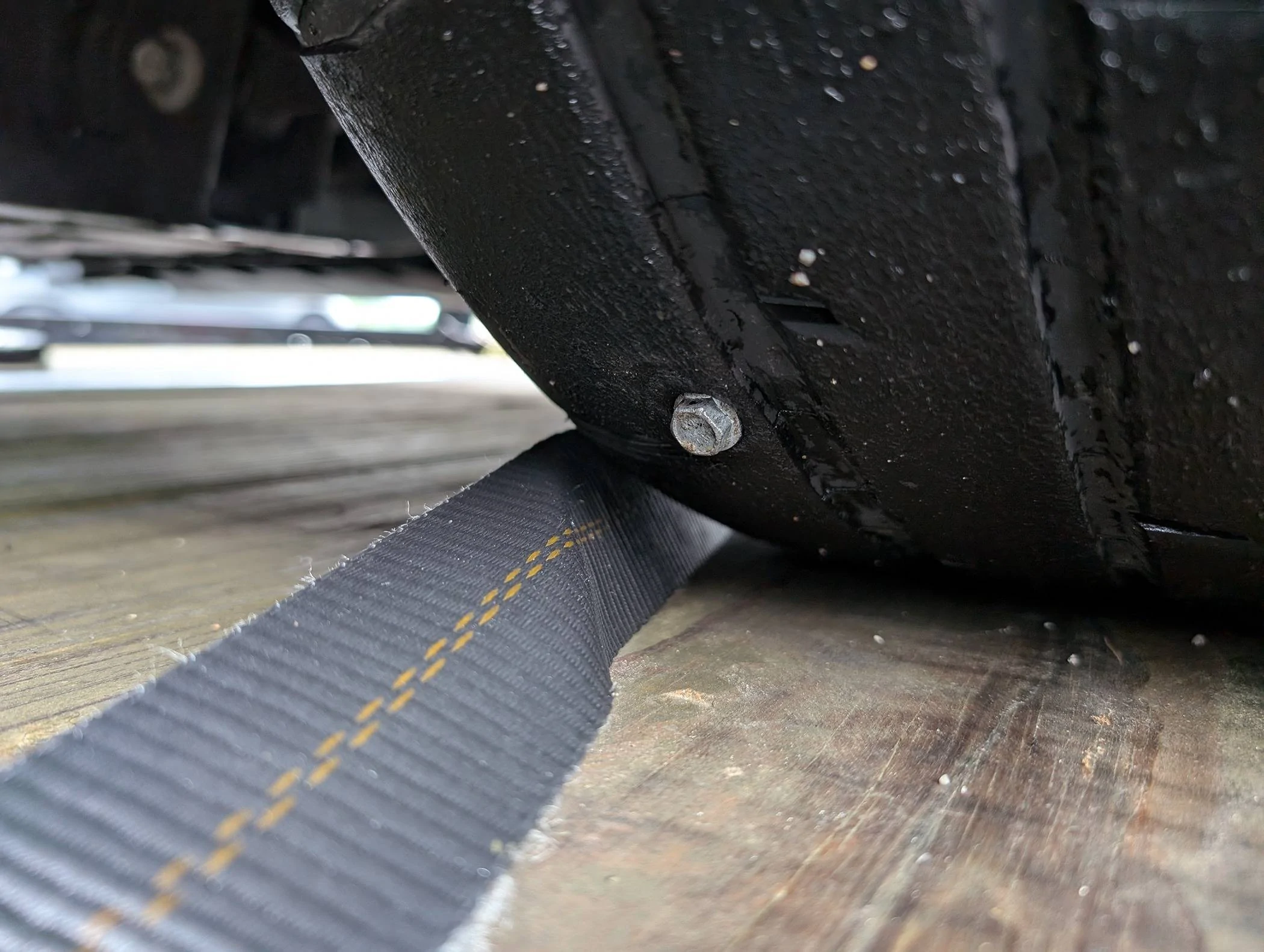

Speaking of randomness of the events - Cleveland tour - picked up on the way to grid and noticed pressure going down with a two minute warning. Found when car was already on the trailer.
Went all the way to Cleveland - that generally no one wants to voluntarily go to - for basically nothing as Sunday I was DNS. Not enough time to do anything (Sam said he would lend me a wheel off his Mach but it was too late to do anything)
