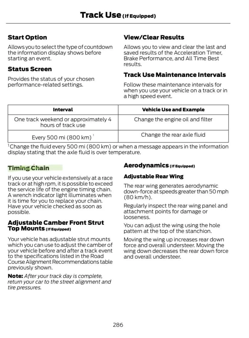

So looking through the S550 Owners Manuals, I came across something interesting.
In the 2021 Mustang Owners Manual under "Track Use", on page 286 there is a statement about the Timing Chain, here:

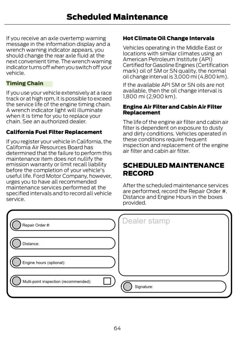

So curiously, I back tracked on prior years and don't see any such statements from 2015-2019. If I missed any such statement from those Owner's manuals or supplements,, please post up.
I then checked the 2015-2020 GT350 Owners Manual Supplements and the same exists:

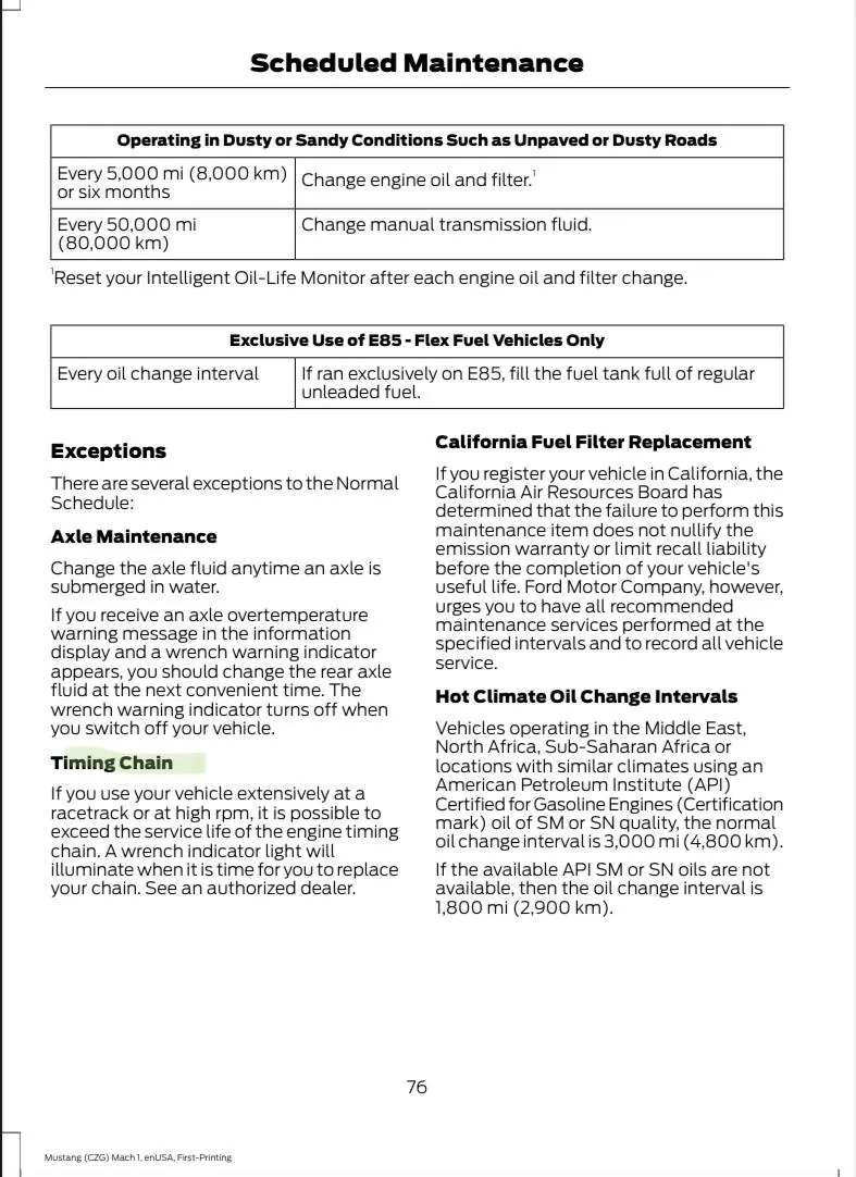

And lastly, checked the 2021 Mach 1 Supplement:
What IS the "service life" of an S550 V8 timing chain (normal or track use)? It's not mentioned anywhere in the owners manuals or supplements.
If the "wrench light" appears while in motion at the track for a Timing Chain notification, does that mean it appears AFTER the engine suffered a potential failure, or is the PCM that smart and aware of being able to detect a preemptive Timing Chain failure BEFORE it happens to allow the Driver (in motion and at speed) to hopefully stop the car before engine damage?
Was anyone aware that the S550 V8 PCM's can detect timing chain wear and notify the driver via a "wrench light" (DTC)? Is it the timing chain tensioners detecting the wear based on a preprogrammed service life table/code in the PCM?

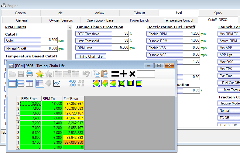

The gt350 tune has a counter based on time spent at certain revs that ticks down to the wrench light and chain replacement warning. Certain harmonics and rpms must stress things more because the tune list larger reductions in time remaining for very specific rpm ranges.
I've not seen this on the gen2 tunes or gen3.
I'll double check the mach1 tune again.
Possible this is in the tune but its just not a populated table.
What is the ECM number for this table? I have not seen it.

ecm 9506, under fuel and cutoff/dfco.
Well that's fascinating. I wonder if this is a GT350 feature that's trickled into the GT tune for '21 MY. Maybe they collected enough data for the gen 3 coyote to build a table like this.
