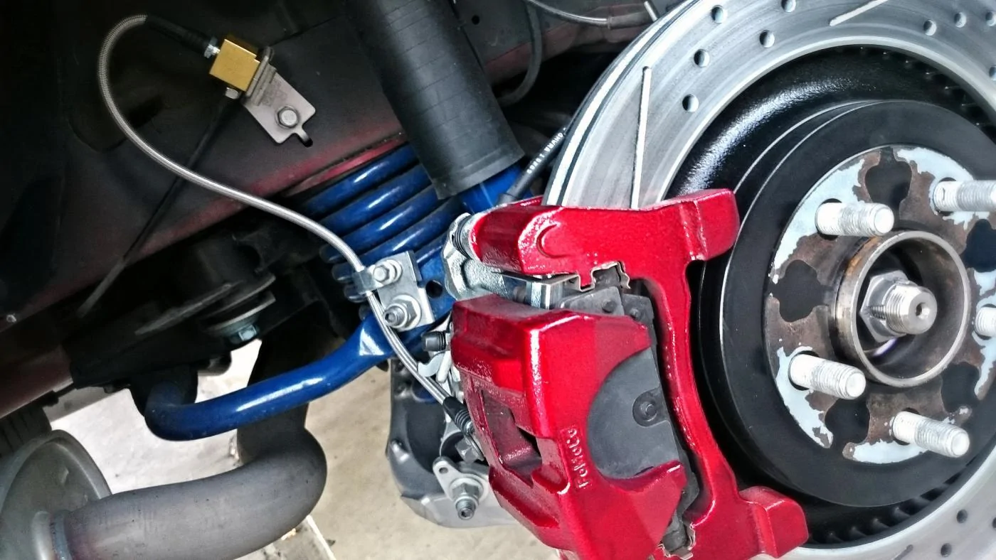

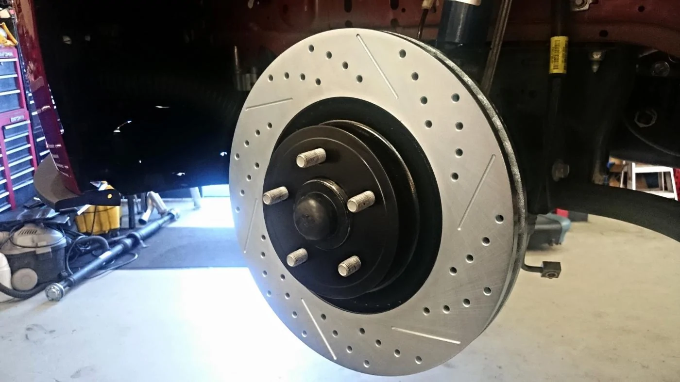

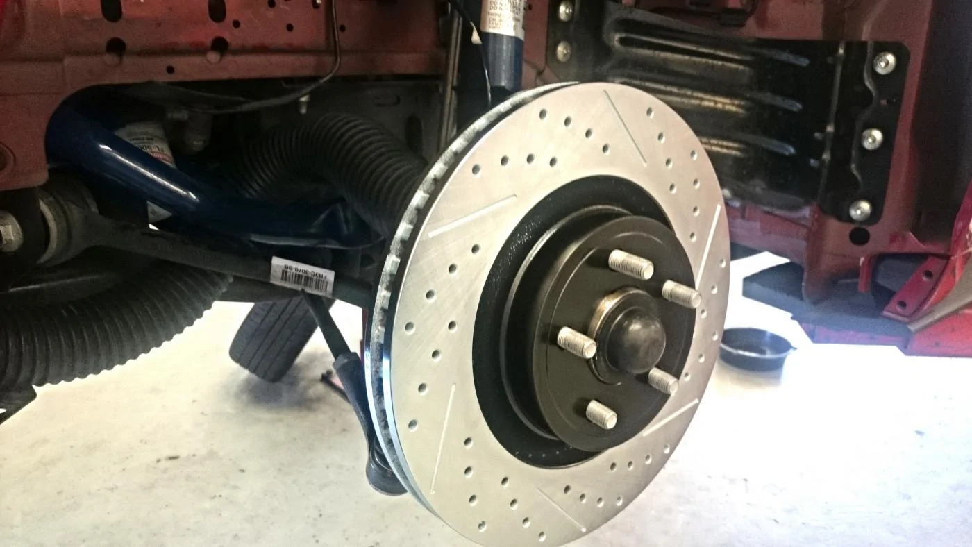

Slotted and Drilled and Air Cooled!!!!

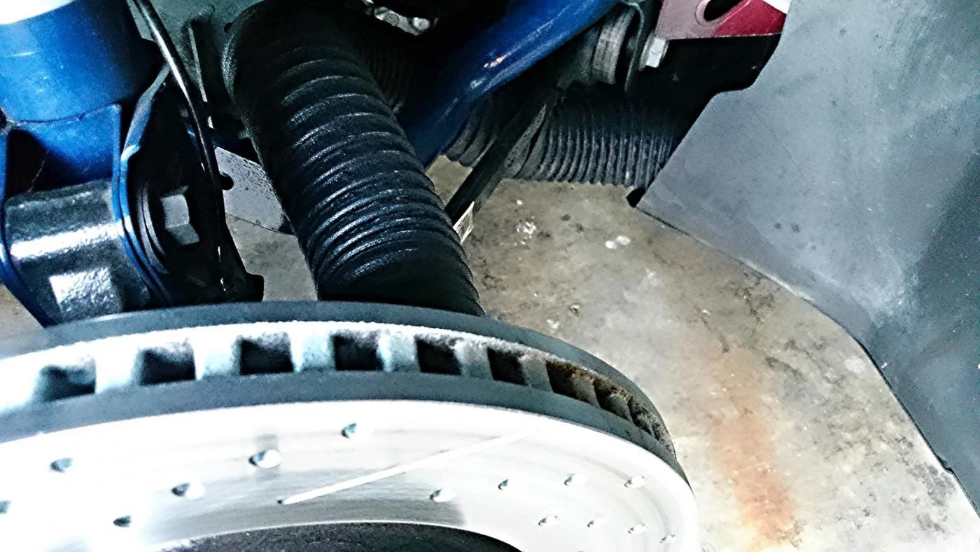

I had the rotors and a cold air cooling kit form JLT installed this weekend. The kit deletes the mostly useless fog lights and replaces them with slick looking black bezels that allow you to attach heavy duty hoses that then run to plates installed behind the rotors. More pics to come...

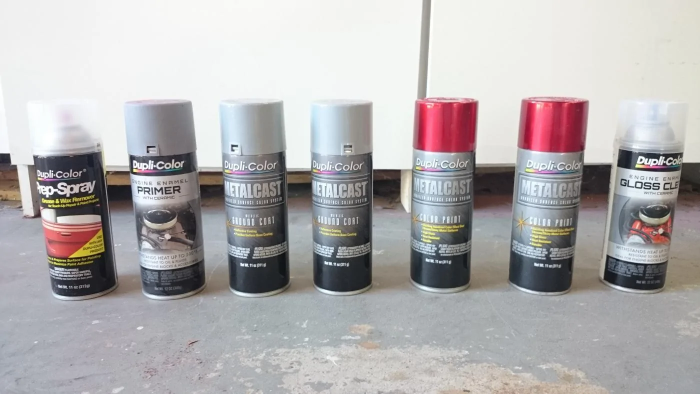

Here are the paints I used. They are all high temp paints good up to 500 degrees F. If I was to do it again I would use an additional can of color and clear...

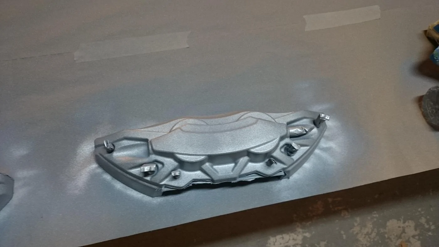

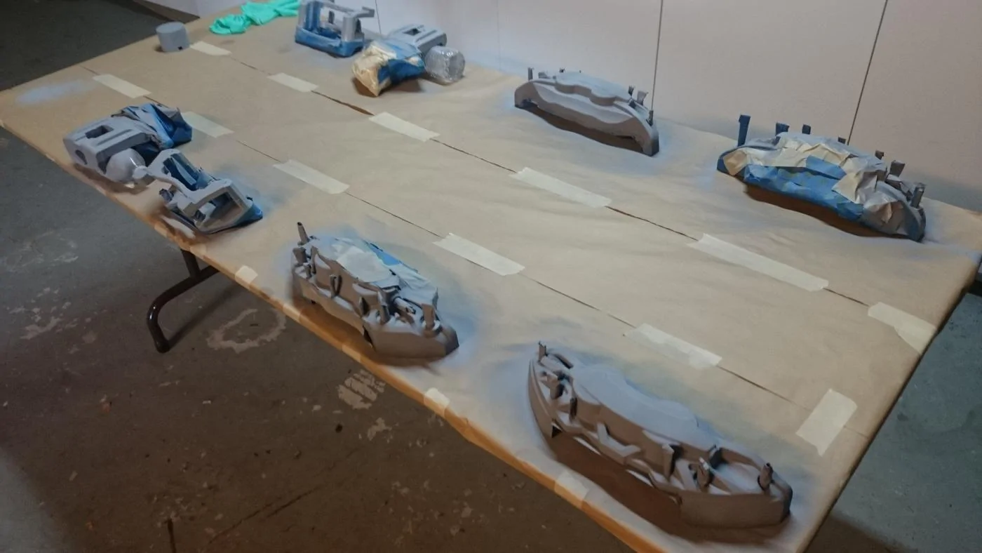

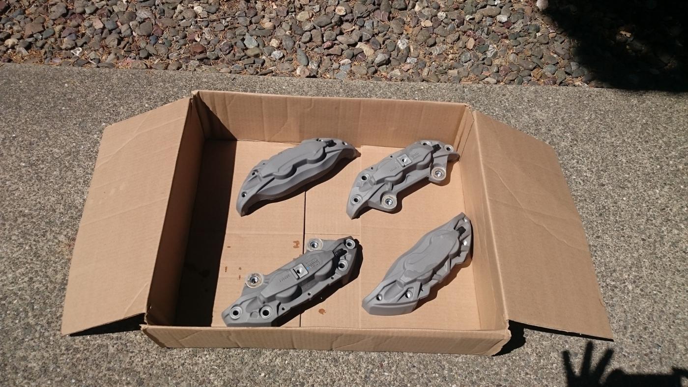

Here the calipers are prepped and primed. Allow for at least a couple of hours for disassembly and tape. The tape is a huge part as you don't want paint getting into the mechanical pieces of the caliper. It is not required that you prime with this paint, but as the calipers have a rough surface and I wanted to use some prime to help build up over that rough surface to leave a smooth finish...

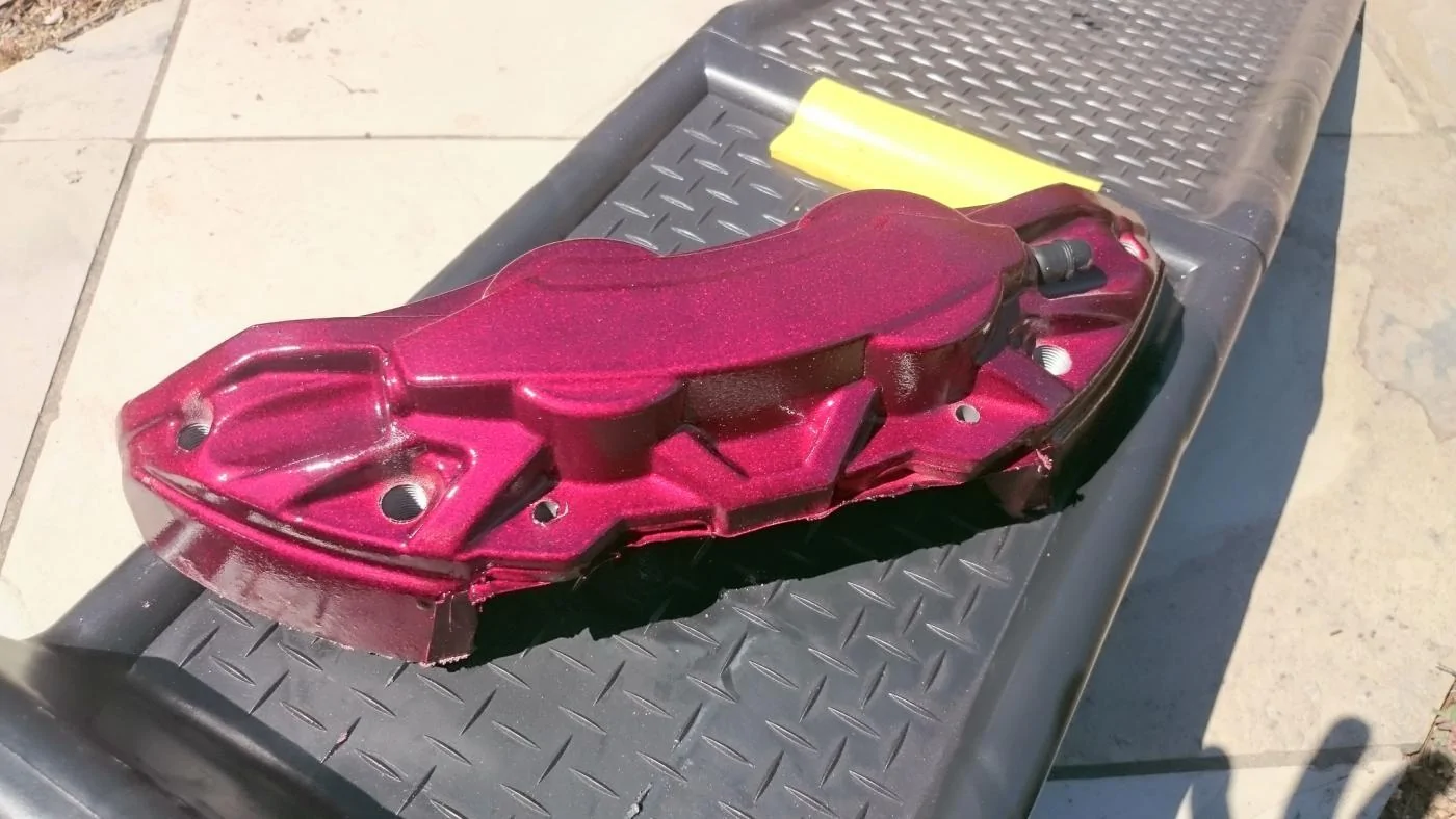

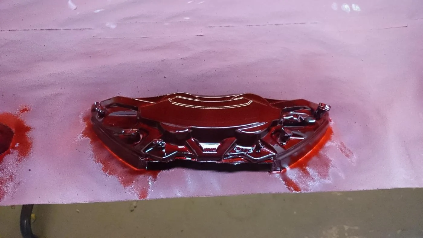

You want to get the paint on pretty thick without it running. Like I mentioned, I would have used another can to touch up the fronts, and put another heavy coat on the rears, if I would have had one...

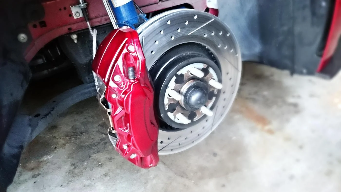

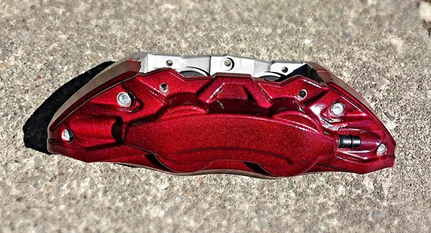

Here is a look at the caliper just after the tape was removed, before it was cleaned, sanded, touched up, and re-assembled...

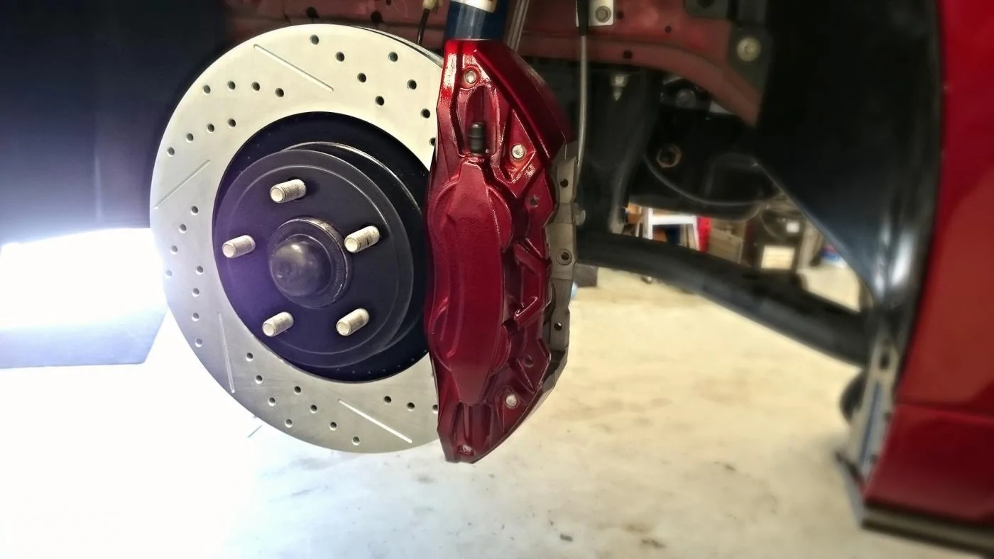

Here is a look at the final product, albeit in crappy shop lighting. I am extremely happy with how they came out. They are not perfect, but they are damn good for a garage paint job!

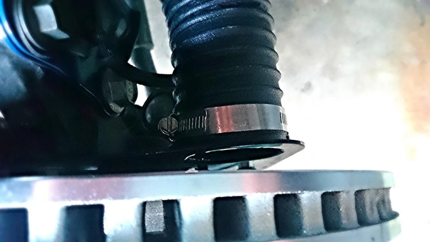

Plumbing
This is the route and the outlet for the JLT cold air brake setup. I will add a pic of the inlet when I can get a shot of it in decent light so you can see the inside of the tube as it makes its way through the facia.
