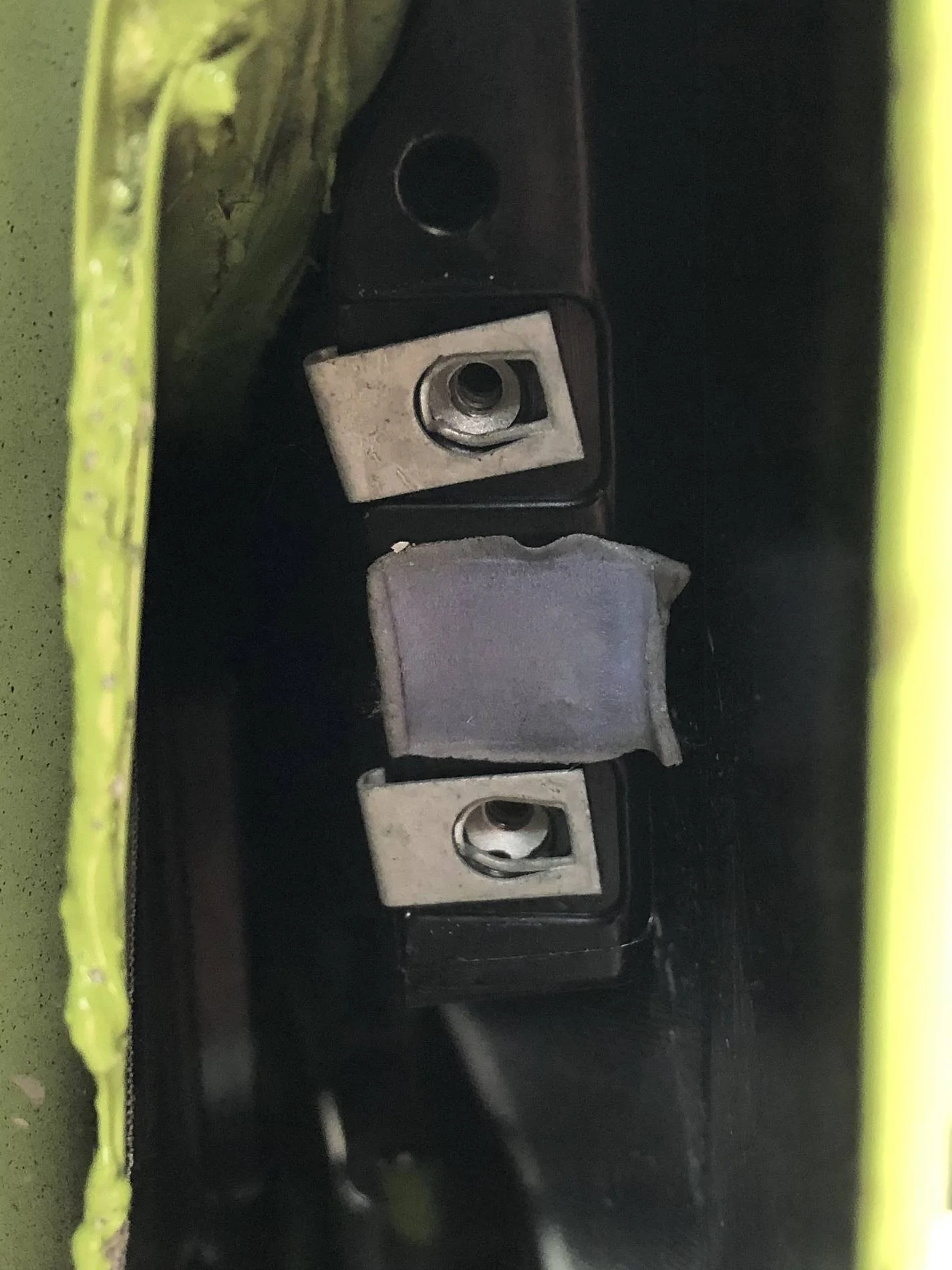

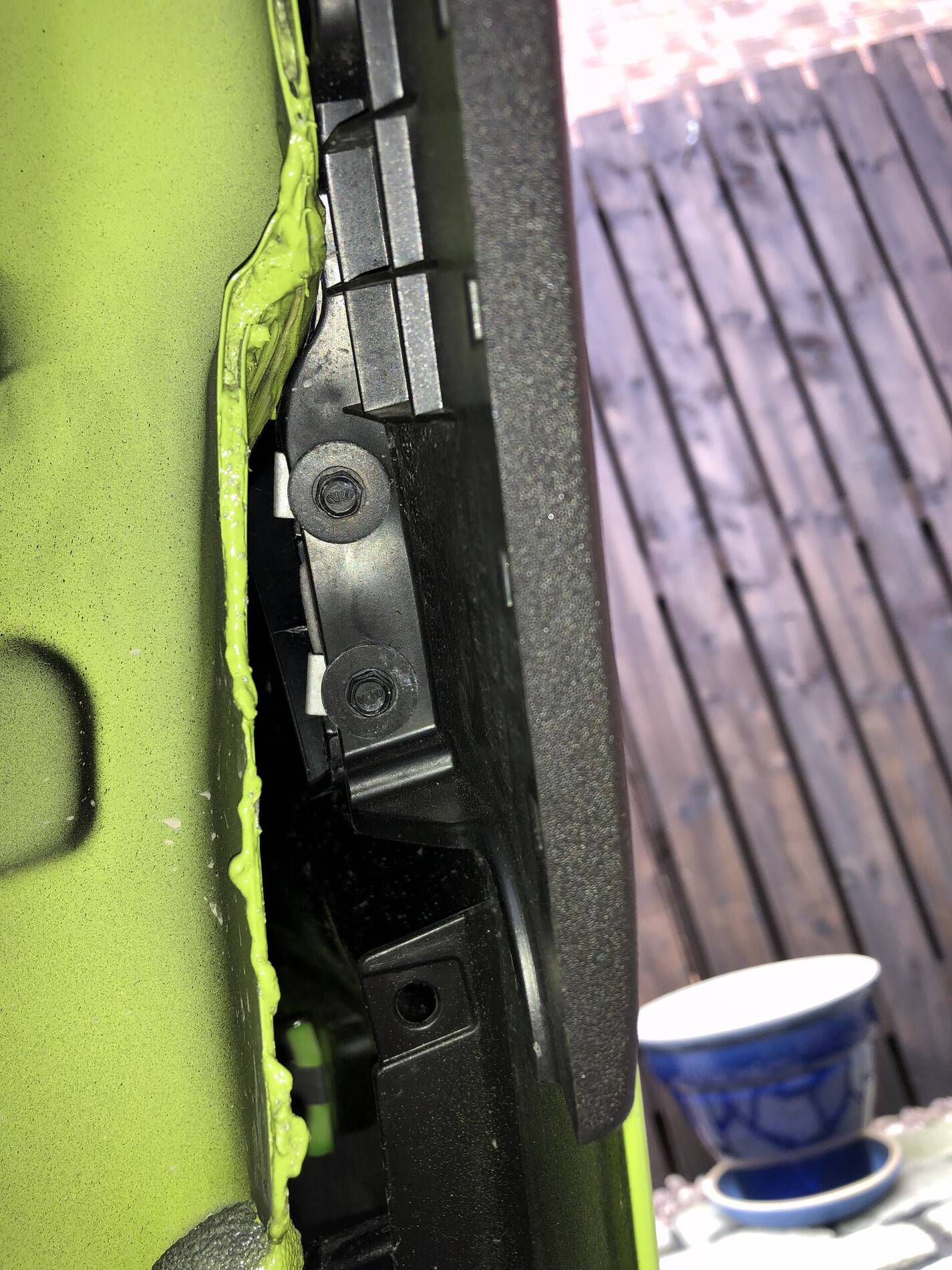

If you are interested, the little black guards that are layered under your RokBloks can be removed easily - just pull the fender liner back and there are two 7mm bolts and a 20mm square of VHB :like:

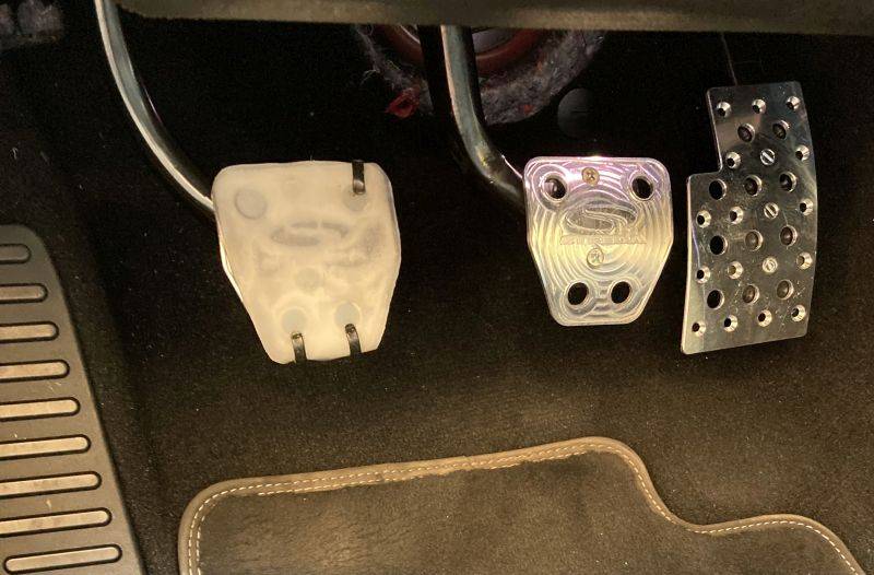

While I was at it, I also installed the Steeda heel and toe pedal. I already had the Steeda pedal set, but with a normal-sized gas pedal.
The instructions from Steeda state that the gas pedal should be attached to the OEM metal cover by means of self-tapping screws. And when I installed the complete set I did just that - a job I wasn't quite satisfied with, to be honest, because it didn't look quite as clean as I'd wished. But now I've done it properly - removed the pedal assembly from the car, removed the stock metal cover (one torx screw on the back), drilled holes through the pedal, and attached the new aluminium piece directly to the pedal itself, using bolts and nuts.
I'm not sure yet whether I should also raise the gas pedal by one centimetre or so. It would be easy to do, but I'm not sure it's a good idea. It would make heel and toe easier when braking softly on the street, but it could also make it more difficult, or perhaps impossible, to brake hard without accelerating at the same time. I'm afraid I might rev the hell out of the engine every time I need to brake a bit harder than normal. I don't know. I'll think about it.

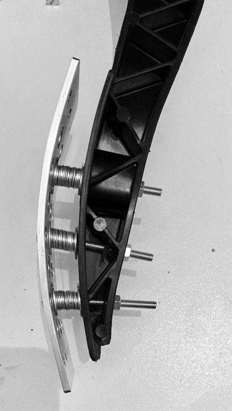

I decided to raise the gas pedal a bit. After measuring the standard gap, running some tests with pieces of foam, and reading other posts on this subject, I decided that one centimetre would be a good starting point.

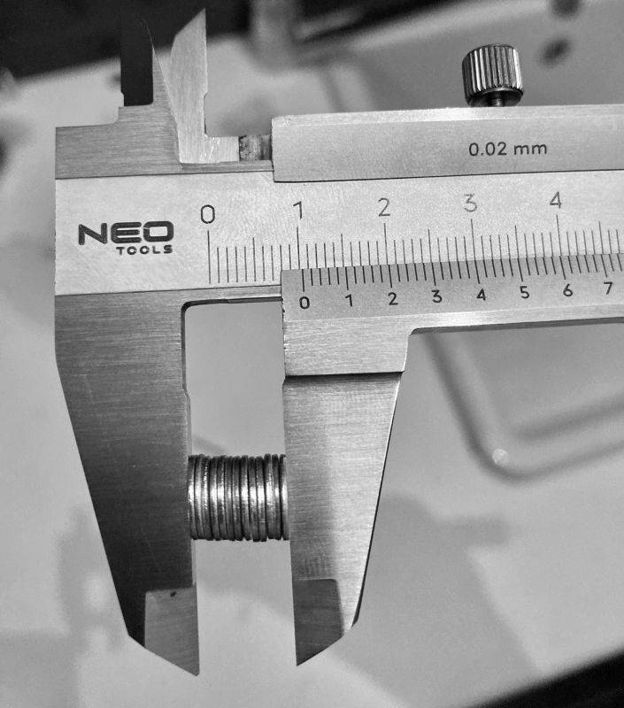

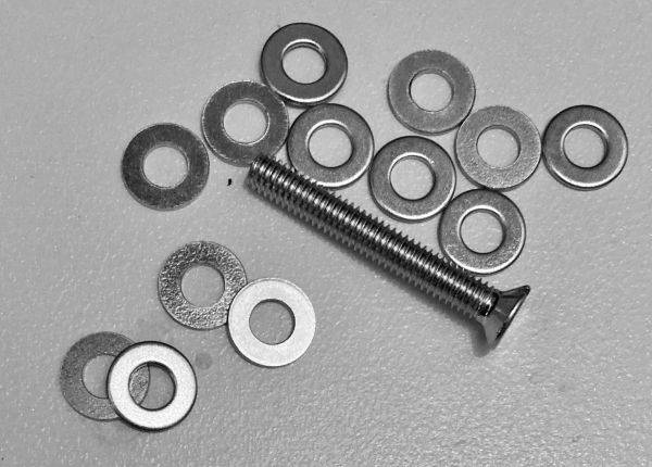

For this purpose I used washers like these:
I then determined the required number of washers.
Thirteen washers make 10.4 mm. Twelve washers would have been 9.66 mm.
So, I went with thirteen.
And this is how the pedal looks from the side, with a one centimetre gap between the pedal itself and the aluminium cover.

By chance you plan on trimming those back. Would not want that to get hung on the carpet, what a ride that would be LMAO
