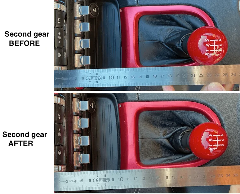

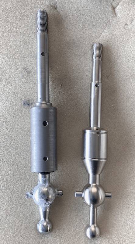

Yesterday I installed the Steeda Tri-Ax shifter. Not the complete assembly that they call the "race" version, but just the shifter itself, which is sometimes refered to as the "street" version. I went with the light version because it was a bit cheaper, a bit easier to install (no need to drop the driveshaft), and I didn't have any actual problems with the stock shifter that the full "race" version might have alleviated; I just wanted a shorter stick with a shorter throw.
The installation was quite difficult due to lack of space, and the fact that I had to do it on ramps didn't help either. With a lot of help from my brother in law, who's as big a car enthusiast as I am and is even more handy with tools than I am, and having access to all the tools we needed (and high quality ones at that), it took us the best part of four hours.
Try as I might, I could never find direct comparisons between the stock shifter and aftermarket ones. Descriptions abound, but actual pictures to show them side by side seem to be as rare as hens' teeth. So I thought I'd take up the slack.
Left: stock. Right: Steeda Tri-Ax

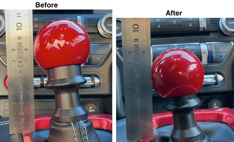

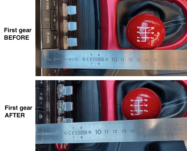

Also, everybody talks about the throw being shorter, the knob sitting in a better position, etc., but exactly how much shorter? How much better? It's a mystery. So, I thought I'd answer these questions.
This is how high the knob sits above the shifter base surround:
Distance from the dash in first gear:
Distance from the dash in second gear:
The result is awesome. Not only is the throw much shorter indeed, but there's something about the way it feels that I can't describe in words. I thought the stock shifter was fine (and it was), but this one is in a different league. Each shift feels definite and precise and is accompanied by a satisfying mechanical sound. I love it.
It does, of course, take a bit more effort to shift. But not overly so. It's fine after you get used to it.
