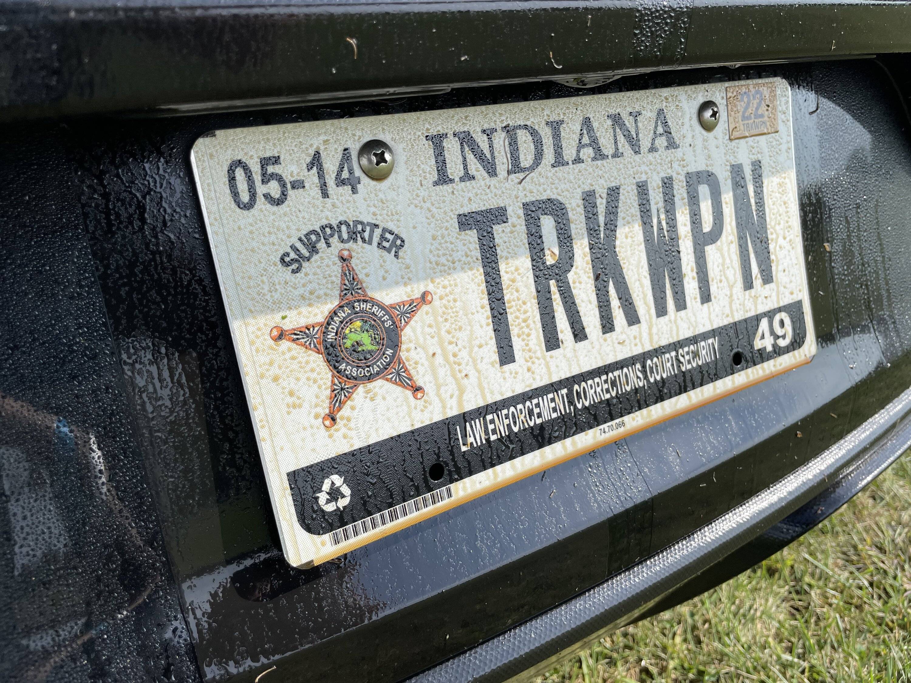

You’ll probably be fine but who knows. I had mine in for 6,000 miles (4,000 track miles) before it was ejected. Seems it happens to everyone when near redline, going into a big braking zone, then downshifting. From the video of mine happening, the plug popped out at the exact moment of the downshift. I’ve posted it a few times before but here it is again as viewed by the Camaro I was passing.
There was an impressive amount of oil on the rear of the car afterwards.
