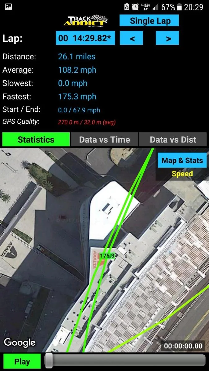

175.3 is what race render recorded using gps off my phone. It might have had a little more (maybe 180 if you stood on it until fuel cutout). Right about the time you cross the finish line in Daytona on the front stretch, its time to start thinking about turn 1 into the infield.
Very impressive and appreciate the detailed post.
At 175 MPH did your car feel quite stable and what kind of tire pressure (F&R) were you running during that event?
