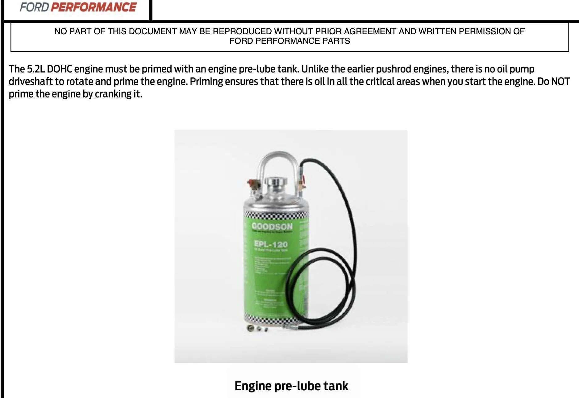

You can hold the gas pedal down for flood mode
but you're still turning the engine over so what is that accomplishing?
you also can't prime the engine that way because of the style of oil pump it uses
it's not like the old days where you could stick a drill down the distributor shaft hold and then get oil flowing without turning the engine itself...

why doesnt priming it work?
Because the starter doesn't spin the pump fast enough
you're also still turning the engine over..."priming" doesn't actually turn the engine it just pushes oil

Your engine won't be "dry". The oil sticks to everything. Even after sitting for a year or two. The only time you would need to prime the engine is the very first time it's started after being assembled
