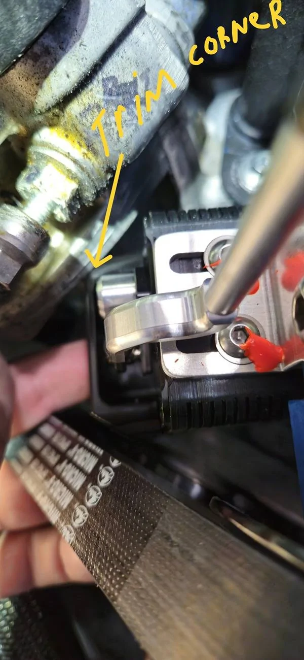

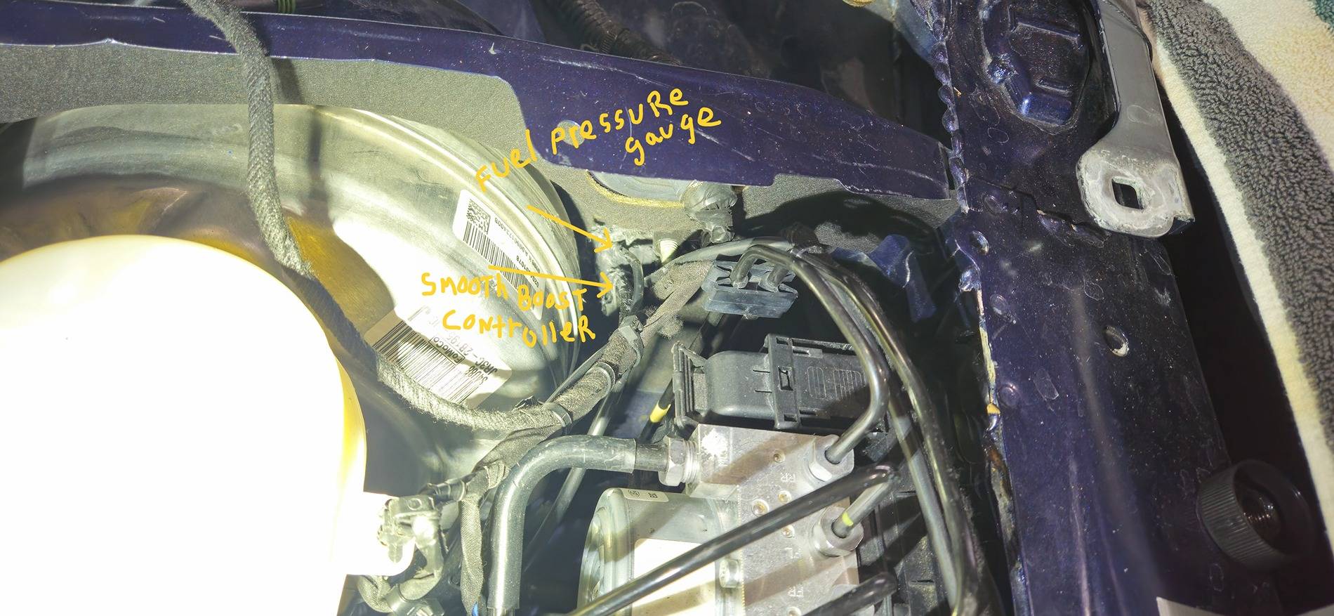

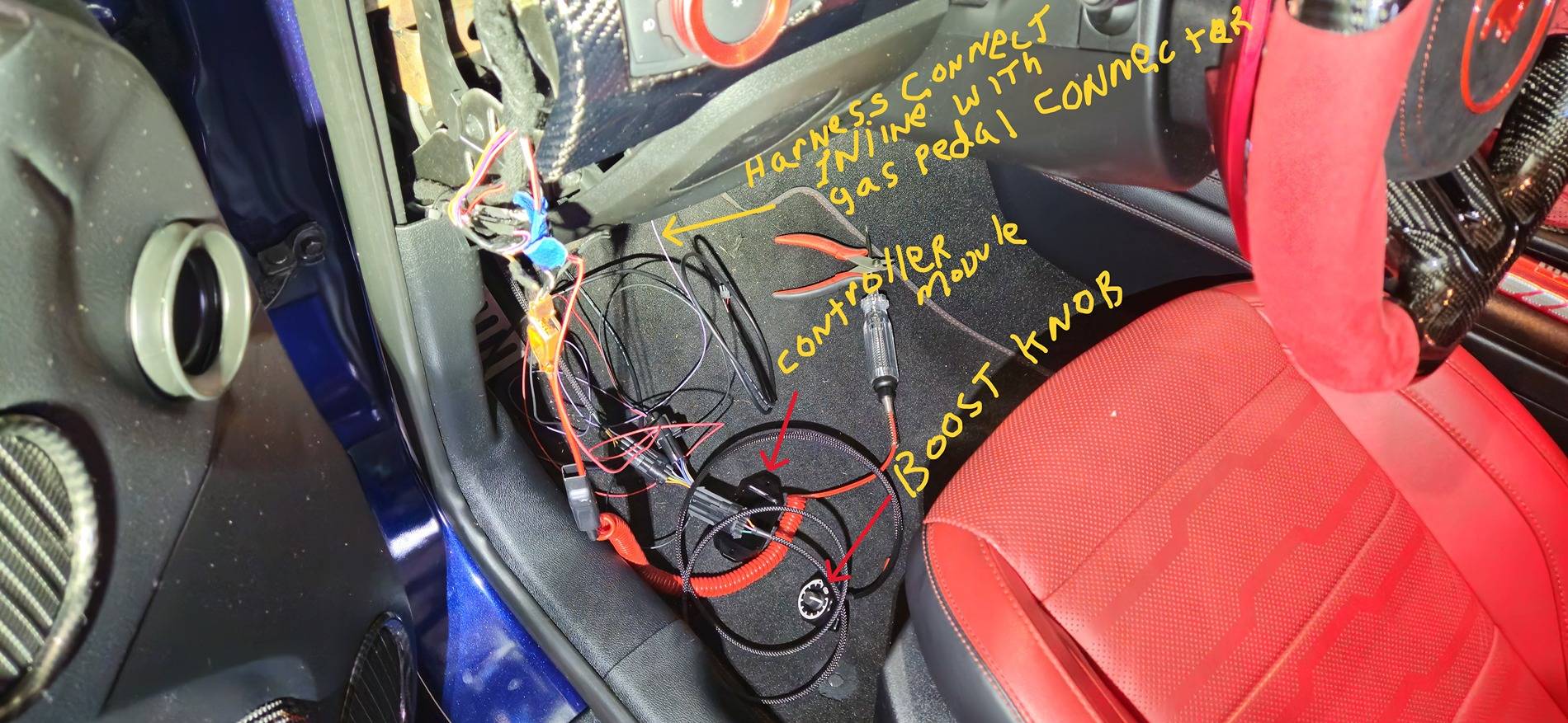

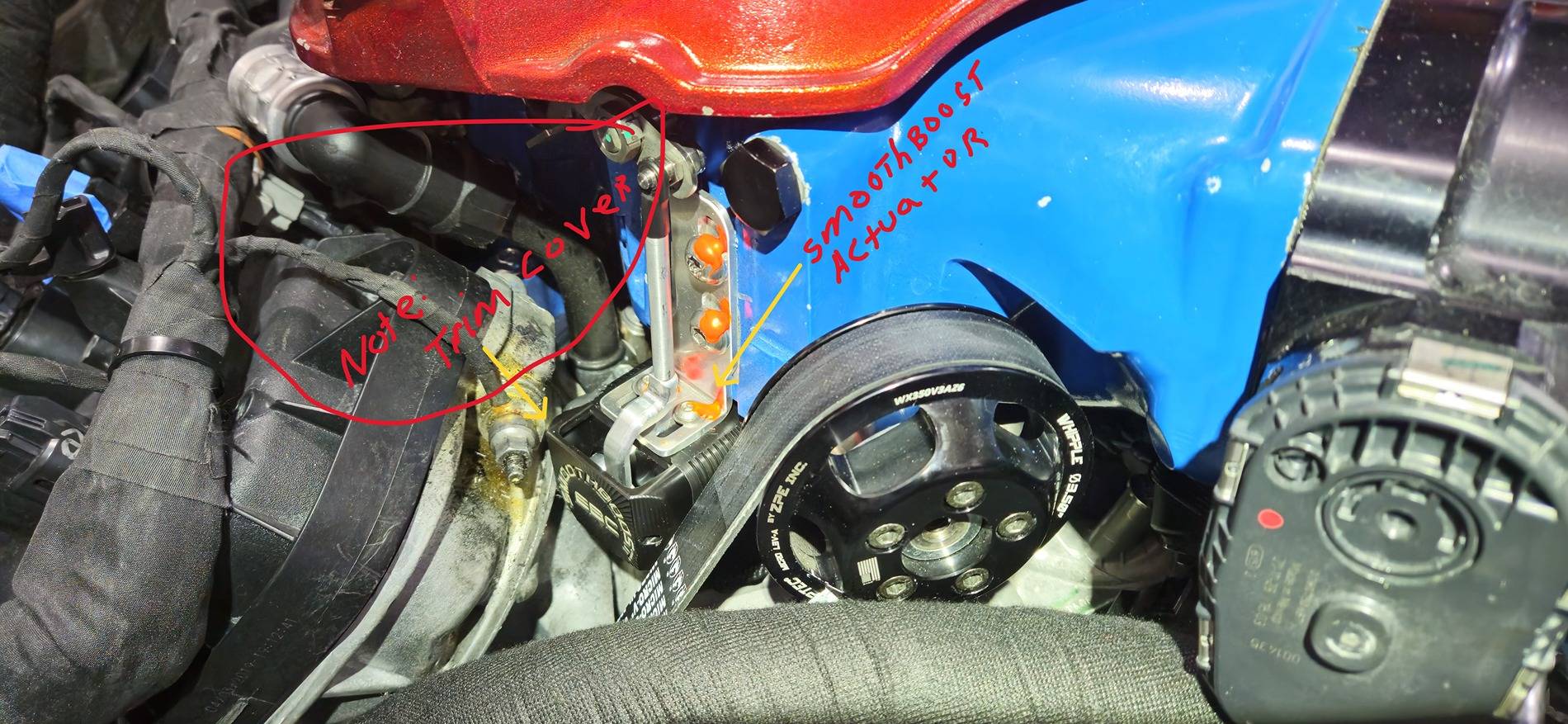

Here is the start of my Smoothboost Controller Mod. Easy install except you will have to trim the actuator cover on the back side to clear the head.

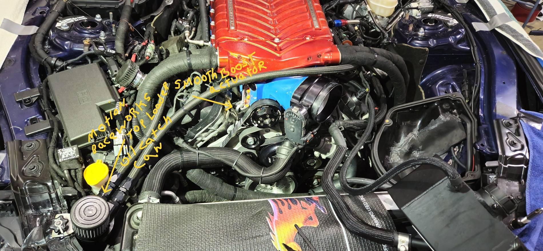

Here is my Motion Raceworks Top Load stand alone Oil Separator. Does not vacuum into the intake.

Looks nice! Can you share some details on how you mounted the catch can? I’ve been wanting to add one, but was not sure the best way to mount the Motion Raceworks can.

I can But, I do not have a stock hood otherwise I would have made a bracket and mount on the left side which has more room/options.

Thanks. I have a stock hood and know UPR mounts theirs in similar location.

I can take more pictures. The steel brackets which came with it I flattened out, cut about 1" off of none mount side, drilled a hole in the right front frame and pressed in a m6 rivet mout and that is how I secured the assembly. I had then make my kit with all fittings. All I had to do was cut the steel braided nylon covered line to the length I needed to vent both sides.

That’s helpful, thanks. The rivet nut was a good idea rather than trying to use some pre-existing hole to mount it too. Any pics would be great.
What plugs are you using for the whipple intake side?
