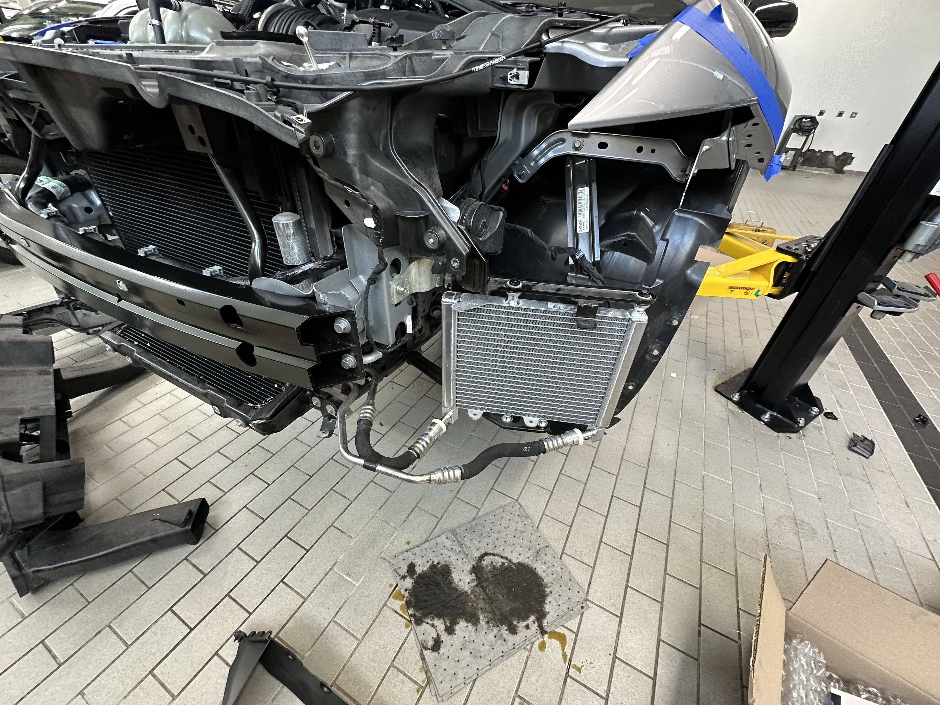

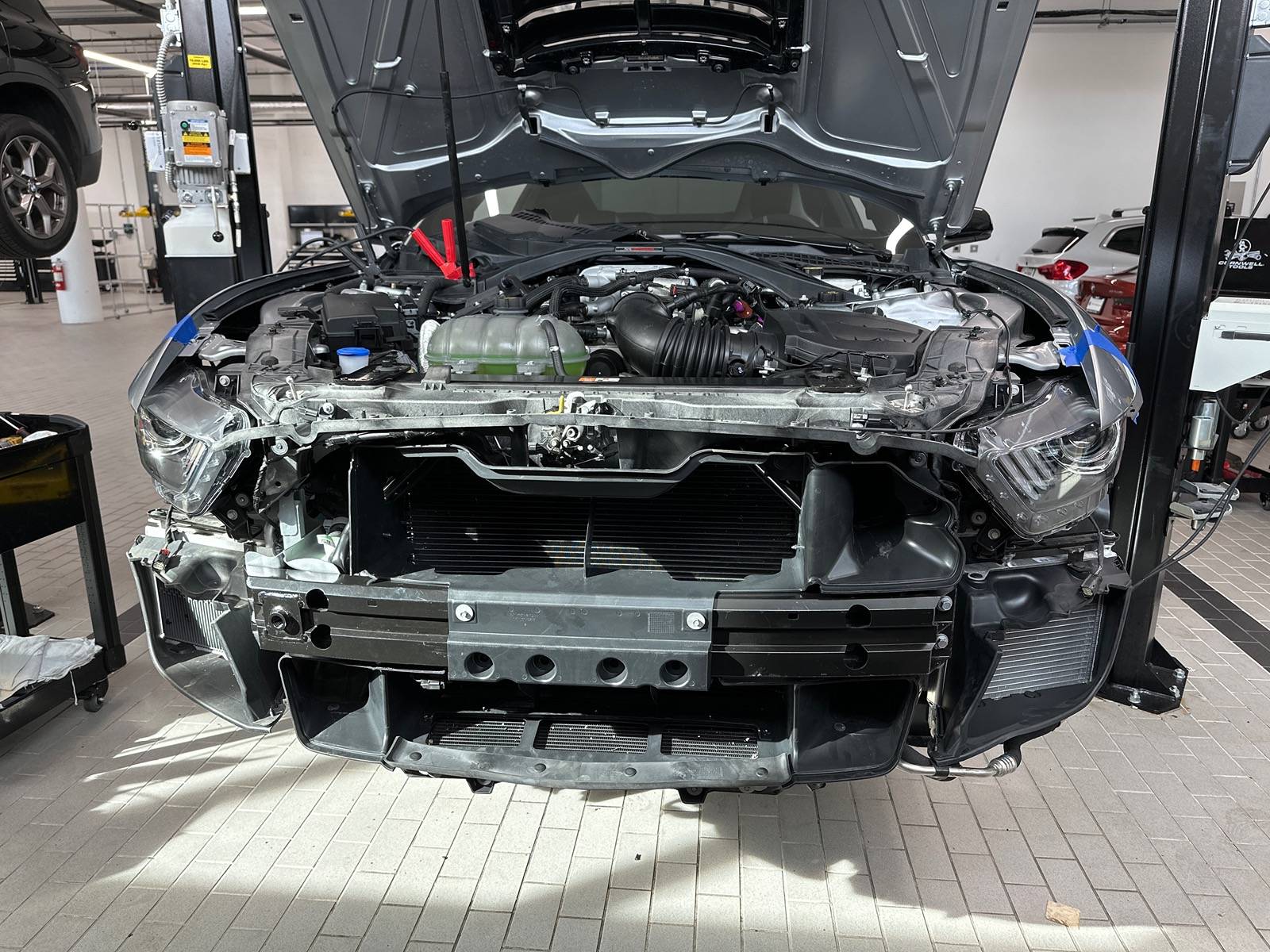

Hey, I’m replacing the driver oil cooler on a 2020, is there a procedure to prime the oil circuit after replacement? On the BMWs there is a process for any time the oil circuit is interrupted, but not sure on the 500. Thanks in advance!
