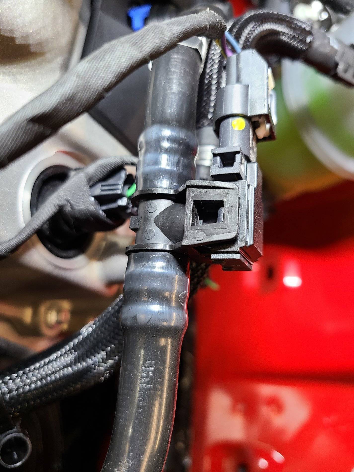

Does anyone know what that electronic device is on the driver side vent hose running to intake? Valve? Sensor?
It looks like all the other temp sensors under the hood. Might be where they pull the IAT as there is no other temp sensor in the air tract.
Will have to check the manuals.
Edit: It’s called the Crankcase Pressure Sensor. I’ll post the manual extract in a bit.

Attached what the maintenance manual has. Requires another document [Powertrain Control/Emissions Diagnosis (PC/ED) manual] to describe how it works. I don't have that document.
Wonder if it works like an on-off switch? e.g. When it senses pressure above ambient, the PCM takes deliberate action to protect the engine....?

The PCV system on some vehicles will include a crankcase pressure sensor to detect a disconnection of the fresh air hose. A disconnection of the fresh air hose would allow the discharge of crankcase vapor into the atmosphere while the engine was under boost. The fresh air hose connects the intake air system to the valve cover, with the crankcase pressure sensor mounted in the fresh air hose. The PCV monitor will detect a fresh air hose disconnection at the intake air system or the valve cover, by monitoring crankcase pressure sensor changes during engine cranking, and driving with higher intake airflow.

So is it purely an emissions thing?
