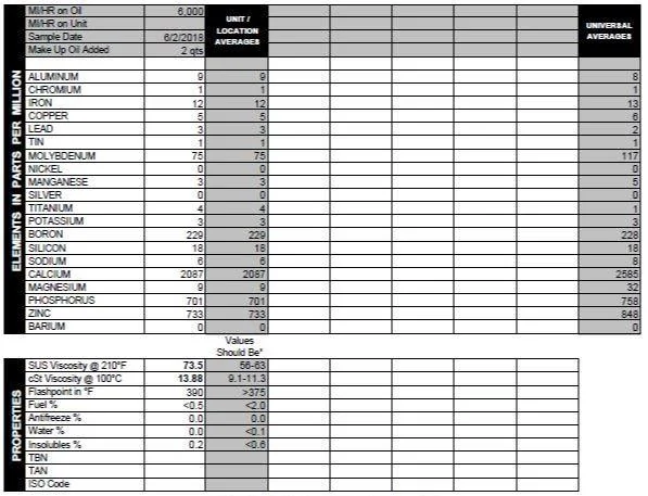

What was their commentary on this analysis with respect to the few slightly elevated readings?
Are you talking about the Phosphorus (P), Zinc (Zn)? These are anti-wear/anti-oxidant additives which acts as a film to surround metal parts, helping to keep them separated.
Magnesium (Mg), Calcium (Ca), Barium (Ba) - A detergent-type additive which provides some alkalinity to help neutralize acids formed by fuel combustion.
so the elevated numbers are good.
And the Silicone?

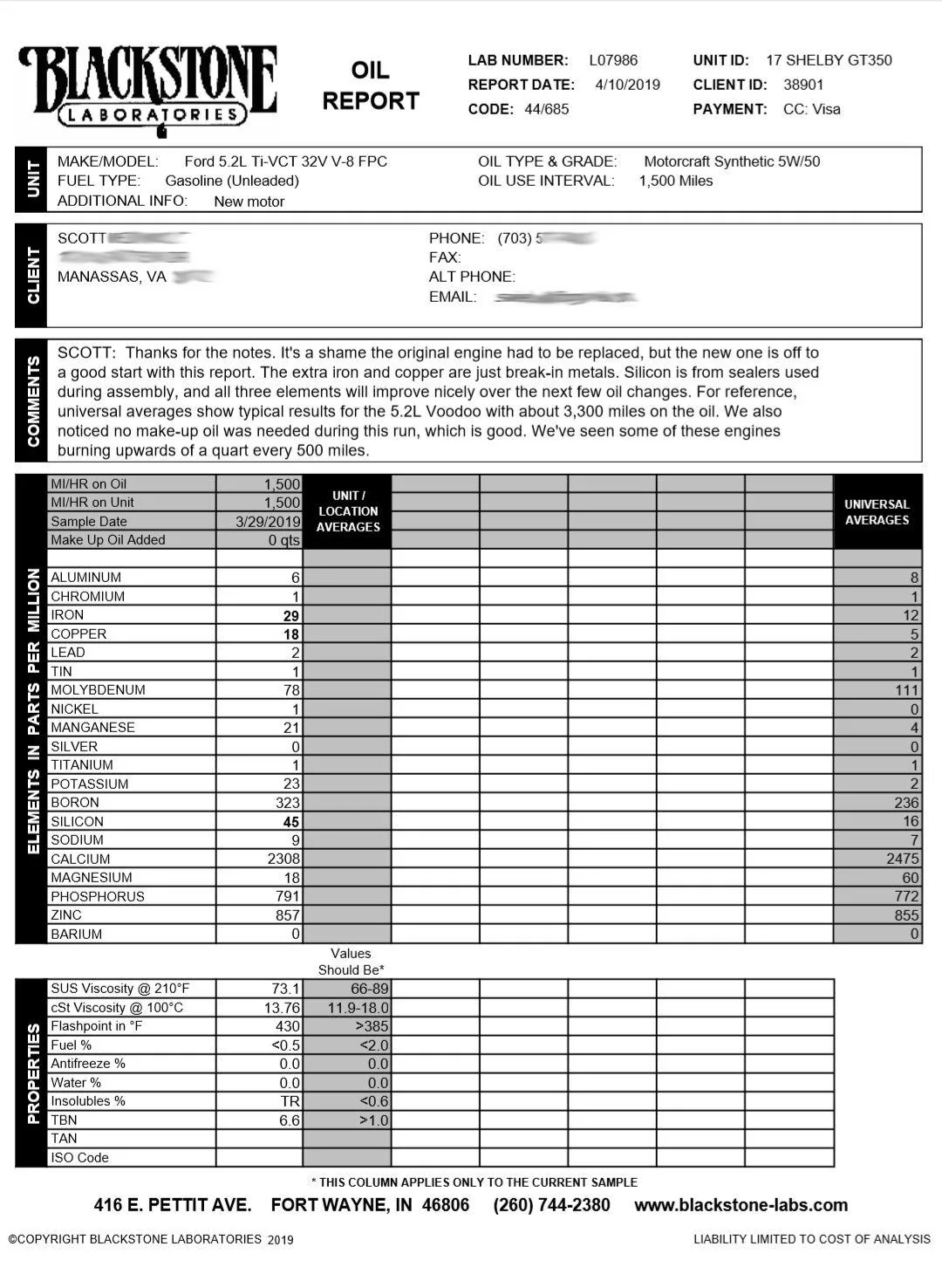

And the Silicone?
that explained in the comments
Blackstone Oil Report said:
SCOTT: Thanks for the notes. It's a shame the original engine had to be replaced, but the new one is off to
a good start with this report. The extra iron and copper are just break-in metals. Silicon is from sealers used
during assembly,
and all three elements will improve nicely over the next few oil changes. For reference,
universal averages show typical results for the 5.2L Voodoo with about 3,300 miles on the oil. We also
noticed no make-up oil was needed during this run, which is good. We've seen some of these engines
burning upwards of a quart every 500 miles.
Remember this is my first oil change and test on the New Engine.
