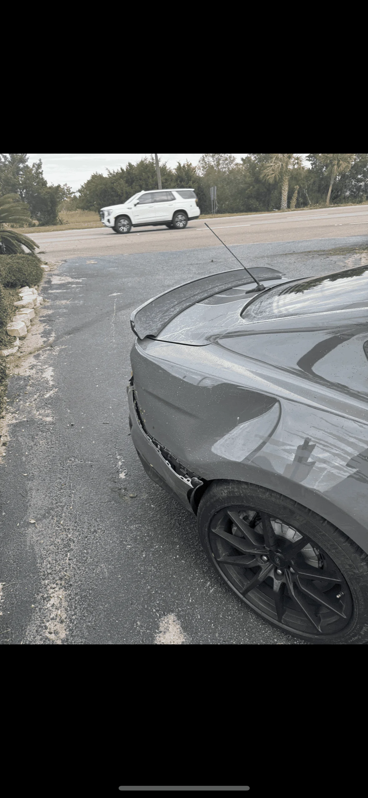

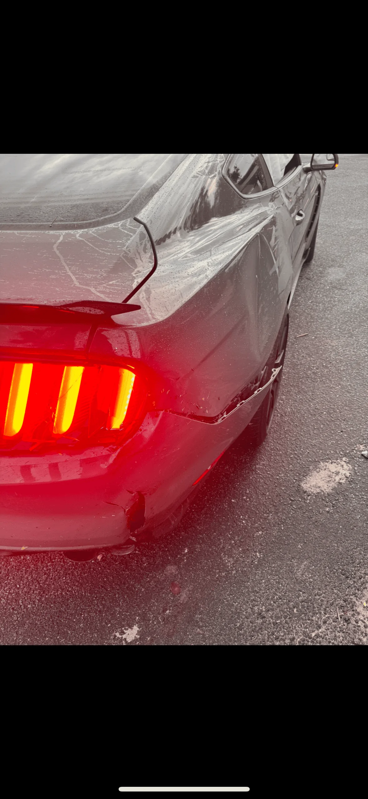

Hello all,
I recently got into an accident that resulted in frame damage (front crossmember), the replacement of a quarter panel, and a few other things. the airbags did deploy.
The body shop is trying to tell me the costs will be around $38,000. Has anyone else been told the same with similar damage?
Below are pictures of the visible damage

Have they given you an itemized list of the damages? That photo is probably deceptive, and looks minimal. Airbags going off is never cheap.

$38,000 is the ā€œtotal itā€ number they give to insurance companies. Frame damage is incredibly expensive to fix on new cars though, quarter panels are not easily replaced properly, and airbags can be $1k to $2k a piece. So around $20k wouldn’t be unreasonable imo to do the job 100% correctly using oem parts and methods.

If the damage to the frame is in the front, show us some pictures of the front of the car how it sits right now.
I haven’t had the car since the accident. the front was sitting perfectly normal, in fact, when the cops got there they had to ask where i’d been hit.
That's interesting that the front of the car has extensive frame damage, yet there's no actual damage to any of the front body panels. The rear of the car has body panel damage indicating that's where it was hit. How does one damage the front of the car by hitting the back of the car?
I'd want to go look at the car personally.

That's interesting that the front of the car has extensive frame damage, yet there's no actual damage to any of the front body panels. Yet the rear of the car has body panel damage indicating that's where it was hit. How does one break the front of the car by hitting the back of the car.
i pretty much got out maneuvered by a truck. he clipped the back end and i spun out into a curb, that’s why the front has frame damage.
