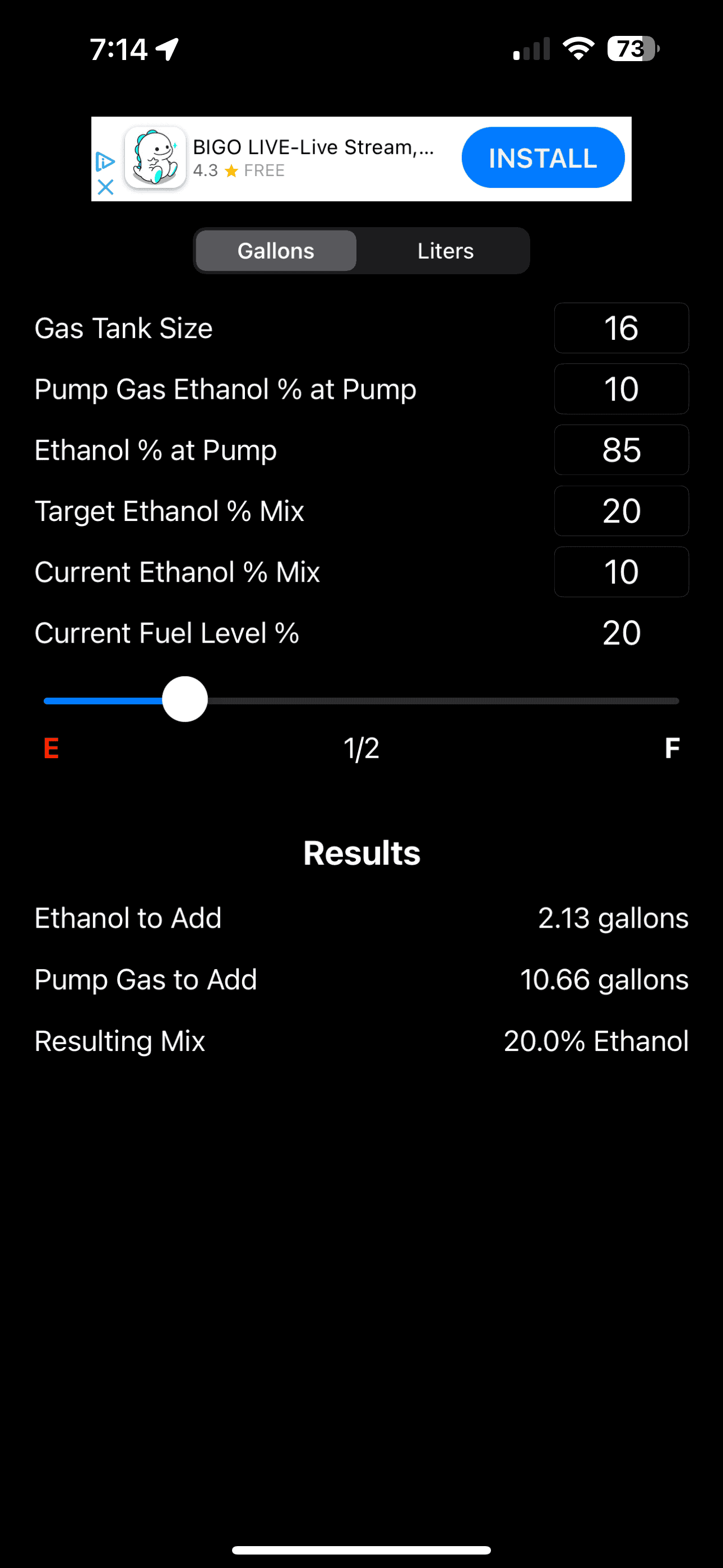

I just run e20 on my 93 wengerd tune. It adds a bit of octane and holds down any weather or temp related knock. No need to do anything to the tune. The car runs in closed loop at all times and the widebands will add fuel via the fuel trims as needed. My car was perfectly happy on e20 with LOADS of headroom for a bit more if I wanted.
Wengerd looked at my logs and said I was only adding like 6-10% at any given time through the fuel trims to offset the extra ethanol. But the car was rock solid, seeing no knock. Being a car with factory widebands, you could theoretically do this on a stock car and gain a bit of octane. I basically do 2 gallons of E and then top off the tank with 93. Car is very happy on that.
What is E20? Im also wengered Tuned on pump 93 with a stage 2 prochrger.
Is it mixing 2 gallons of E along with 93? My car sits most of the time.

So find a gas station that has both E85 and Pump 93 and pump 2 gall of E85 and the rest 93? Would this be considered a "flex fuel" set up or requiring an updated Tune? I did read all looked good on the logs.
Yes that’s exactly right. And no tune update needed. Your car will adjust the fuel trims accordingly to account for the added ethanol as observed by the widebands. The added octane will have a mild cooling effect as well as adding octane to fight spark knock. It’s like running 94/95 octane. And it’s mild enough to where the car has the ability to correct for it. I’ve discussed this at length with Wengerd and he’s all for it. You might see your trims +10-15% but the car is more than capable of handling it. It should run a bit smoother and with no knock.
