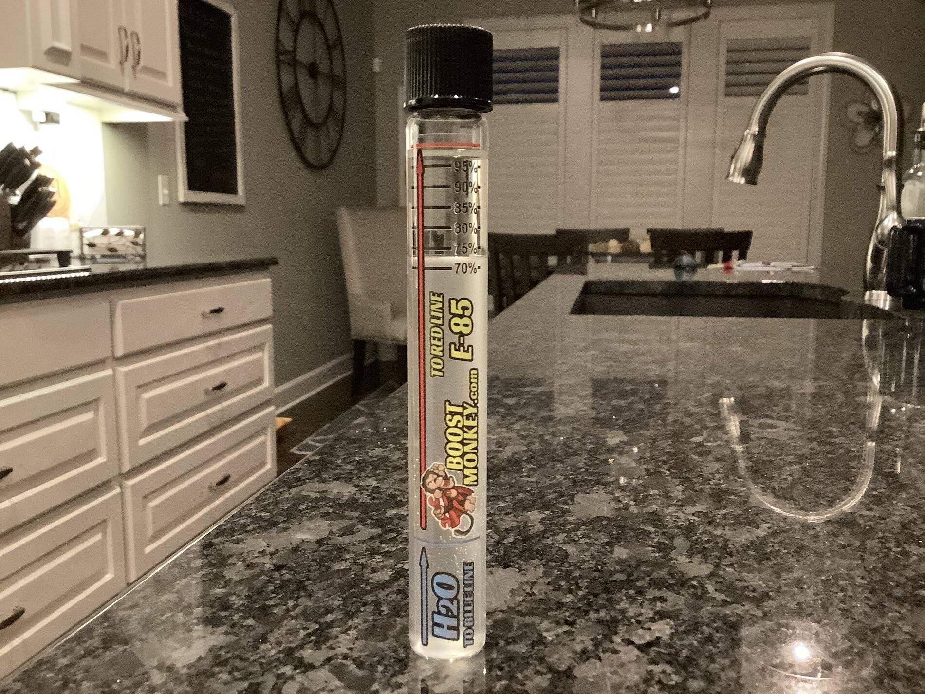

I just put my car on the Flex tune today for the first time and the nGauge read 65.5%. I backed that up with a test kit when I got home and here is what it read (a difference of 7%).
Yeah, it's definitely not going to be a 100% EXACT match and what your nGauge will end up reading may also vary with what you do with the vehicle once you do fill it up with E85 and then start it up.
For the most accurate reading, you need to let the vehicle idle for a few minutes and then drive normally without doing any crazy WOT hits. Once it locks in, then you can go rip on it. Either way, you'll probably see some variance between what the tester might say and what the nGauge ends up reading. The only true way to get a 100% accurate reading and the computer to utilize that is a stand-alone system i.e. MoTeC.
