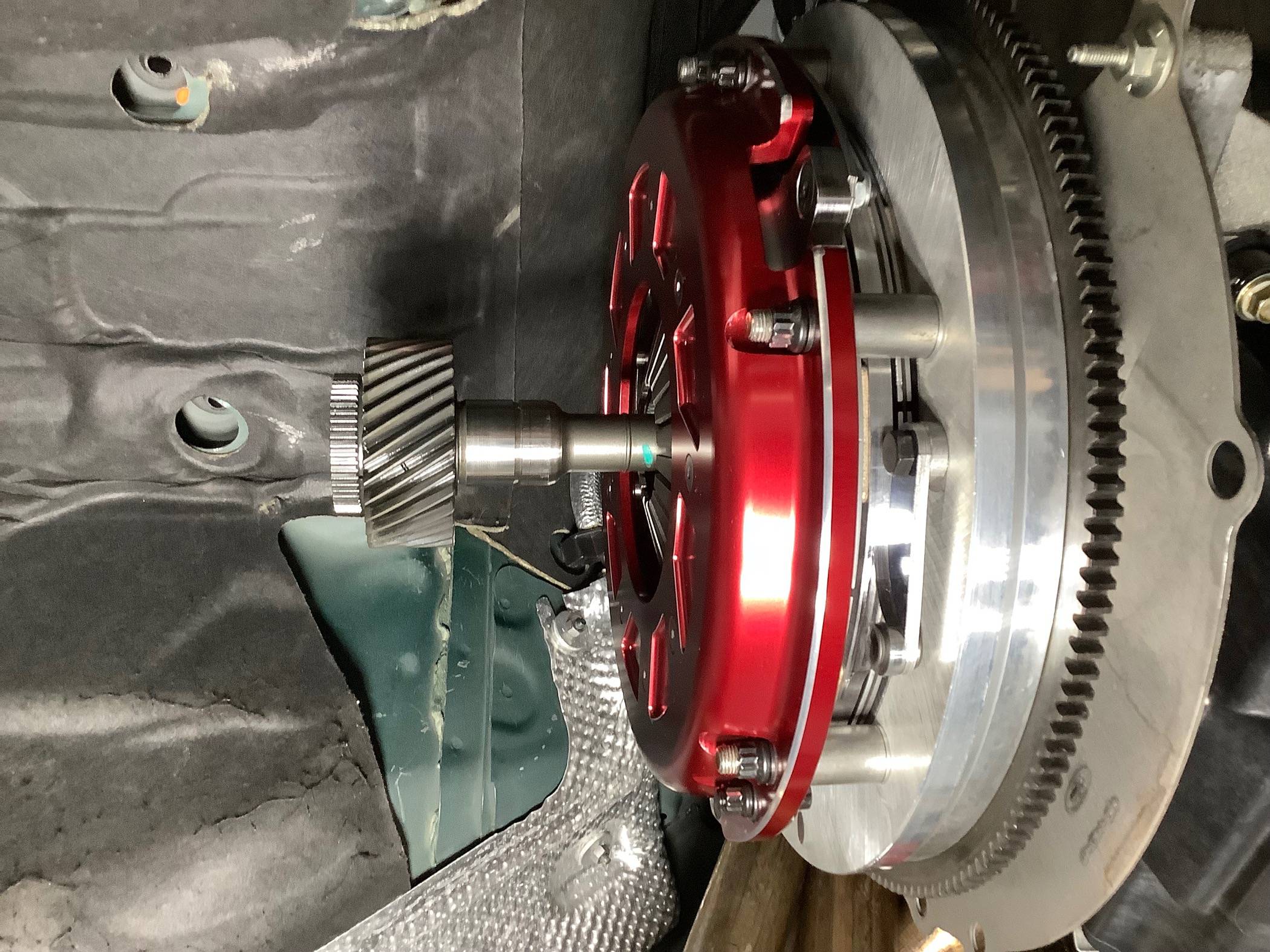

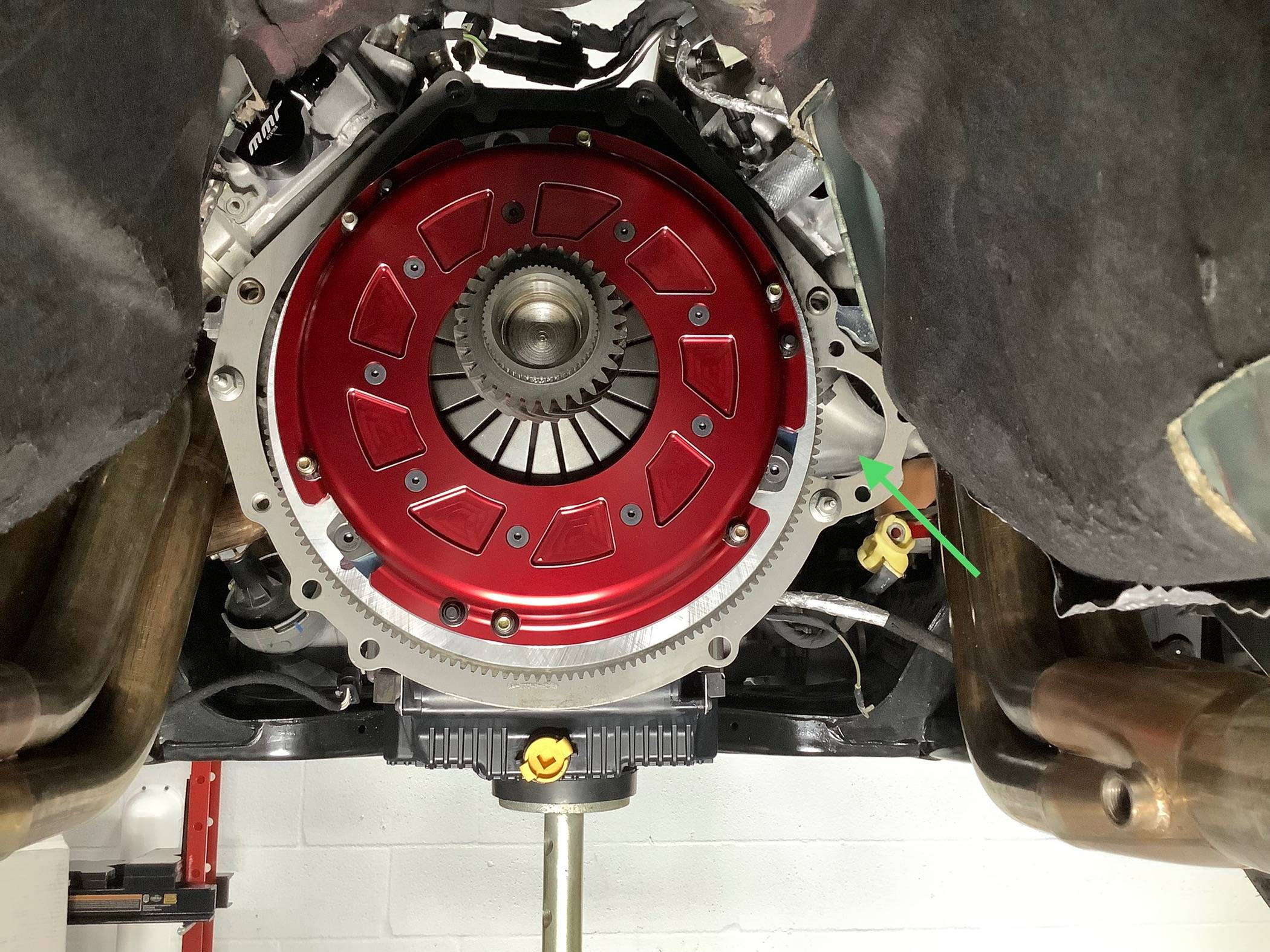

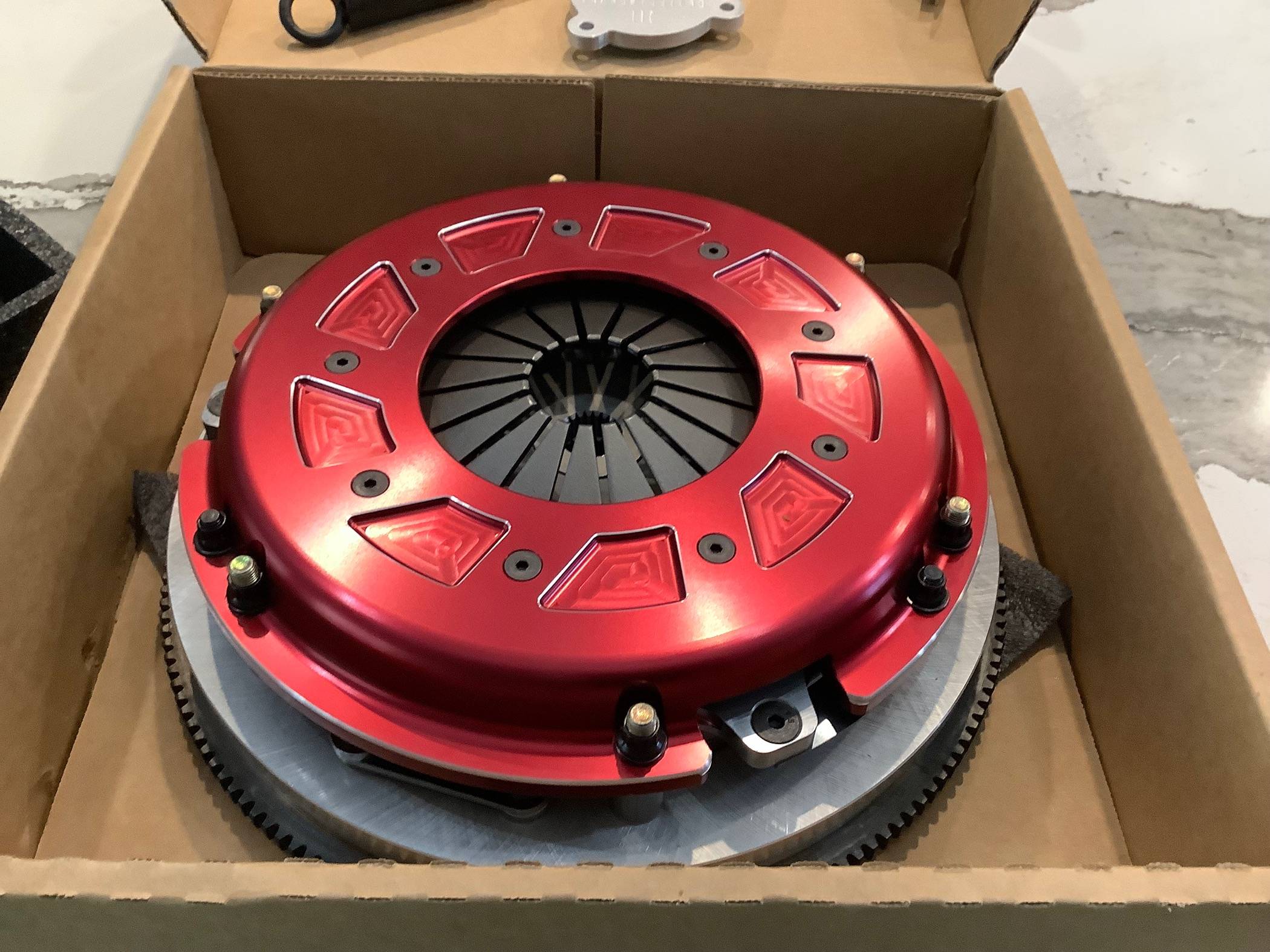

You might as well put a good one in there if you can get the dealer to agree to install it. I put a Ram Pro Street Twin Disc Cerametallic clutch in my 2019 and if has been a great clutch. It felt different initially (on or off), but now that I’ve put a couple thousand miles on it, it feels great. No increase in pedal pressure either. Be sure and I stwll a new slave cylinder while you’re at it, so that you don’t have to go back in and do it later.
NGOT8R
Jul 19, 2020
154
9,372
7,875
Adrian
2019 Bullitt
Oh yeah, I forgot to mention that high rpm shifts aren’t a problem at all. I’ve been down the drag strip numerous times on this clutch and it hasn’t missed a beat.
