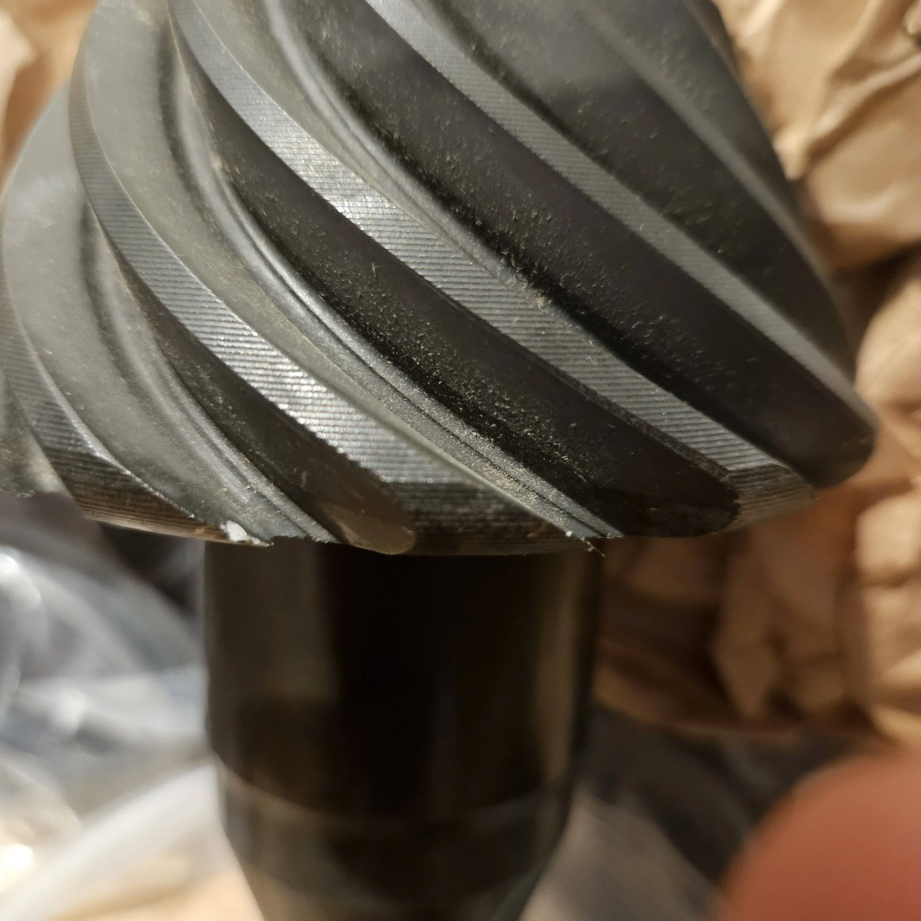

Received my ring and pinion today. Some damage will it work

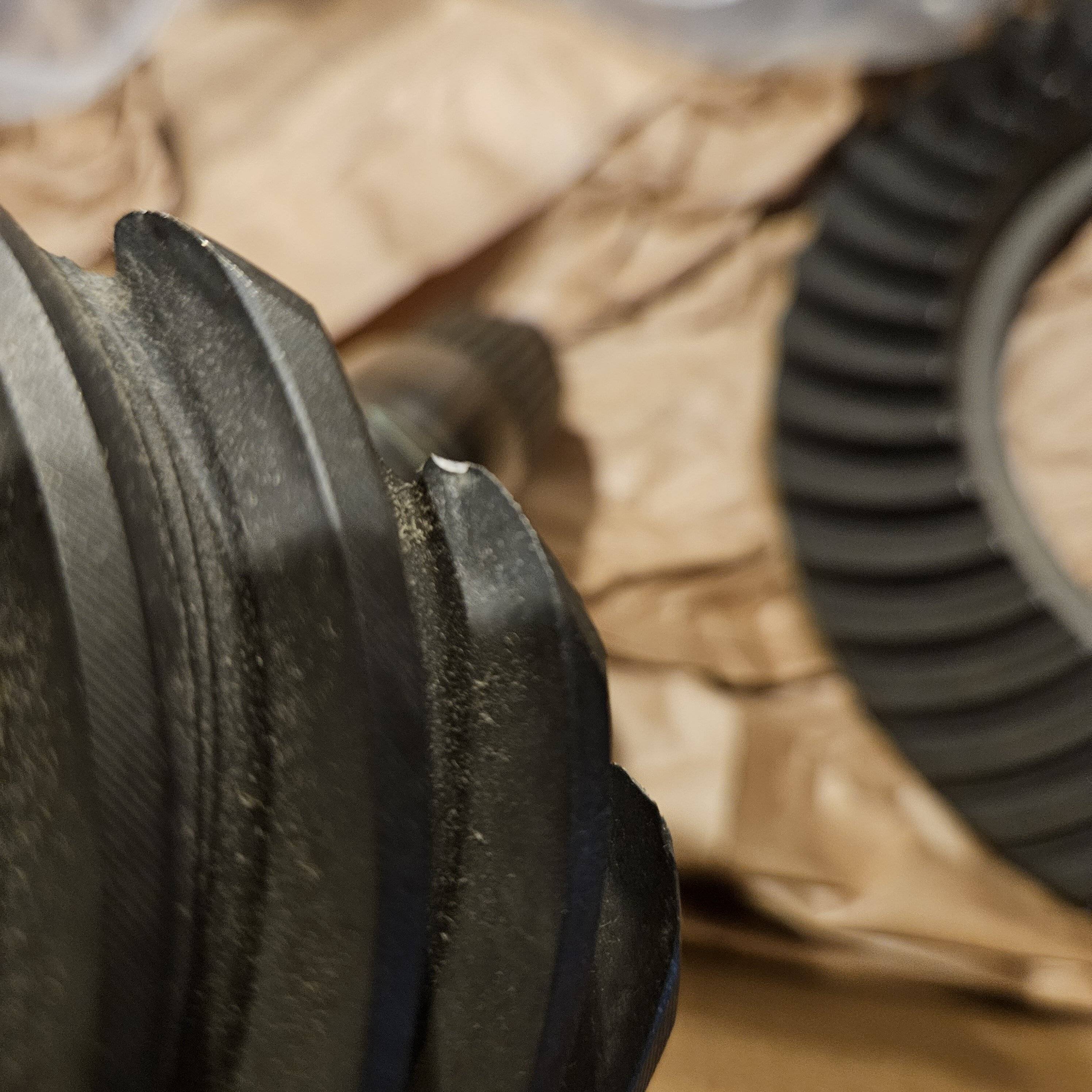

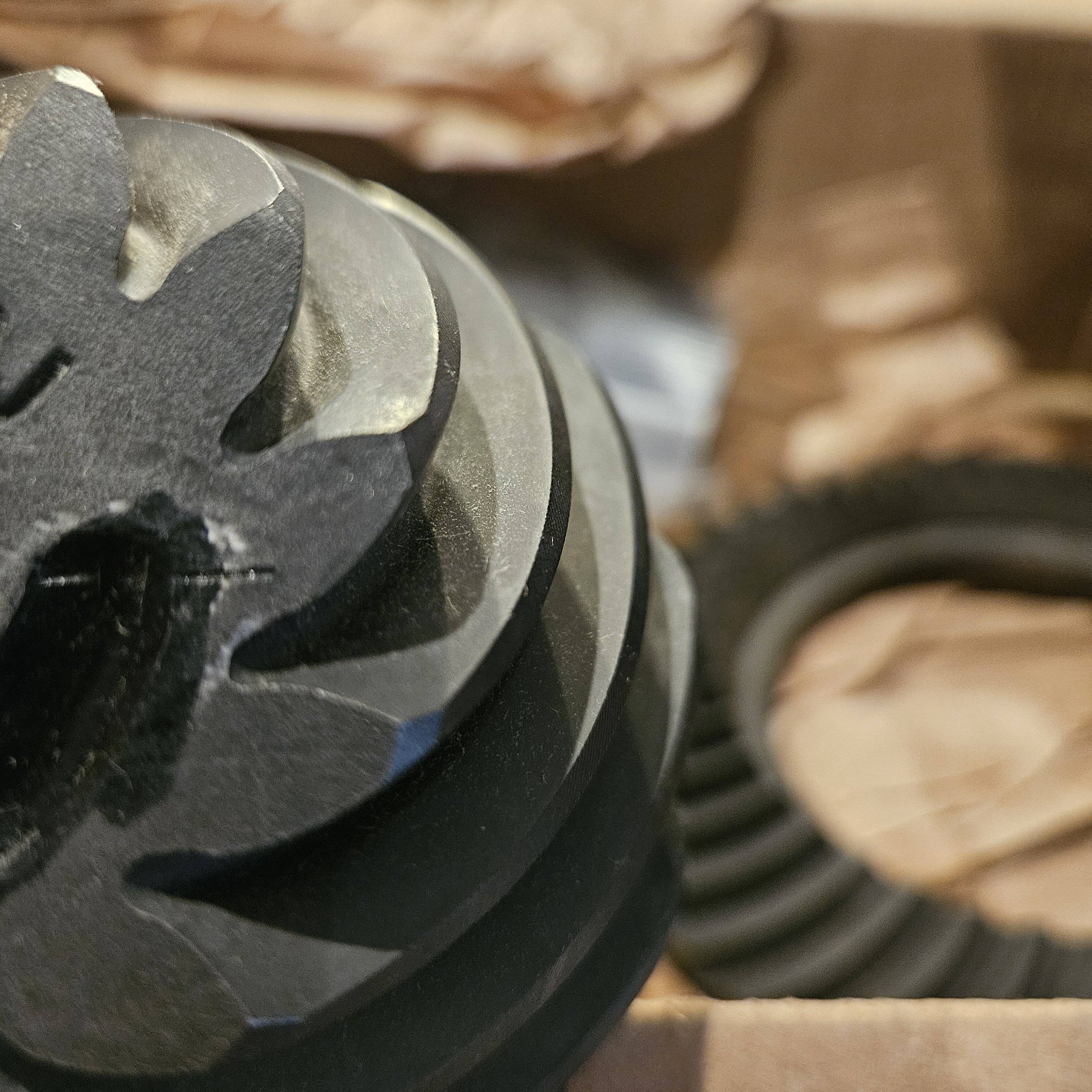

Ordered a 3.31 ring and pinion from American muscle it was a takeout of a demo car. They packaged poorly. Bottom of pinion has a small chip or 2. Is it toast or can I use them. There gonna refund 7 to 10 days after I ship it back, but I still wanna go from 3.73 to these. Can I clean these up or just go ahead and return them?
I would return them just because I'm fed up with AM's hit or miss packaging of late.

It‘ll still work, but you should at least deburr that chipped tooth with a Dremel.

Sending it back would be the proper thing to do though. I went through the same thing with some damaged trsnsmission gears. The company I was working with replaced the damaged gears at their expense .

Small as the imperfection is, considering the expected service life of the part, I'd be concerned it is now a source of physical cracking and fatigue. Additionally, whatever tempering was accomplished to strengthen the metal has been compromised in that area.

Your right. I'm sending it back
