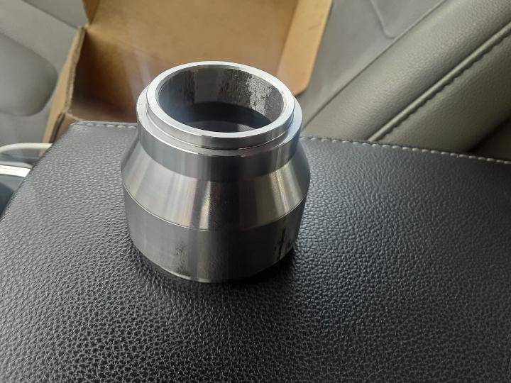

The pinion is angle cut and when you think for a moment about what the physics are, the ring gear is trying to push the pinion out of the housing towards the driveshaft.
High HP and shock loads (like the dragstrip) could have the potential to crush/collapse the sleeve, loosing the pre-load and correct pinion depth.
All it takes is several thousands or less.

Redd
GT500 & other heaps
Crush sleeves are not as good as they were yrs ago. (as hard I should say)
We did rear ends for decades professionally, & found it was better to put solid pinion spacers (& the solid style w/shims were our preferred type) in every build, except totally bone stock engine 3rd member's.
Crush sleeves in general were once much harder to Crush yrs ago vs last 10/20 yrs it seems.
I haven't done a Super 8.8" that I recall, so don't know what OD/ID diameter spacer needs to be.
Might hav to make one. We did on occasion.
This is a more common problem on drag cars than street/road race car 3rd member's.
If u need more help or info. Let me know.
We can giv u several other good tips if u like them.

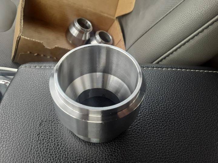

We had a machine shop make up 4 solid sleeves….. so far so good, but he hasn’t been to the drag strip yet. We also realized all his hard suspension upgrades probably contributed to the added noise by a large amount.
