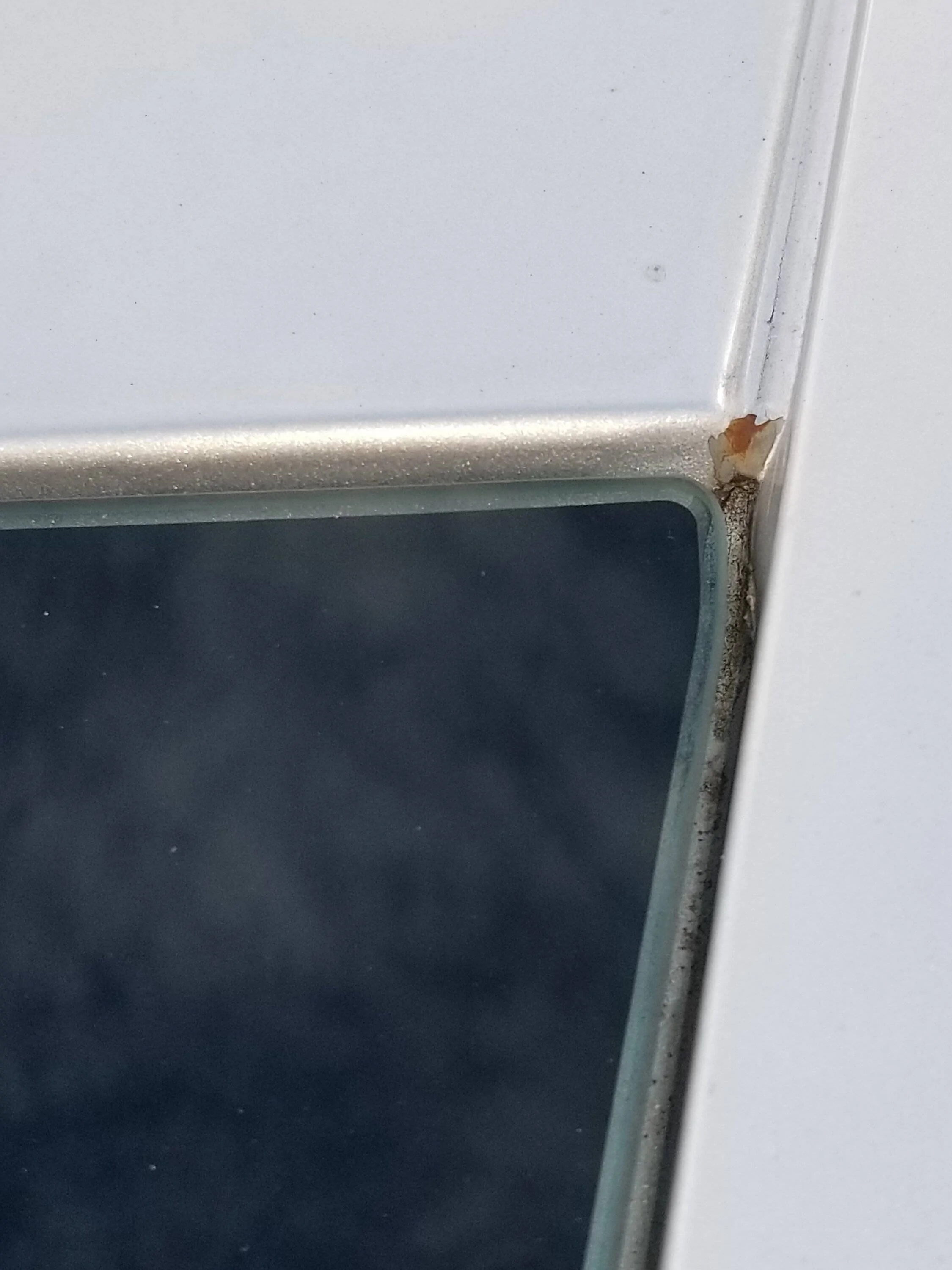

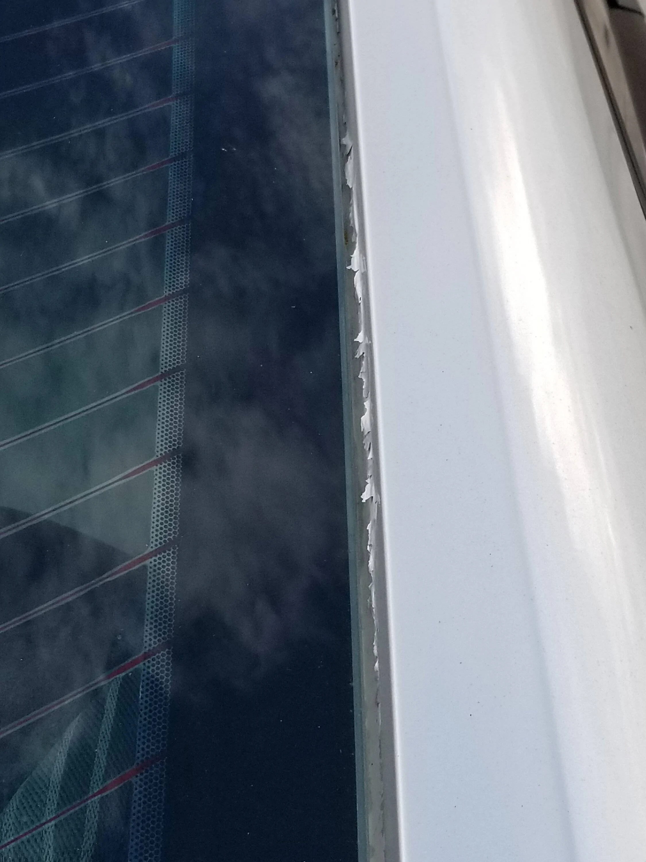

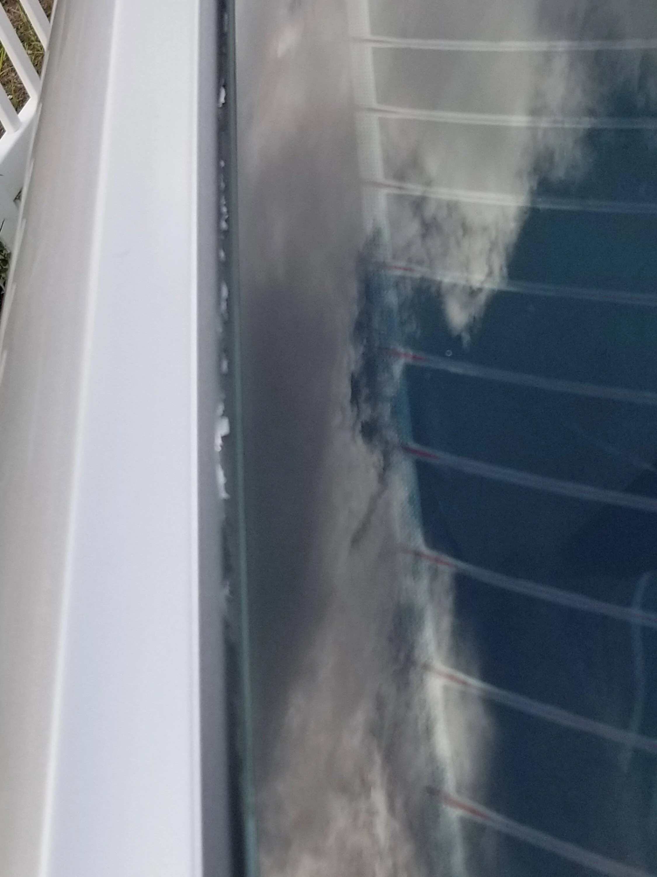

2016 rear window channel peeling, cracked and spot or 2 of rust, out of warranty. Ford won't help at dealer. Repair estimate $1000 to $2500 made me a little sick... called ford customer service # no help... wanted to share my pain...🤣

Brutal, there's that Ford quality. My roof seams have started peeling since I last posted here, complete with a bit of rust. I can see the start of that in your pictures... especially the third one.

I wonder if this is from chassis flex? Does the glass edge show any paint transfer or anything? Or is this just a paint prep issue (i.e, poor quality adhesion).

Nothing on glass I can see. Appears to be prep issue. Dealer said the paint robots focus on outer panels but they are skimpy on the channel areas with prep material. Forgot the name of the undercoat prep material he mentioned.
