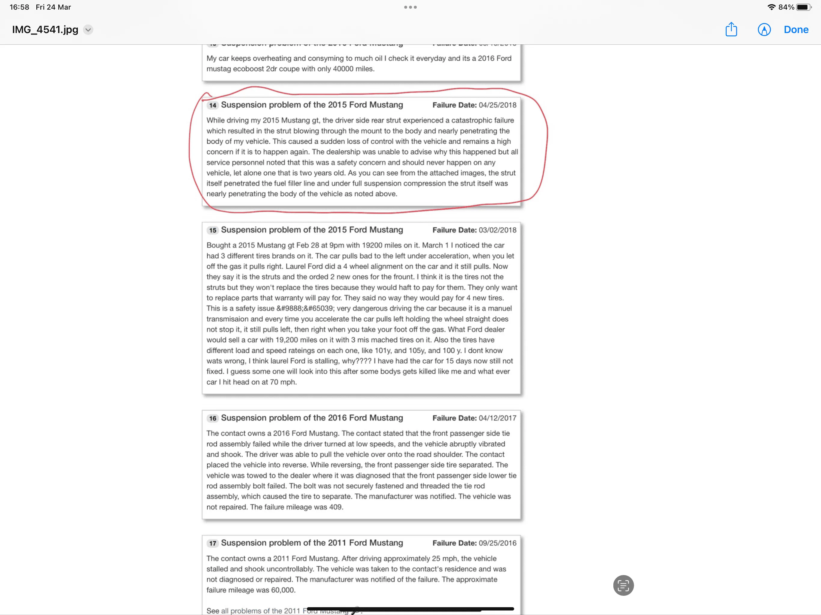

Thanks for the info - I didn‘t really expect Ford UK to do anything but when i sent them an email this morning I got a ‘cut and paste’ email back within 30mins telling me they’d reviewed and consider matters & wouldn’t assist - they really must have considered & review within 30mins!
I found this report on another website which got me thinking it might be an issue so thought I would ask around. I mentioned to Ford that I was aware of ‘aftermarket’ stronger mountings being avaialble 7 that there must be a reason for that.
