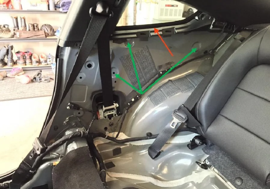

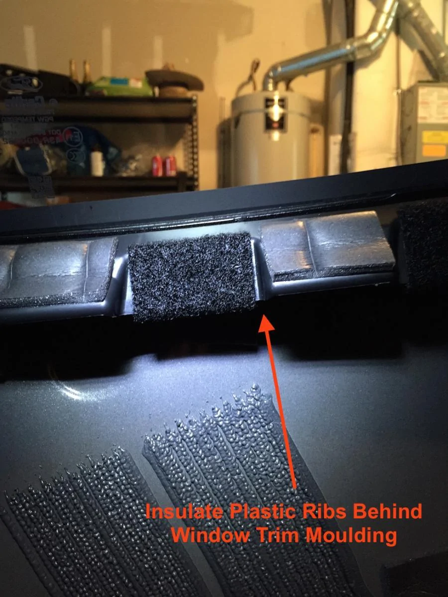

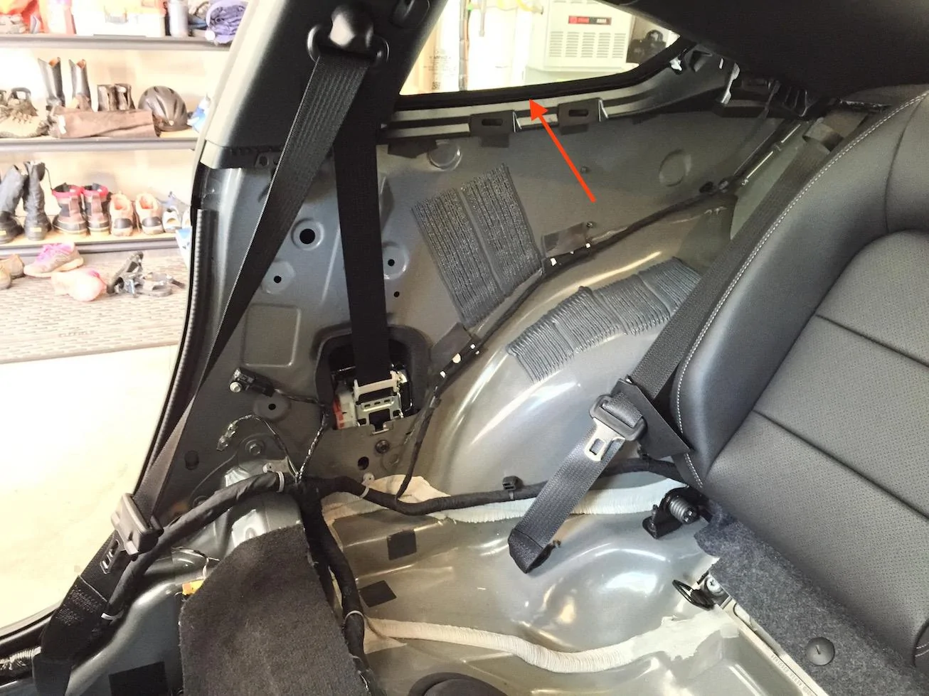

So..... I finally got around to pulling my rear seat to see if it was the hard foam pieces that were making my rattles at highway speeds when I'd hit a sharp bump. As soon as I got the seat out, I saw pieces of hard foam on the floor pan (passenger side), I knew that couldn't be good so I reached up inside the panel to see if I could feel where they came from. What I found was the entire foam piece was moving around freely (not attached), just to be sure I checked the driver's side and it was attached (hence no noises from that side). I went back to the passenger side and pulled the piece out.... The small broken pieces I found earlier were from the bottom of the main piece, specifically the part at the bottom of the mounting holes. The locking rings were on the inside of the plastic panel but were pressed all the way against the panel so I couldn't get them off, not without causing additional damage. So my fix, since I'm sure if I took it to Ford they would blame me for the broken part (likely rushed/piss poor installation at Flat Rock) was to take the advice of someone on this post (not sure who actually said it...) and fill the gap between the panel and the hard foam with some cloth... I used a small towel. I reinserted the seat and took it for a test ride.... Yippee! Almost all the rattling from the right rear has ceased!Just the presence of the foam in the large void helps with acoustics, or rather eliminating them. Think of that area behind the panel as a speaker box. More volume allows sound pressure to make what we call noise. Road noise, a small stone hitting the wheel well, etc.. I'd wrap the foam in something and reinstall it. Since it is foam, use glue and some pins or trim nails?
