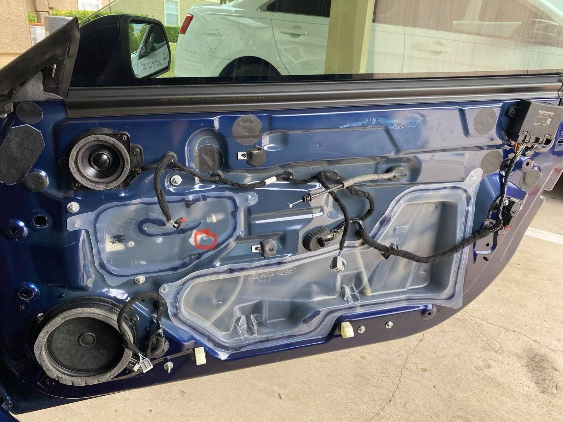

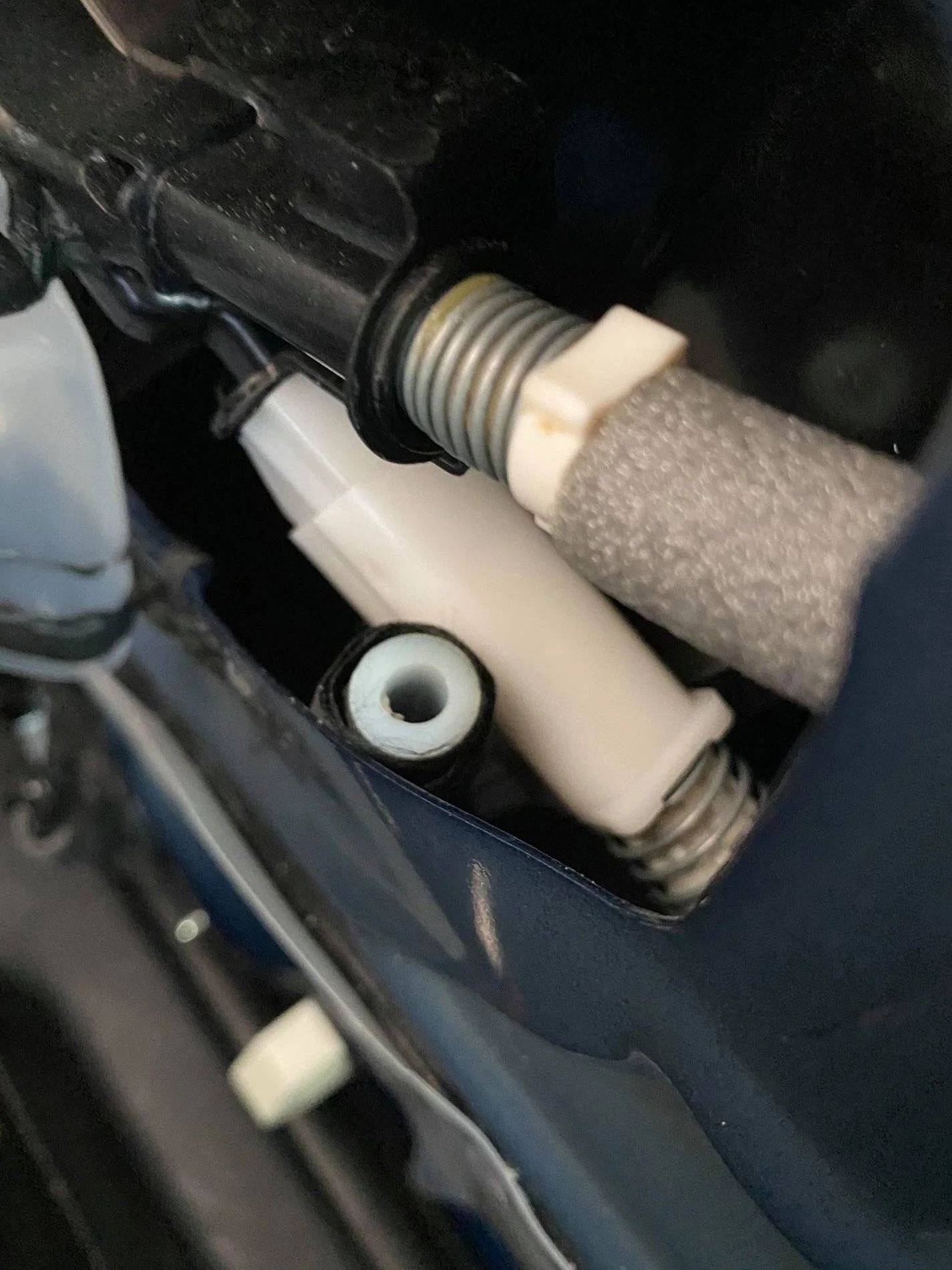

I just found my passenger door panel rattle. It had a very annoying buzz over bumps that would go on for about 1/4 of a second. You could hit the door panel and make it do this as well.
I took the door panel off and found that the cable housing going into the window regulator was rattling against itself. If i pushed on it, it would stop.
You can hear the noise in this video:
I was able to wedge a piece of 5/16" round plastic tubing between the door panel and the regulator housing wrapped in tesa tape to keep it from rattling. I wish there was a better fix for it, but it took care of the heavy buzzing you could hear in the original video.
I also removed my dash panel bezel (the one that houses the center vents) and completely wrapped the back side in tesa tape, especially where it meets the speaker bezel in the center to keep it from creaking (you can tell you have fixed it when you press on it and it no longer crackles).
And of course the c pillar buzz we all know. I did the same thing with that. Took about an hour worth of work - but so far so good.. completely quiet with the windows up.
