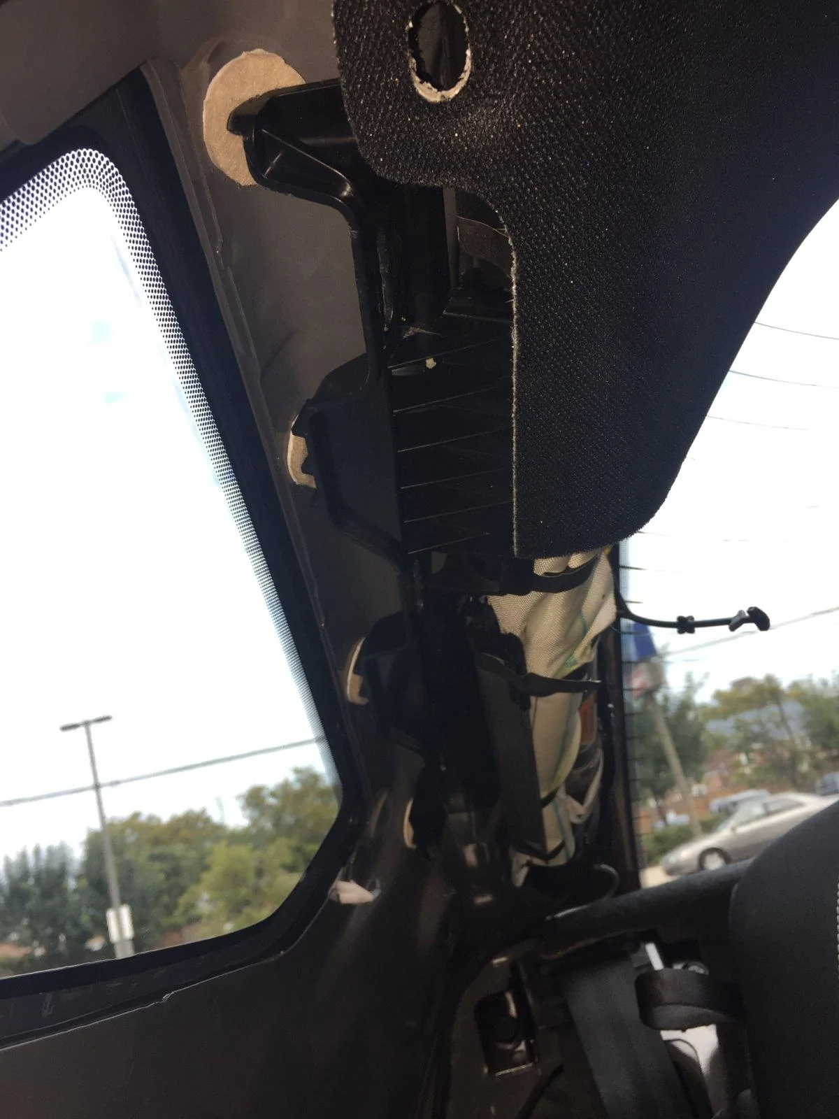

Fixed mine. Added felt furniture pads along the top and bottom of the rear window trim. I took a pic of the top but forgot to take one of the bottom fix. After dealing with this and other interior noises I’ve never seen an interior put together so sh!tty. First and last Ford I’ll ever own.

Did you have the same noise that whalesalad posted above in his video, because that's what i need to fix. Also, what do you mean by the bottom fix? T
Yes it was the same noise and I had it on both sides of the car. The bottom part of the plastic panel that surrounds that small window needs the same treatment where it runs under the window. You’ll know exactly what I’m talking about when you get that panel reinstalled. If you tap it hard enough it will start hitting the metal and making that rattle sound.

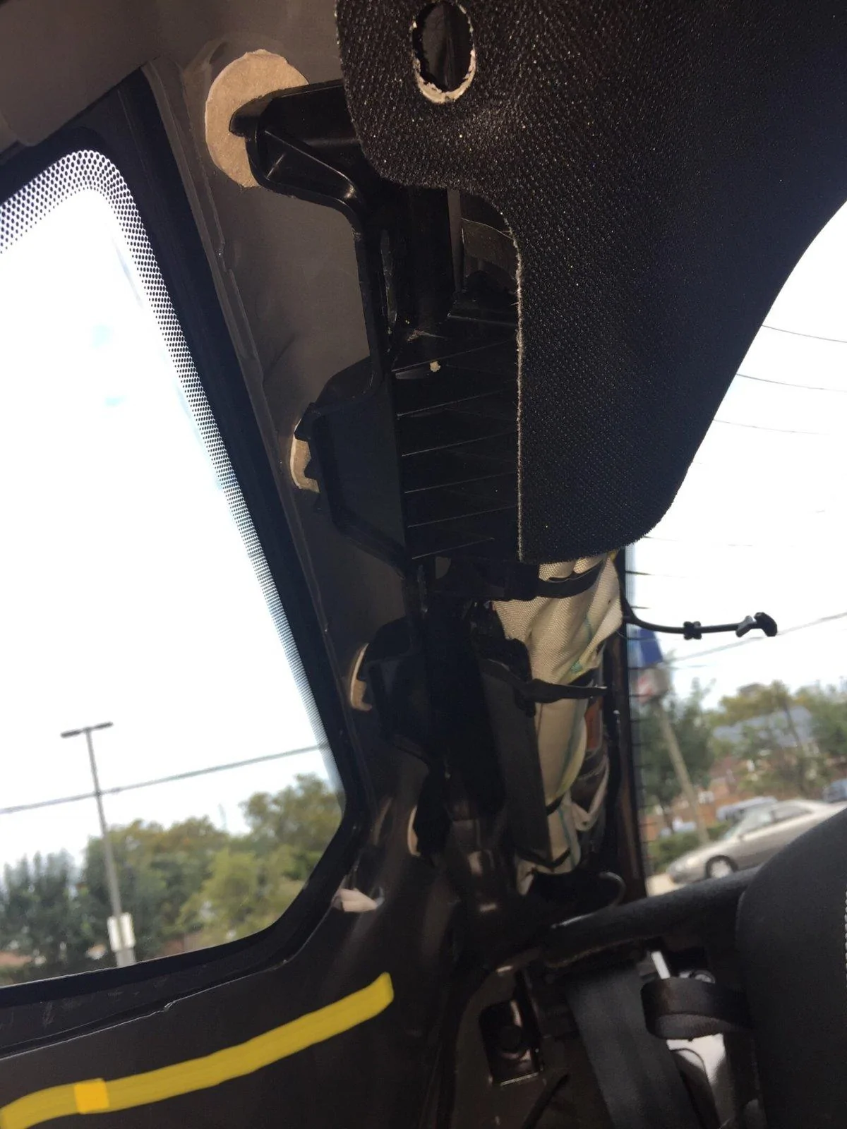

It’s going to be contacting where the yellow line is drawn
Thank you for your information! Is that fix still working, or did the sound come back? Also, what side and which way is this picture rotated, I was just confused about the angle of where the yellow line is drawn? Where the yellow line is drawn, did you take off the whole plastic underneath the small window? Did you just apply those pads alongside the bottom of the little window after taking off the interior piece, is it difficult to take off? I've taken off the c pillar multiple times, and not gotten anywhere, and I want to try this fix, but just want to do it right and make the noise go away.

Did this finally fix the noise? Was it the final solution? I have the same exact noise as you. After taking off the c pillar cover, I can tap on the quarter window upper trim piece and it makes the buzzing sound.
Like in this video:
I want to fix it once and for all, so I can move on:please:

Video's processing right now, but can you see anything wrong in this picture? ‍♂
