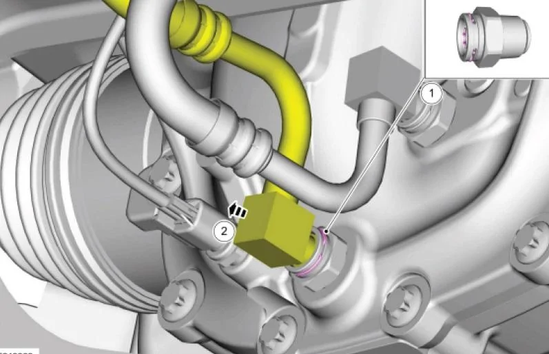

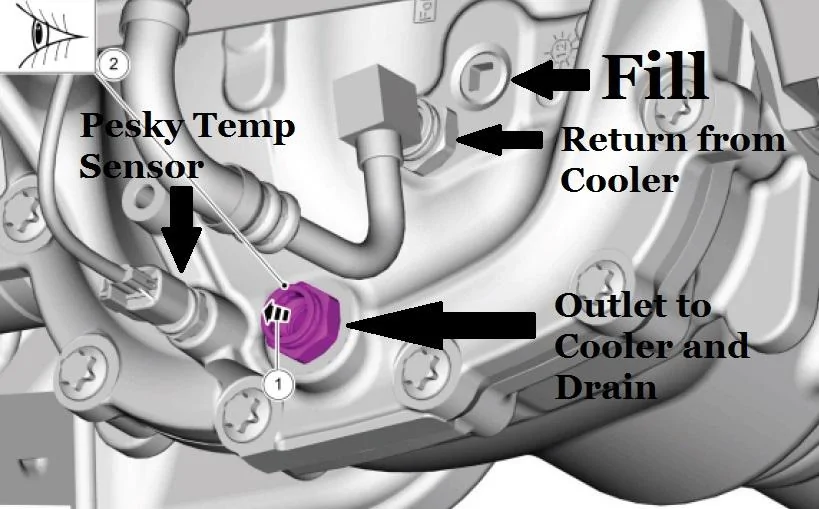

Shelby w/ TP (cooler) has different rear cover. It uses the drain plug for hot out line and that flat spot just lower left of fill plug is where the return line from the cooler goes. Why we have a rear cover on order :) Ford uses a quick disconnect to drain fluid out. The reason for three holes and not two (our original plan) is so when you fill the system you can cycle the pump and still have the plug out to check the level. Ford uses scan tool to force pump on during service, but relay is in BAT Dist Box so after reading the logic I think just turning the car on and taking the temp sensor plug off will trigger the pump...or light up the dash. I'm struggling with making it work on 15's and 16's but I think the 15's may be easier (because starting from scratch) 16's need to tap into stock temp sensor (piggy back it) and hopefully not throw the CAN into a fit lighting up the dash :tsk: The easy way it to just plumb a separate switch in our plumbing but I like the hard way better.
Those thinking about using the factory loop, couple things: It communicates over the CAN Bus (1 of 3-4) to the PCM, it actually varies the pump speed depending on temp and how fast or slow it is or isn't cooling down (PID Control) plus has fault detection built in. It's a slick system but only if the software is already in the car. You can use the factory stuff and just power the pump manually but you will need to either have it on a switched relay or sense temp to turn it on. We don't like it because it needs to be in free air and requires different under body aero to work.

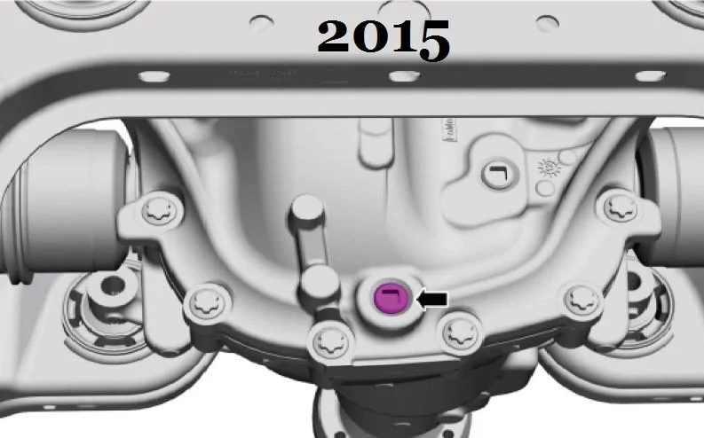

I'm still confused. :) The port I am pointing out is to the lower left of the fill port. I guess you may be talking about one even closer to the fill port? Do you have a picture of the GT350 cover by chance? If not, I may start browsing the GT350 forum when I get a chance. Either way, glad there are easy, cost effective solutions out there and look forward to what the community come up with.

Sorry Brent, I forgot to answer this, I was in a hotel room in ATL Monday when I saw this and didn't have "that" laptop. The pictures should illustrate what the differences are.
