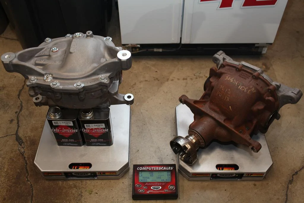

What about someone making an aluminum diff case?
this already exists, comes standard on the autos. i swapped one onto my car. also drops 23lbs over the iron case.
Am I understanding this correctly?
I can replace the differential cover with one from the Automatic GT.
The new cover will be aluminum vs. my cover which is iron.
Aluminum will not only help mitigate the overheating (greater thermal conductivity) but also allows for weight reduction..
If all of the above is true, why arent people getting in line to replace the Diff covers?
