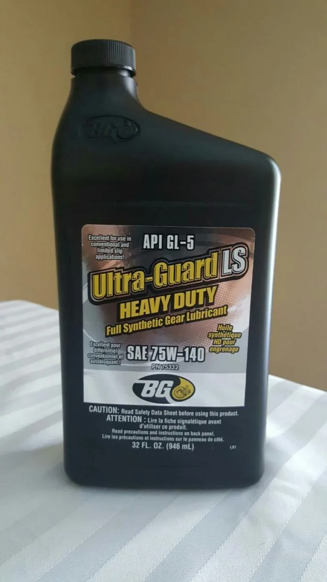

ULTRA GUARD LS 75W140 In Stock
Seeing how you guys seem to have better luck with the warning on track with thicker oil we decided to add it. It will be up this weekend on the website. We will have with the Combo kit as an option. We have it by the qt so if the Track Pack Shelby guys wanted to try it.
