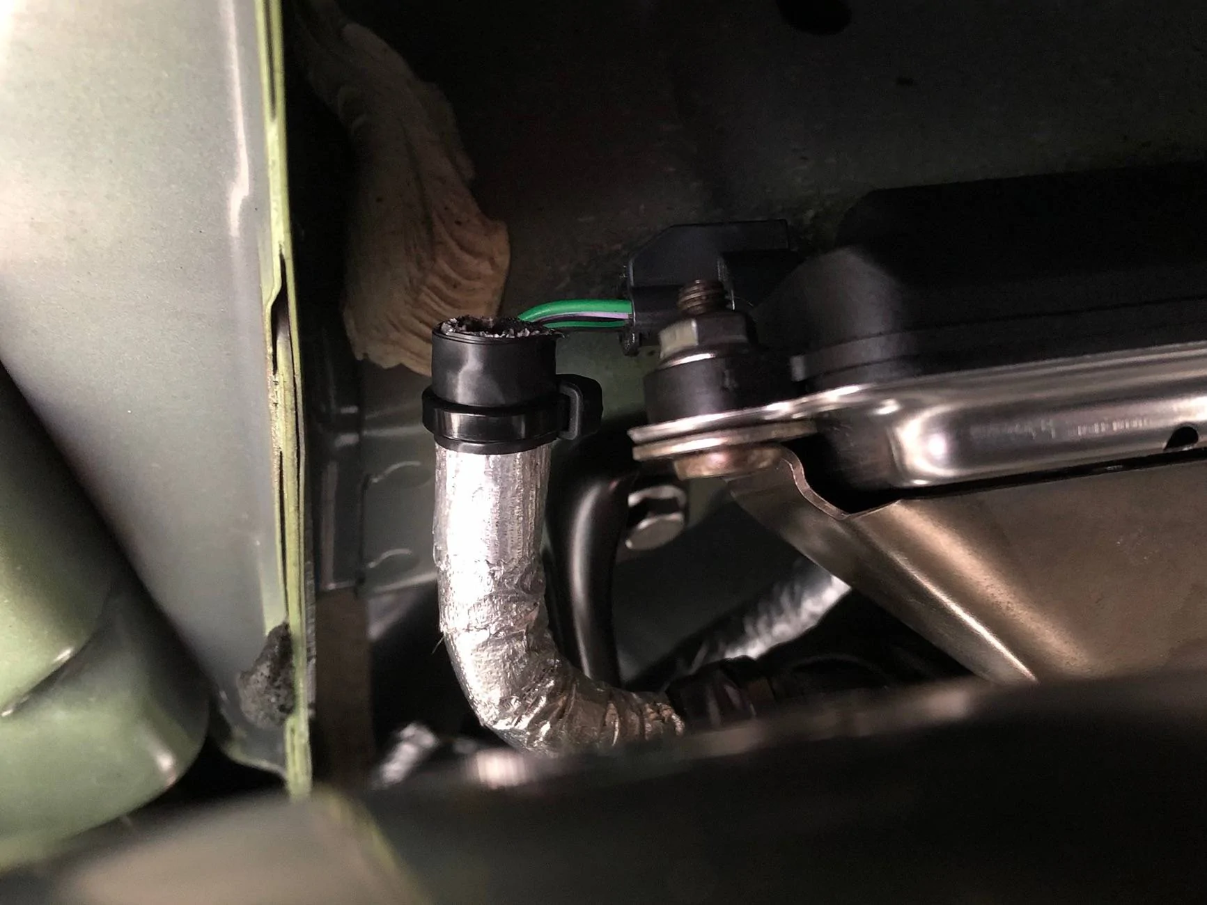

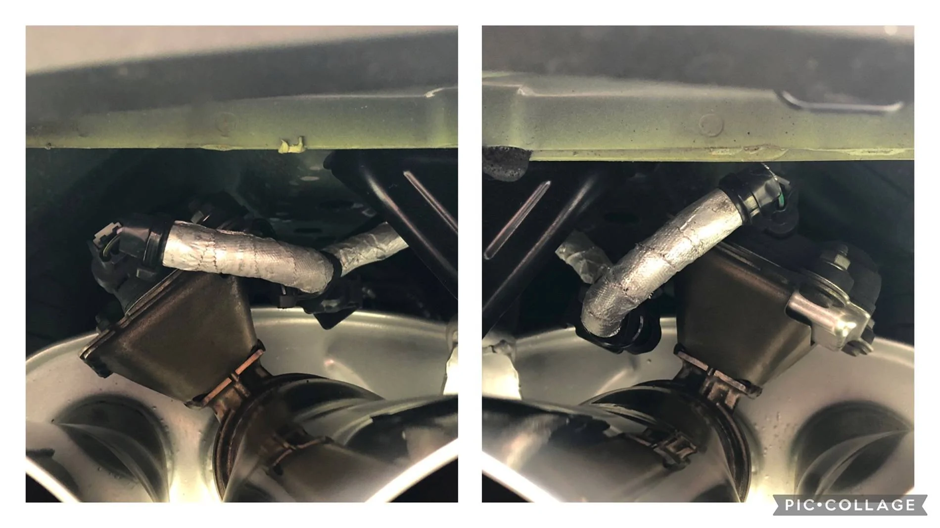

And also very topical, as I gave my tips a spring clean yesterday and snapped these photos :
This is an older photo I took showing the problem area from a different angle :
The above photo was taken after I had shortened the exhaust / increased the clearance to the frame by 16mm.
Bad fabrication tolerance + bad assembly tolerance + heat expansion + exhaust movement = damaged loom = exhaust mode selection message :frown:

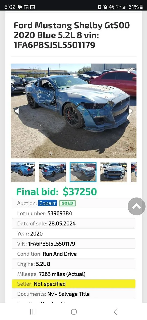

Mid 60’s with an extended warranty. It’ll sell, just a matter of time. Salvage 500’s bring mid 40’s pretty much trashed. Most don’t even make it to auction, the shop’s pick them up most of the time direct from the customer after being declared totalled after a basic tear down and inspection. Great way to buy a car if you have a shop.
To your point. This one got wrecked, sold for $37k, rebuilt, then listed for $69k with a rebuilt/salvage title and it sold shortly after. It's not longer available.
