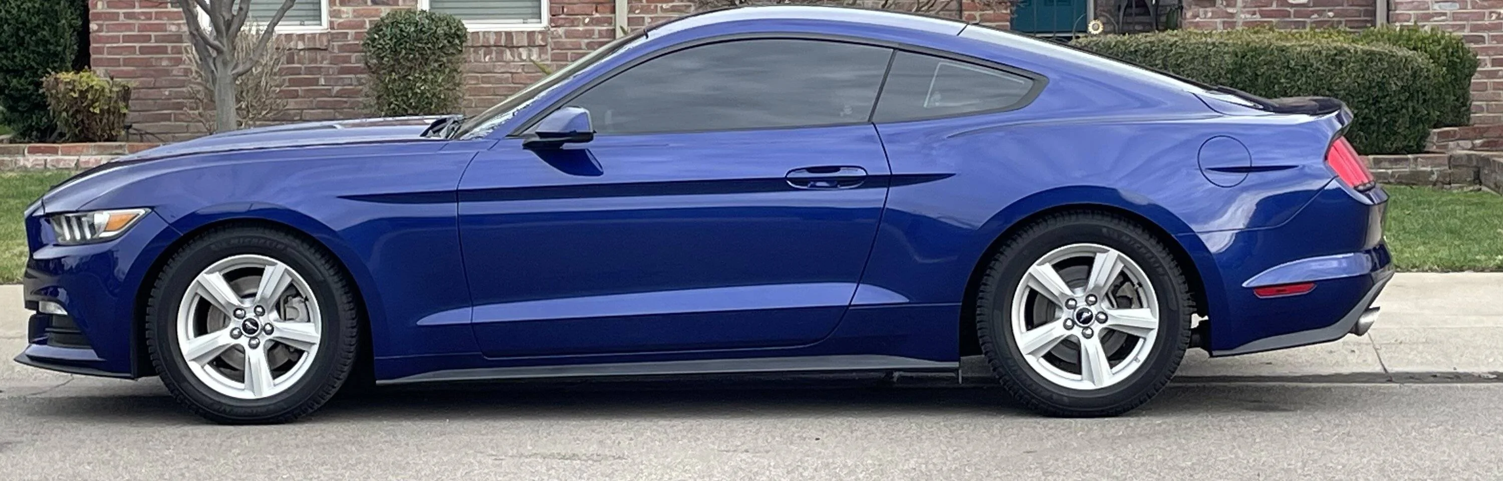

That’s a great stance! Are those 18” wheels or 19”? If you can post a pic of the alignment specs and let me know how you feel about everything!
Well, surprise for you, those are the stock 17”s that come on V6s 😂

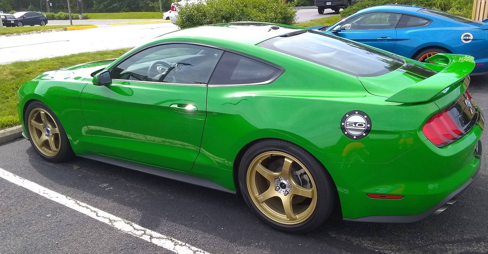

I think I’ve come to the conclusion that I’m gonna go with the bilstein b6’s with the steeda sport progressive springs.
Come up here to VA and I'll hand you my Steeda Sport Prog springs. Too much drop IMO and I had them on an Eco paired with their pro-Active shocks.

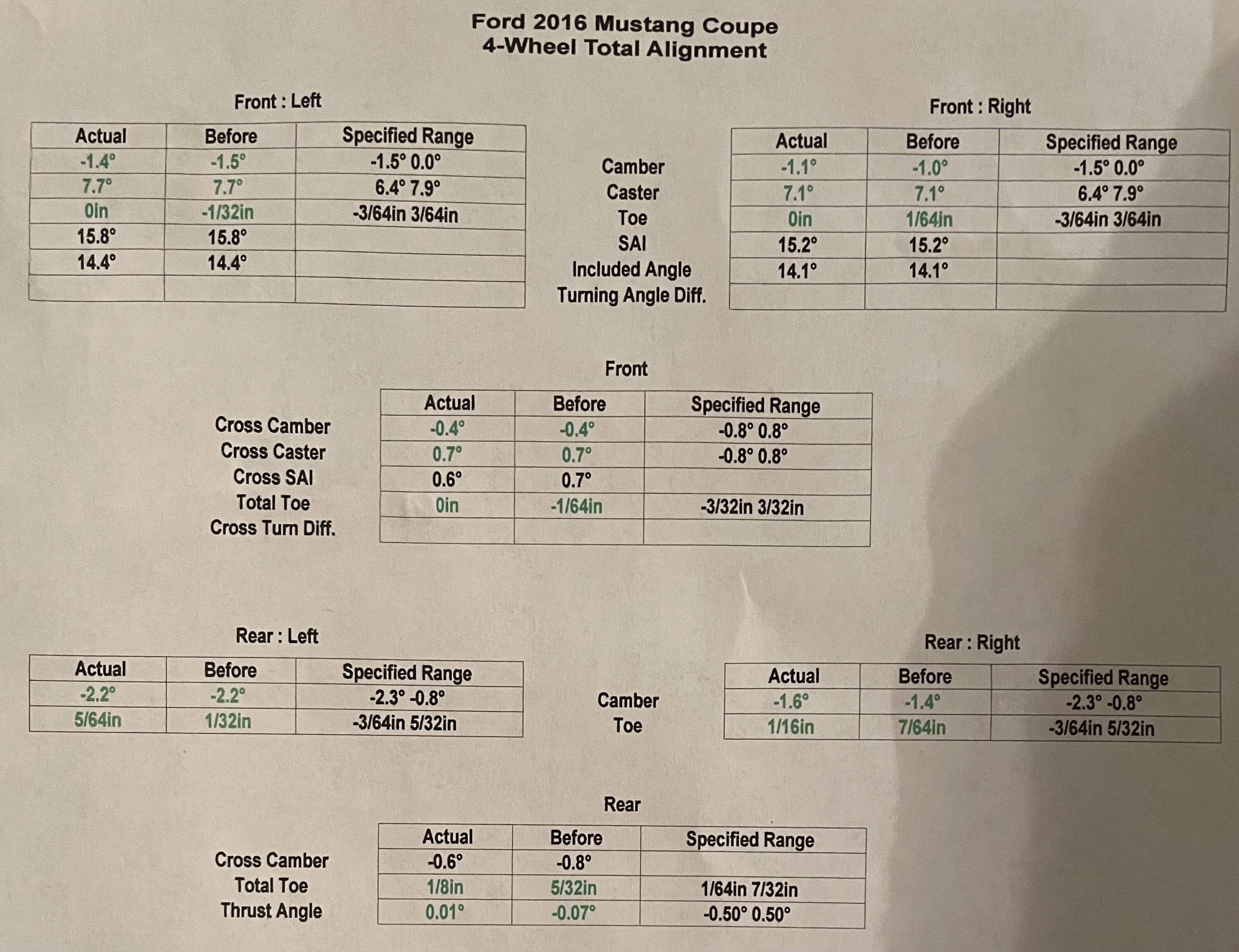

So I had a perfect install…
No longer will doubt myself in mechanics skill.
see my signature for what i installed yesterday

That’s great man! Thanks for the pic!
You betcha, anytime. Just remember numbers may likely be different for your heavier 5.0.
