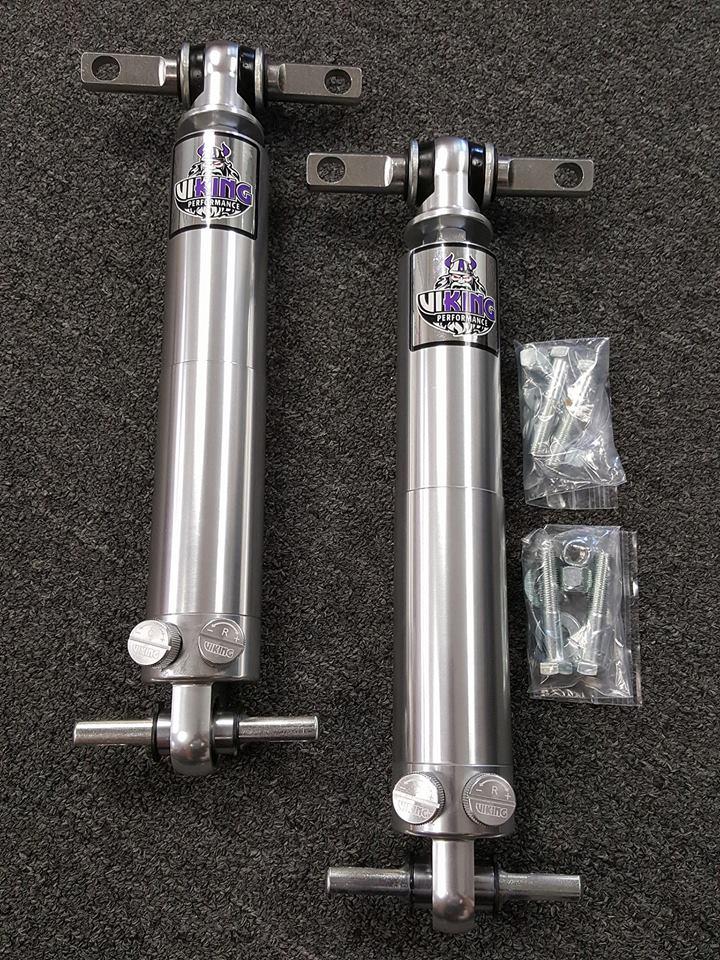

As for the Viking shocks, I only recommend TWO versions for street/strip type combos, regardless of the combination.
The B358AM is the tried and true, and what most people use. The B3010 is simply a different style that has an integrated upper shock mount (T-Bar) - see image below.
You can get either one, and they will perform the same. You don't really need the B3010 as long as you re-use your bump stops on the B358AM.

Ordering the B358AM’s tomorrow since beefcake has them for 10% off!
