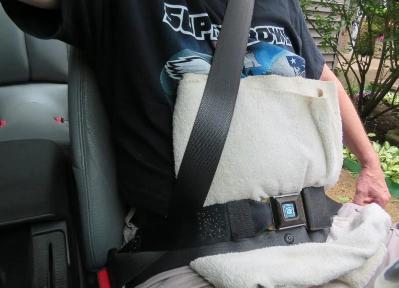

I've also found a supplemental non-slacking lap belt worn over the OE 3-point to be of help once you go beyond about 0.8 lateral g's. This one was re-purposed from a car I used to own and just loops around the seat. The towel is there for picture purposes only.
