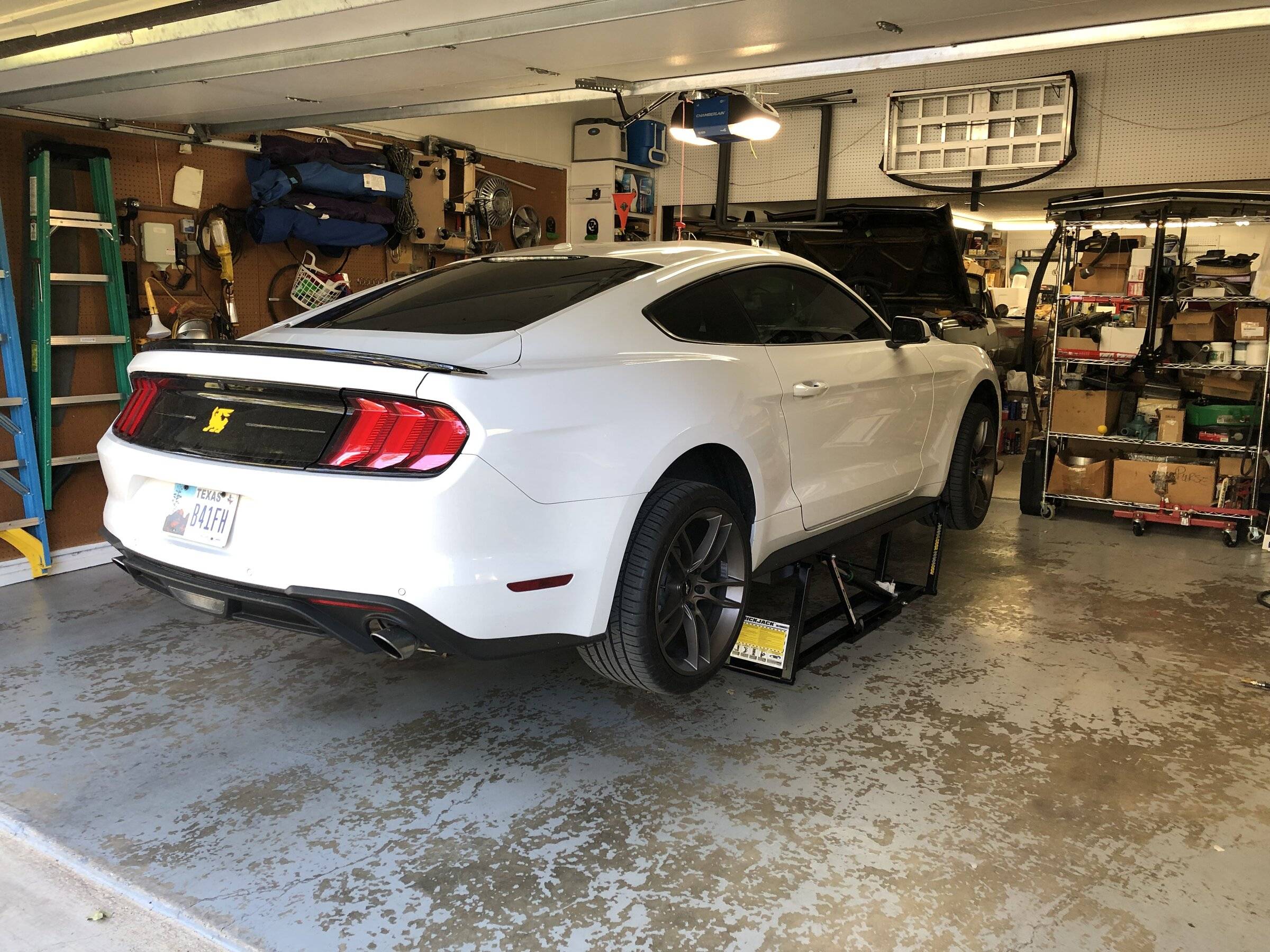

My ramps are the 8” tall ones and 56” long. Got a deal on em from Craigslist. Had to buy the ramp extension pieces. Mine has a lil add on lip and is on BMR drag springs. Just barely touches. If that helps

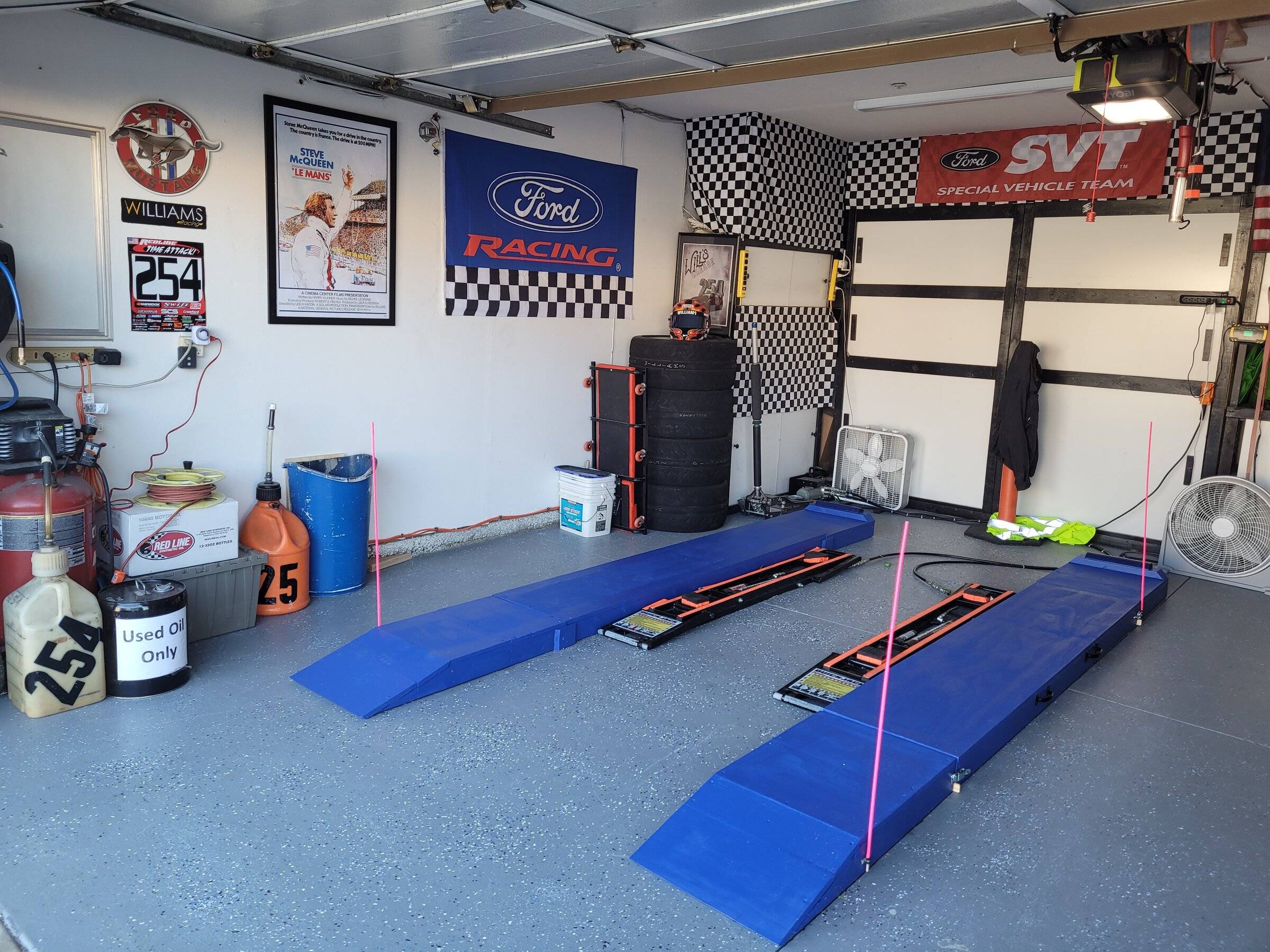

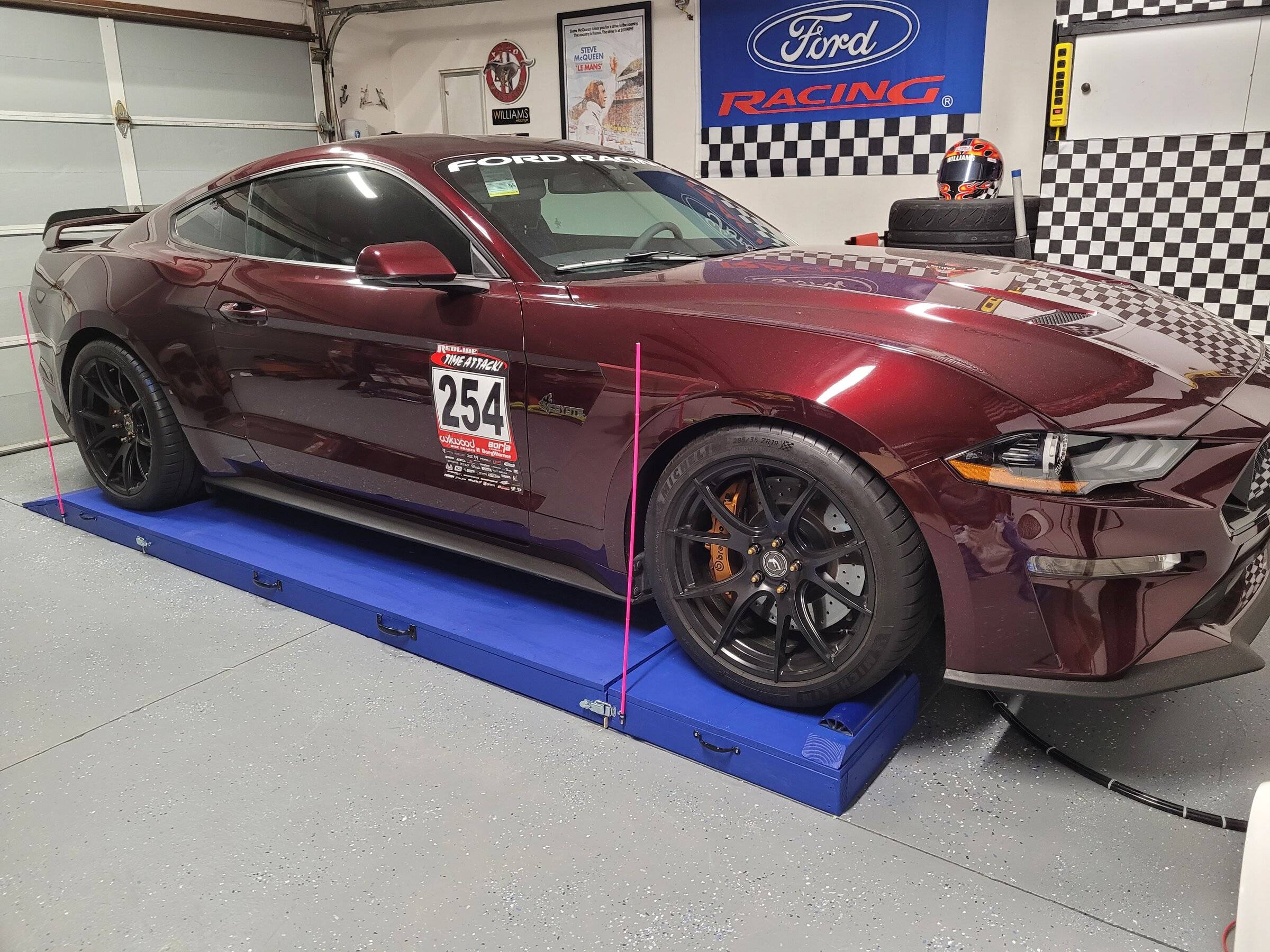

I built a set of modular full length ramps and i keep my quick jacks under them. The ramps are 5" tall and have a stop on them that stops the car in the perfect position. then I remove the center sections and slide the quick jacks into position and up she goes. when done I slide the QJ back toward the center replace the center sections and drive the car off. and At 5 inches tall I can crawl under the car and change the oil and I have even installed a x-pipe with out raising the car. The ramp system is made of 2x4's and 1' thk plywood.

Very nice. WISH I had the time for that.

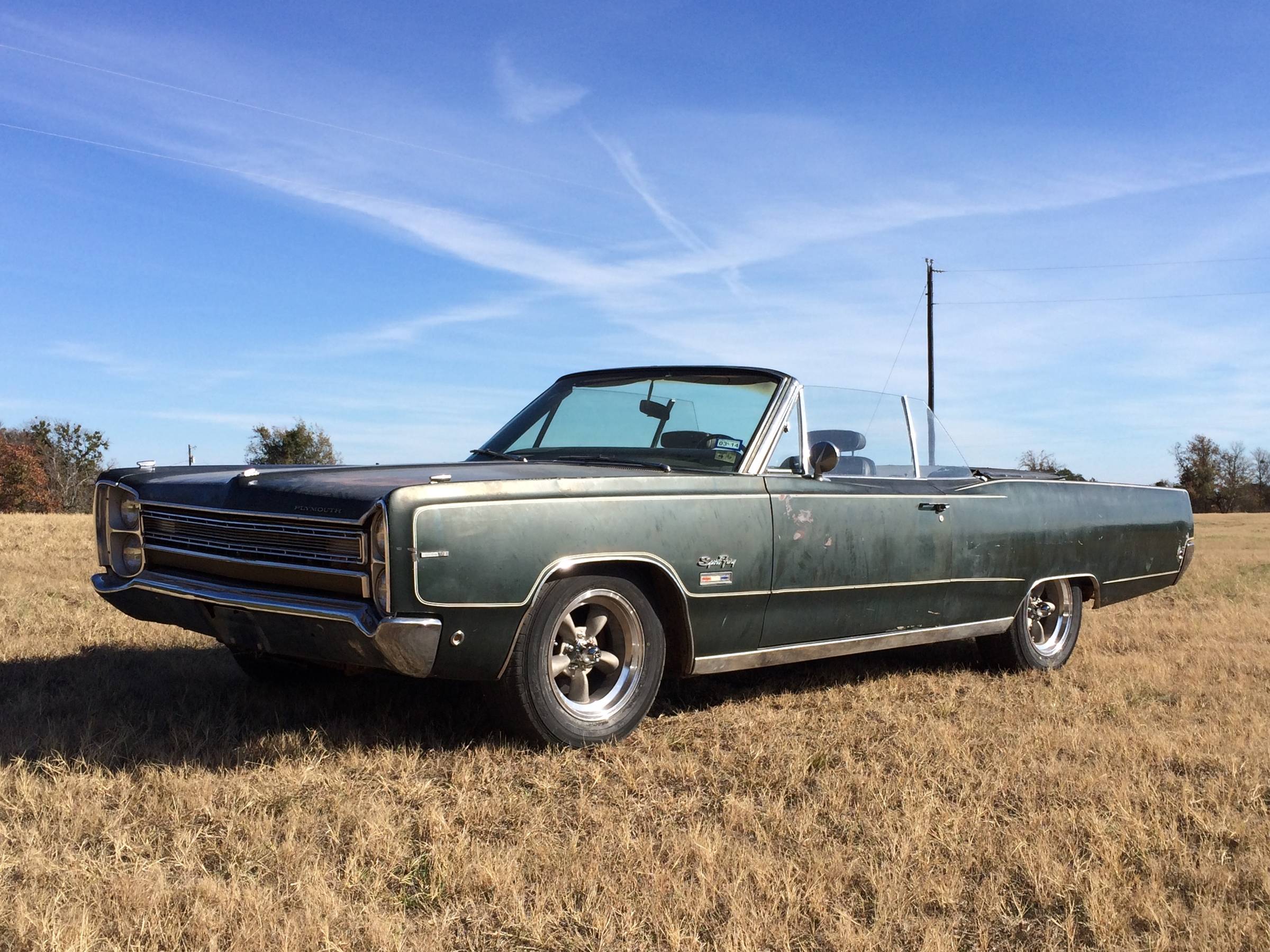

What is that in the background? K5 blazer?
My guess is a Lincoln.
Size guesses are about right - it's my 1968 Plymouth Sport Fury convertible, an original HP440 car. I'm slowly undoing a bunch of work I had done by a shop to get that project off high center. Lesson learned, do all the work myself so I know it's done right. I want to be driving her by fall so I can enjoy some top-down Texas weather... she's been off the road for 4 years now.

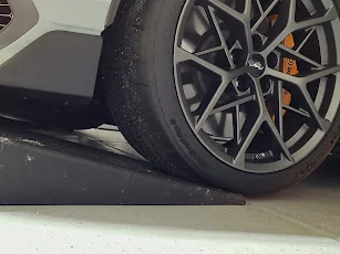

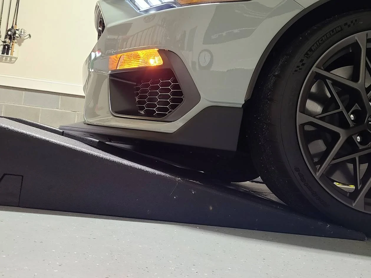

I have the 67" Race Ramps and I believe it will scrape by the looks of the photo I took.
[/QUOT
thanks for the pics. Yeah my lower splitter would definitely scrape on the 67”. Could always get the extenders and the. I would fit.
