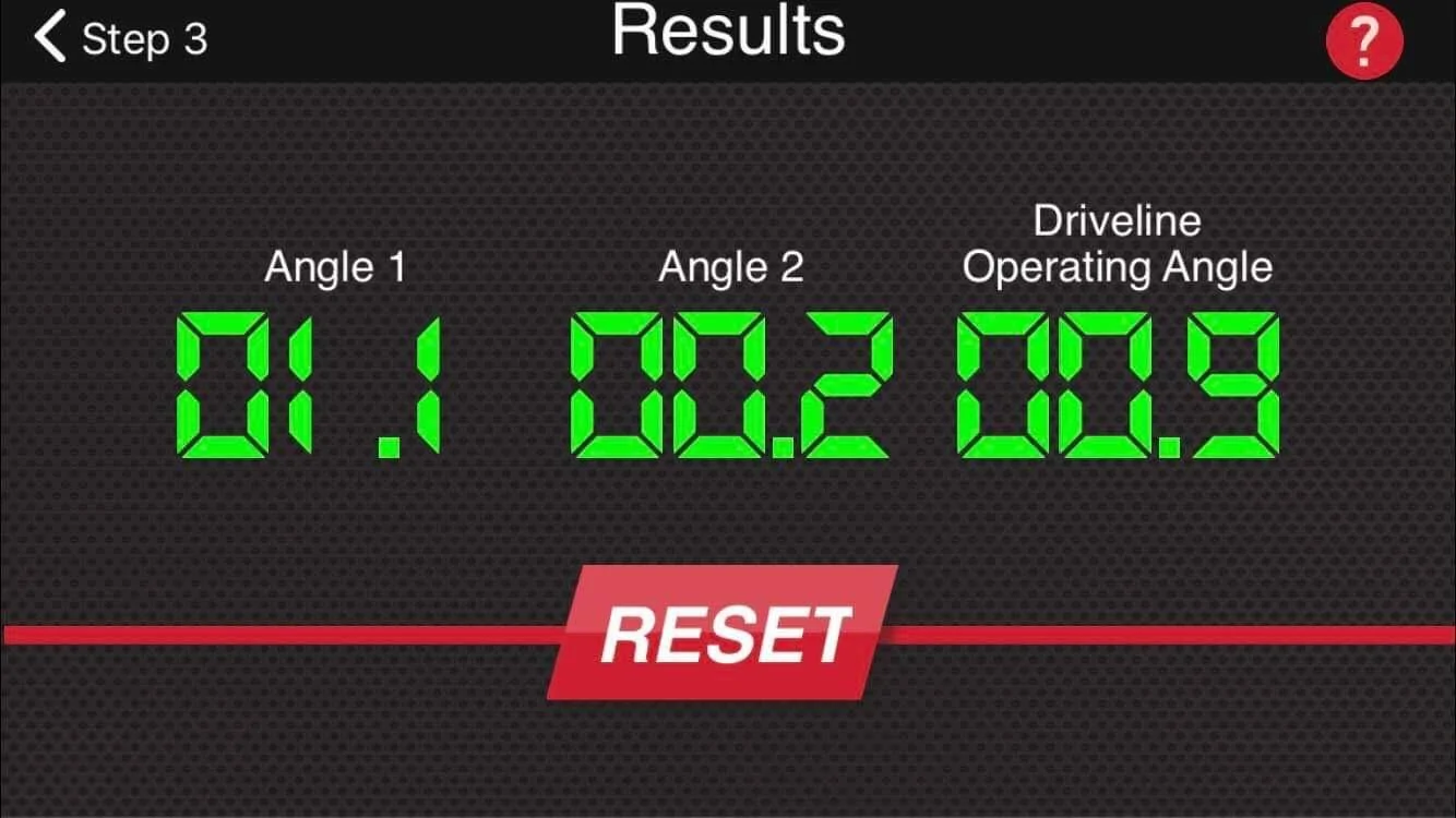

@Epiphany
I had a bit of a play with my driveline angles prior to installing my QA1 shaft.
Ended up with this, which seems to tick all the boxes, in terms of “more than 0.5*, less than 3*”
Angle 1 is the U joint, angle 2 is the CV.
Thoughts?
