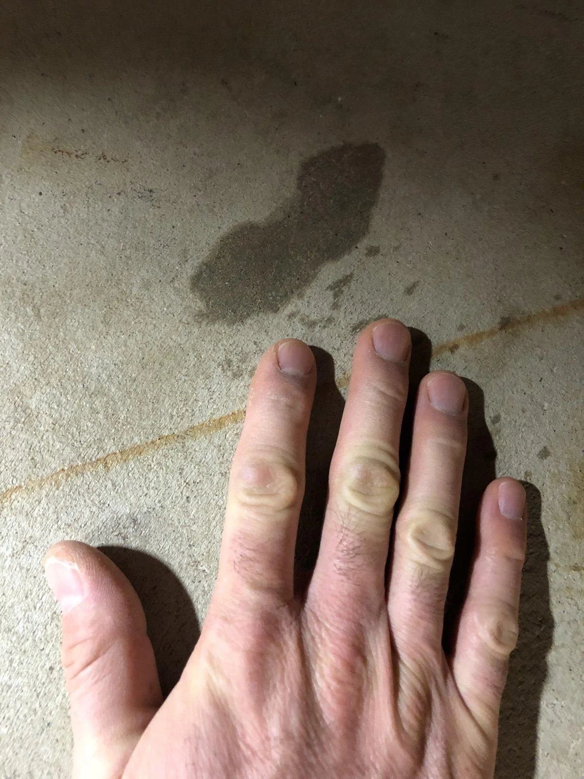

Just as the title says.

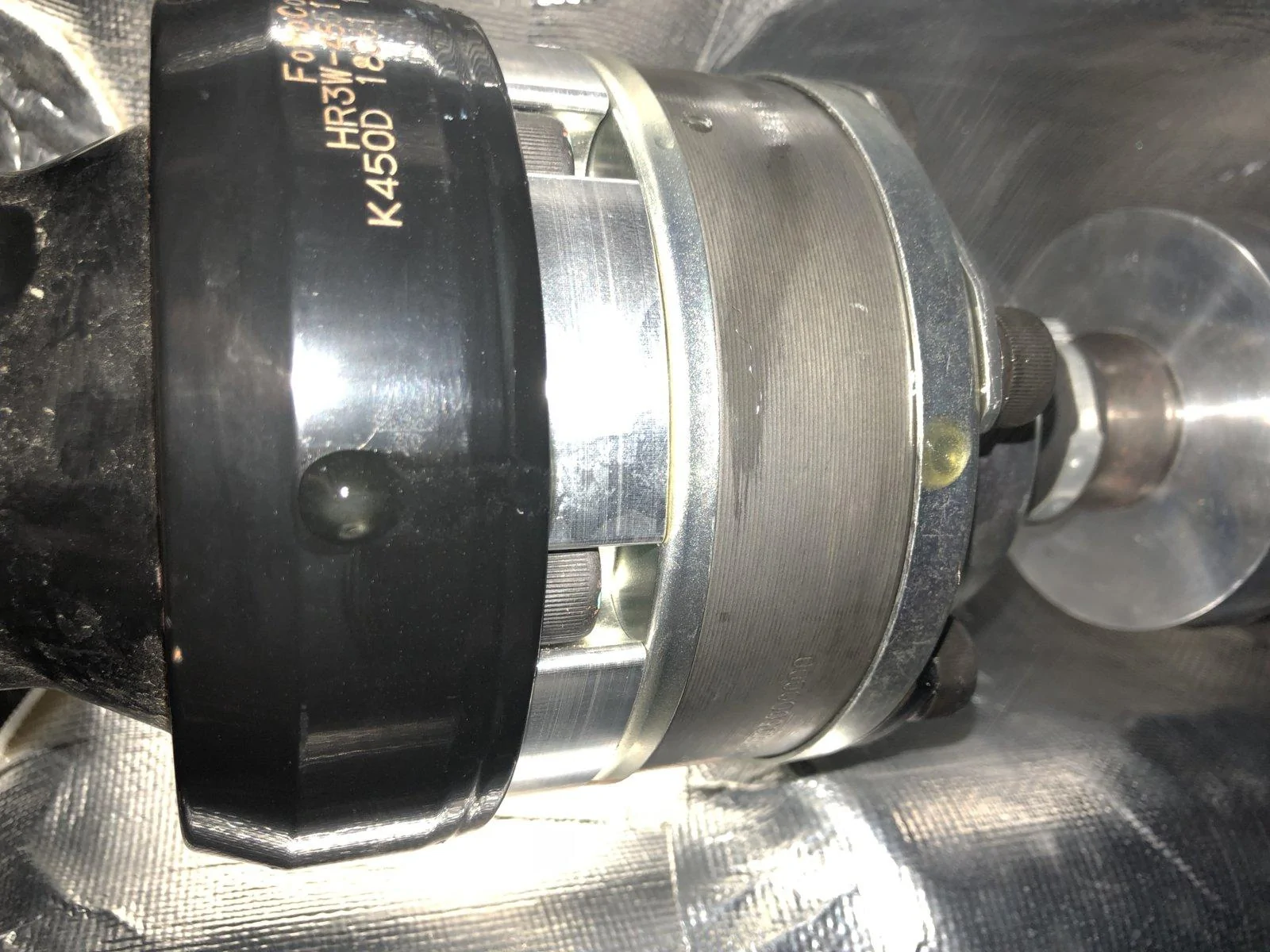

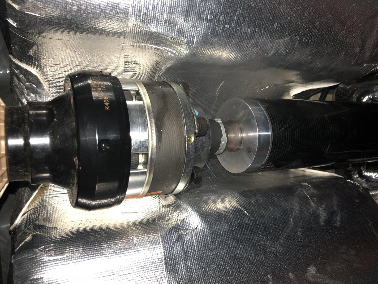

I’ve installed a QA1 SFI driveshaft on my 18 R in August and literally put Zero miles on it since and when I went under the car today to do some things I noticed oil drippings on the floor and oil hanging from the pinions CV joint.
Has anyone else noticed this?
I’m calling QA1 tomorrow.
Floor oil stain pic is reference to my hand.

The differential pinion seal is dry. It’s coming directly from the QA1 cv joint

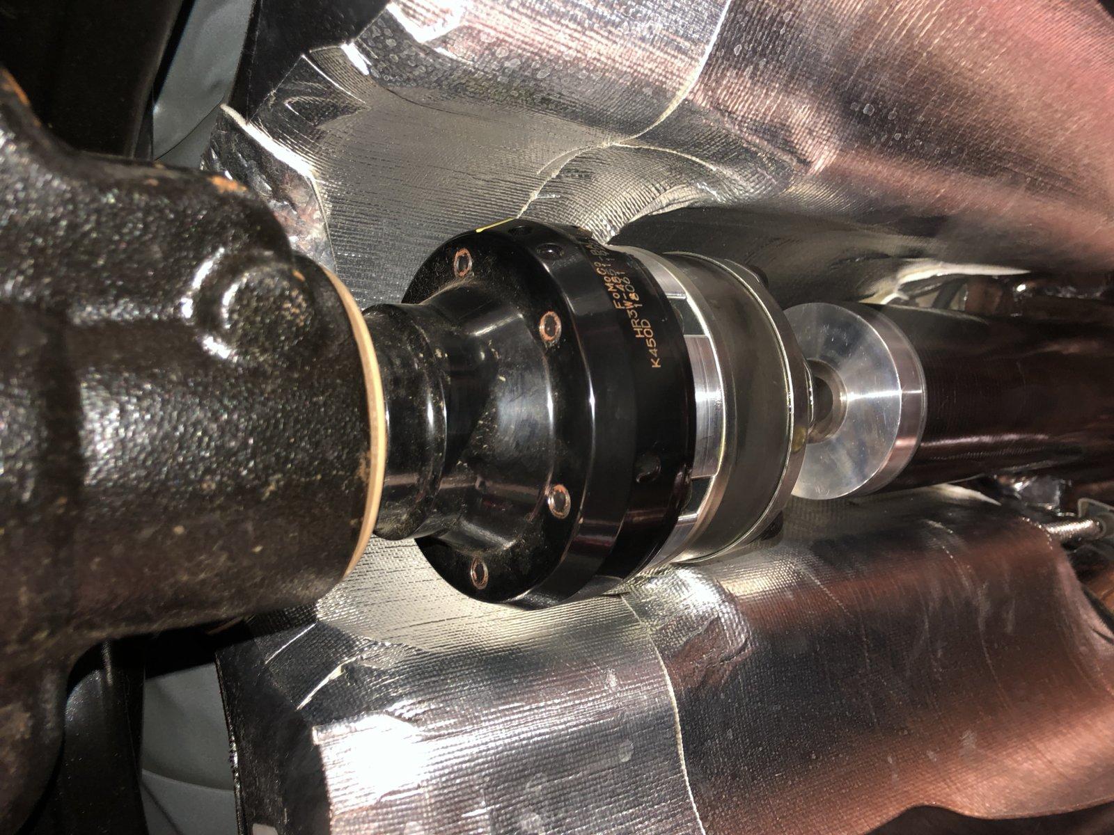

I had a leak that looked an awful lot like that once.
Ended up being rear end oil getting past the pinion nut.
If the pinion nut doesn't seal off the end of the pinion, oil can get past between the splines/threads of the pinion and rear end yoke.
Is that a stock pinion yoke ?

It’s not leaking at the pinion nut or companion flange. Its all dry on the nut and flange. The oem shaft was bone dry.
It’s wet on the top of the cv joint and running down to the bottom just as seen in the pictures I posted.

Vallo noted exactly what I was thinking. The pinion flange looks coated and I haven't seen that before. That would imply it has been changed, if so I'd suspect it migrating past the pinion nut. What is weird is that it is so far forward from the nut though and on top like you stated. Most interestingly is the fact that the CV joint grease is fairly viscous and not at all what looks to be dripping.
Did you lubricate the threads to the cv joint bolts when installing?
