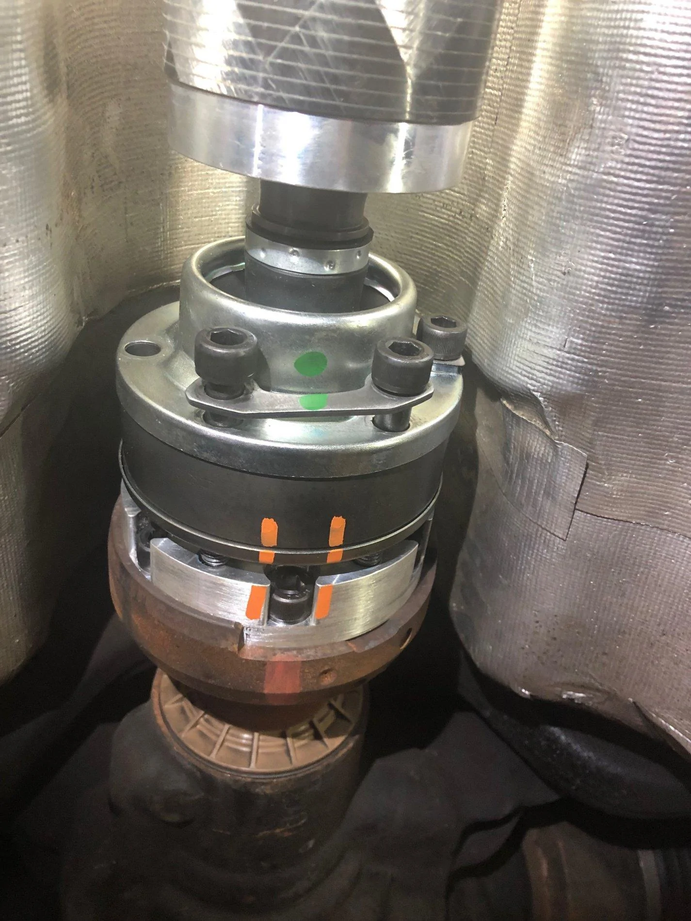

I have done the install and everything went perfect except the color coding of the rear differential flange section. See my picture. Basically my driveshaft had mismatching colors. The way it came is exactly how I installed it. Basically the orange lines that align the adapter to the driveshaft were on the "green" weight part of the driveshaft. There was no way to arrange it such that orange lines would end up in the "orange weight" part of the driveshaft AND also align with the adapter. I thought long and hard and I decided to install it as it came. Which is basically the weight colors match to the dots. And the orange lines line up but orange lines are NOT on the orange dot part of the driveshaft.
I did 40 miles of driving and did not notice any issues.

Ok regarding the drive:
- There is much LESS NVH with the QA1 than I had with the stock drive shaft. Noticeable improvement.
- The initial “thud” and “clunk” you hear when letting go off the clutch is gone. Sloppiness of the driveline is gone.
- Car does accelerate smoother. Feels a lot more like a proper high end sports car. For example when I got my ZR1, the first thing I noticed was how there was no sloppiness between clutch gas and acceleration. GT350 feels like that now.
But I am concerned about why my colors were off like that. I also dont know if installing it the way i did was correct but I think it was.

As i said, there is no vibration at any speed in fact NVH has noticeably decreased compared to the stock unit so i will take that as a positive sign.
One issue I had during the install is that there was such a small amount of clearance on the differential side to tighten the hex bolts on the driveshaft (not the adapter). I had to try 3 different 10mm hex tips to find one that will fit there. Even using 2 different kinds of swivel adapters did not help. The issue is driveshaft is too thick and the bolts end up staying sort of recessed. So the wrench does not clear.
My advice is find the shortest hex socket you can find.
Also for those of you who did this on jackstands, how the hell did you manage to put 85 ft lbs on transmission hex bolts laying down there? You need a big 1/2” torque wrench for this and need leverage to do it.
I did this on my 4 post lift and I used a rolling scissor jack to lift the back of the car to rotate the driveshaft.
